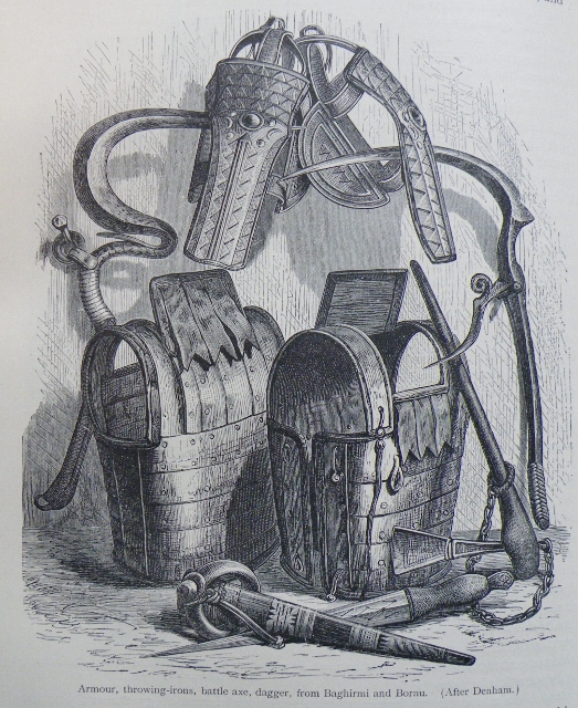

I just realized I have an incredibly clear image of one of these cuirass being worn from 1905 I never posted. It is from northern Cameroon.

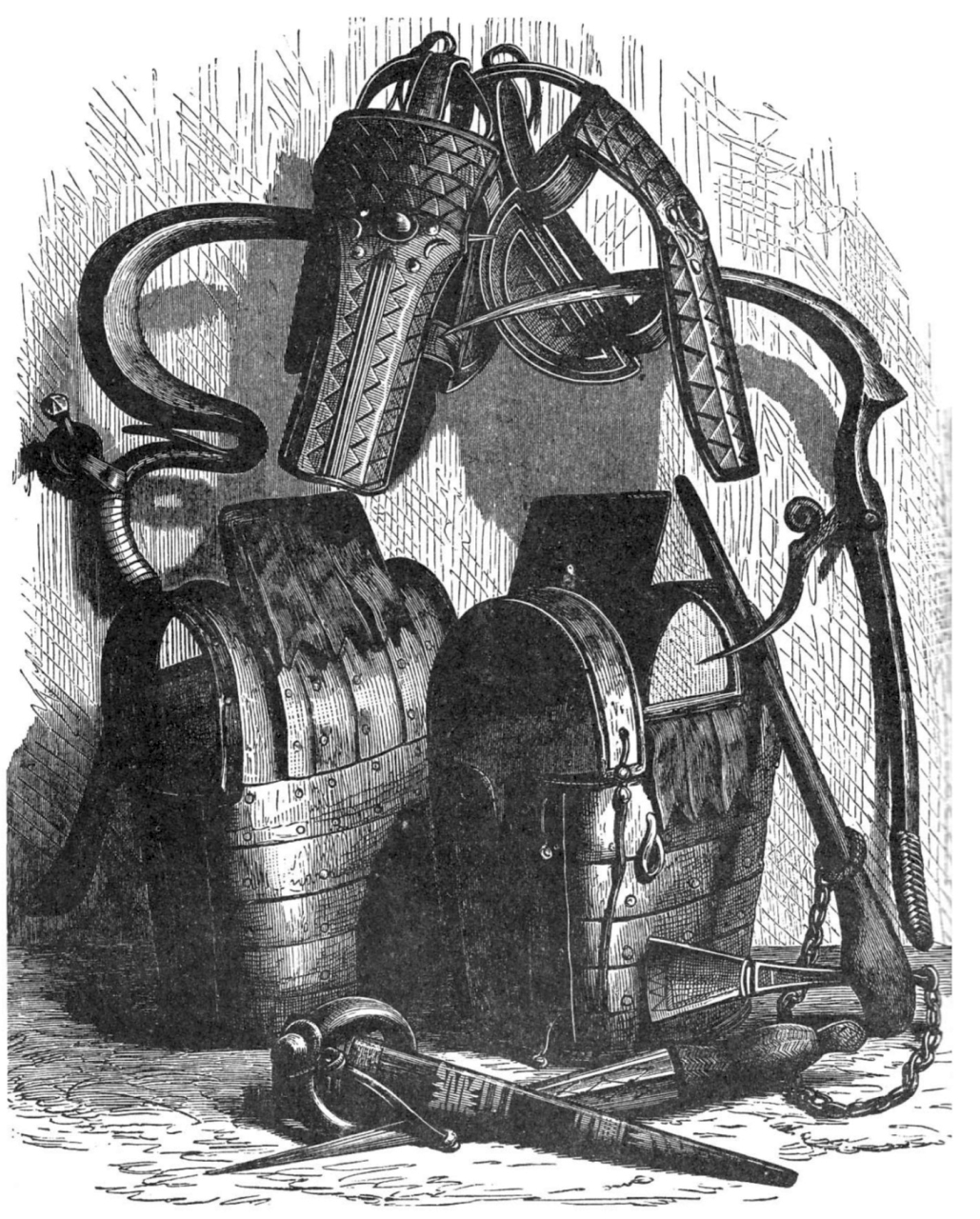

From "History of Mankind" by F. Ratzel 1898.
Thanks! Its a very similar sketch to the Denham one. The high neck protector I think was leather, I haven't seen an extant example with one, however mine clearly has holes where it could be attached.

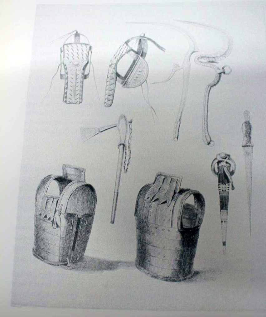

A bit larger image, no text though.

Posts: 1,720
Its based from the Denham sketch, including all the objects pictured. Friend was kind enough to send me a quick pic. Looks like the later book simply copied and changed up the pose a bit.
