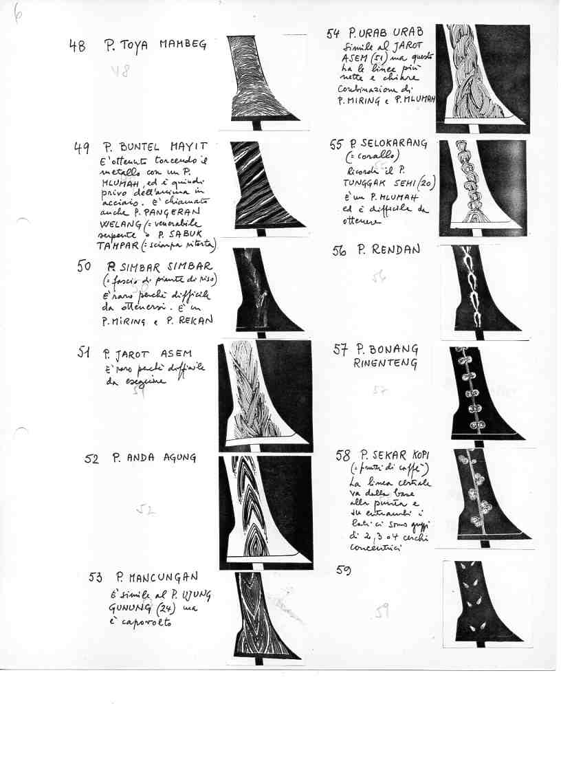

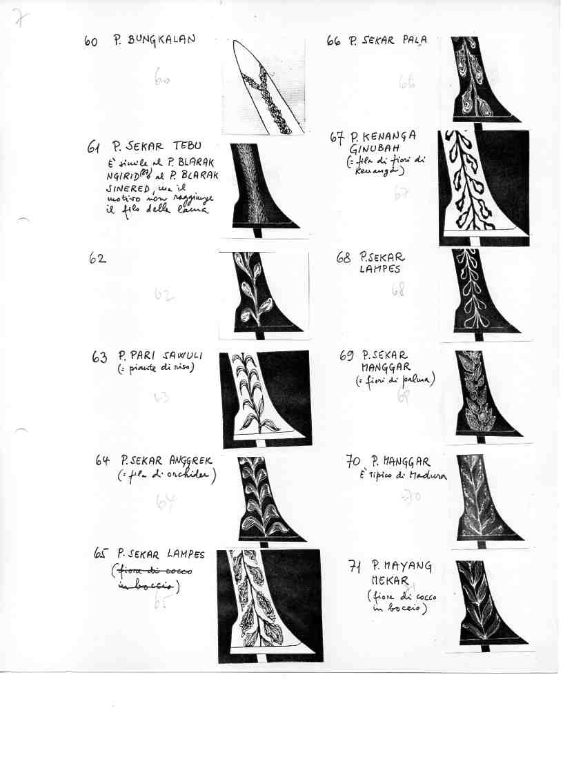

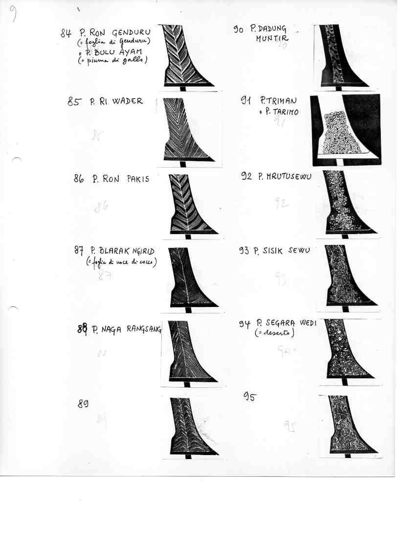

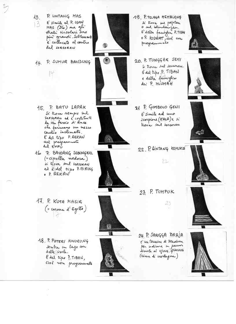

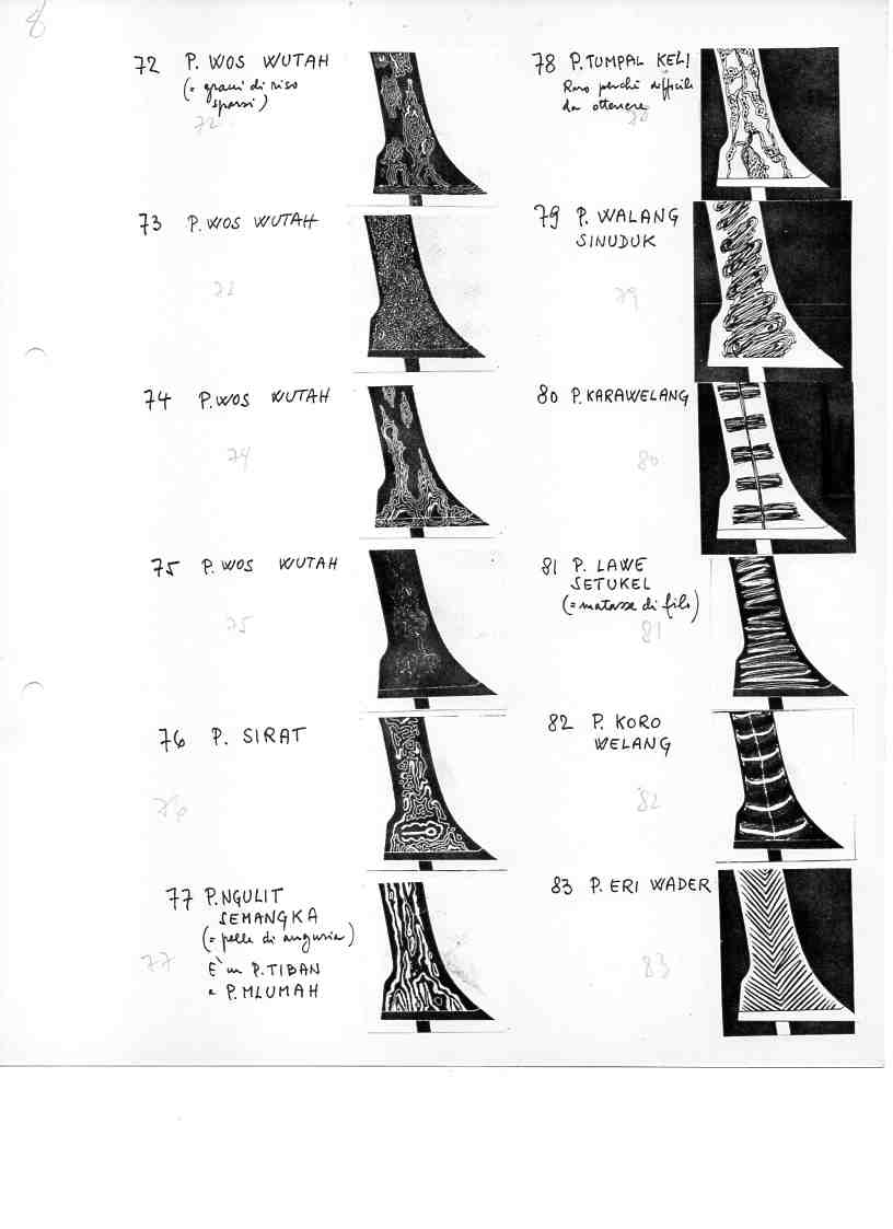

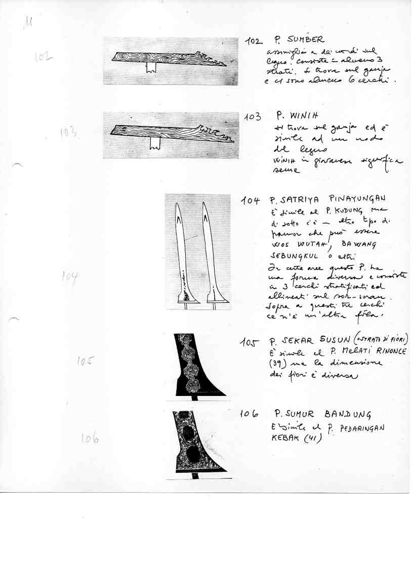

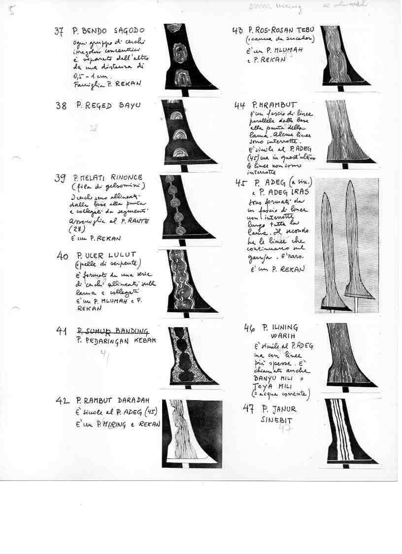

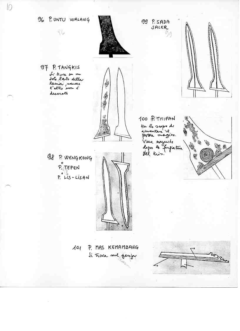

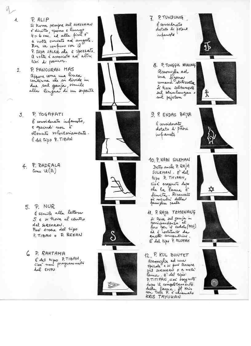

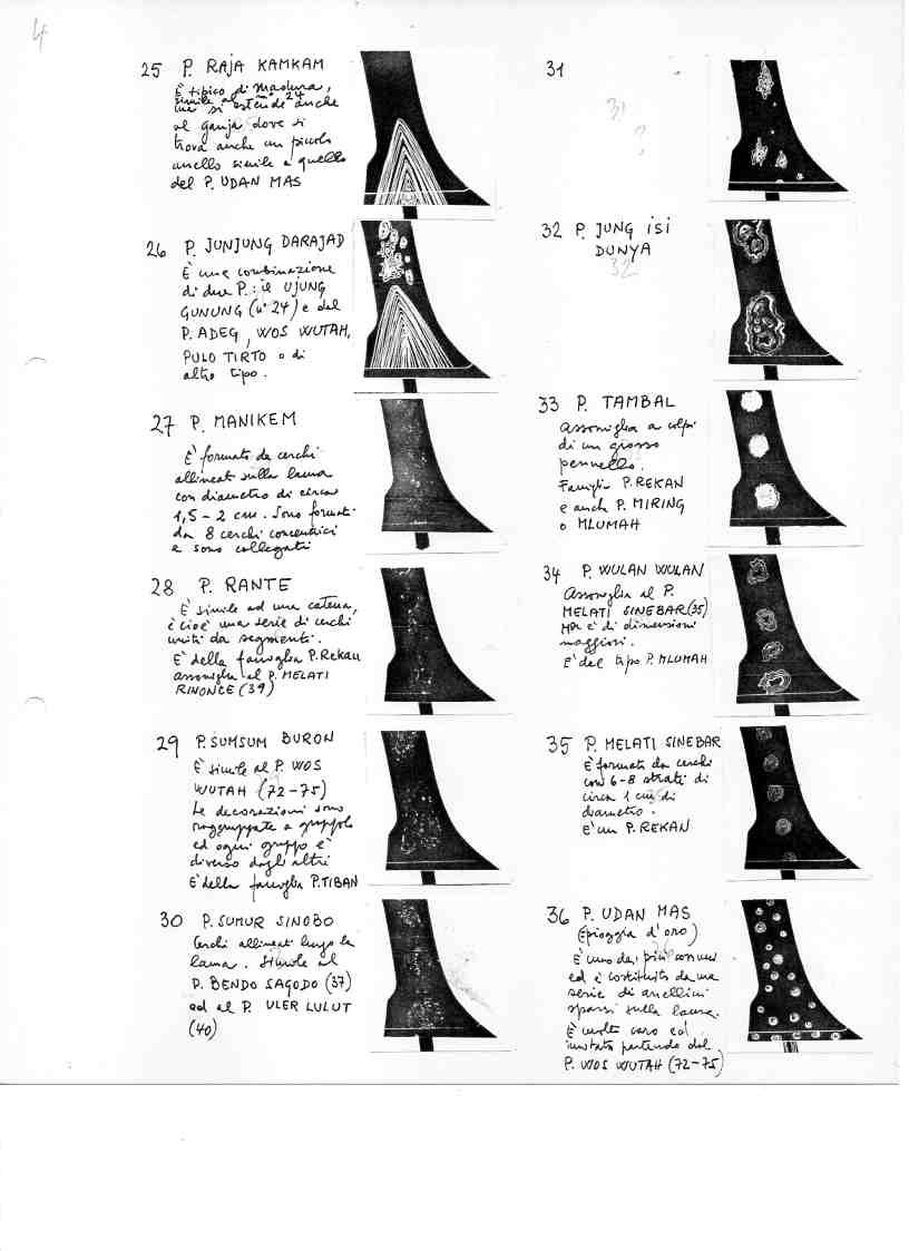

Far from being exaustive, I took the enclosed designs of various pamors from the "Ensiklopedi". My intention was to make a sort of handbook to identify pamor designs. The list is incomplete and is missing important pamors (mainly the newest ones). Moreover some designs are very badly reproduced in the book itself.
A great work would be to prepare a file for each pamor as simplified in the drawings and join the largest possible number of photo of real kerises with the same pamor.
My work is included.
GIO is offline   Reply With Quote
