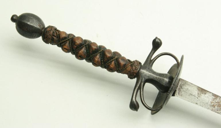

I would like to have opinion about this dagger . It look like to be from the XVI Century but I 'm not expert in those weapons..
I seems it could be used as a tool to repair armor or flintlock because of the small hammer and a kind of screwdriver you could see each side from the guard.
What do you think about this explanation ?
I hope that somebody already seen similar dagger.
Any comment will be welcome.

Hi Cerjak,
It seems to have began life as a rapier and been modified to a dagger.
Interesting piece, I agree about the tool mod's on the guard. Almost like a modern survival knife!

Do you think it could be from the16 th century ?
Kind regards

Originally Posted by Cerjak
Hi Atlantia
Many Thank for your comment .
Kind regards
Cerjak
I'd have thought it was 17thC, but that's just my guess.
I've been thinking about the 'turnscrew' and 'hammer' and I wondered if it might be for maintaining a musket?
It's a very interesting item. I am suprised there hasn't been more comments.
Something of the rapier family. Google some images and you can see the various elements represented.
I haven't found them all in one but there are so many variations.
I'd guess some transitional rapier.
Obviously your's had a knuckle bow.

Originally Posted by Atlantia
... I've been thinking about the 'turnscrew' and 'hammer' and I wondered if it might be for maintaining a musket?...
Like those seen in plug bayonets, so called "flint-knapper" ...
(The plug bayonet by R. D. C. Evans)
Hi Nando,
Absolutely. Excellent pictoral examples!
I'd have thought it was 17thC, but that's just my guess...
Oh, it sure is an early piece; and modified in the period ... perhaps from a broken blade, to be used as a belt weapon/tool by the the local (or) field smith.
... Obviously your's had a knuckle bow.
Are you referring to that spot in the pommel ? No too low for a knuckle guard fixation ?
Perhaps Jean-Luc can tell us if it really is a hole for a bar penetration ...
Hi Nando,
There is a hole in the pommel which I can't see being for anything but a bar/knuckle-bow.
The position is OK, not too low.
Fernando,
I 'm agree the idea that it was a rapier as previously said by Atlantia
The dagger should be with me for the end of this week I Hope WEe never know with the post office( isn't it Fernando)
So ASAP I will post new pics .
