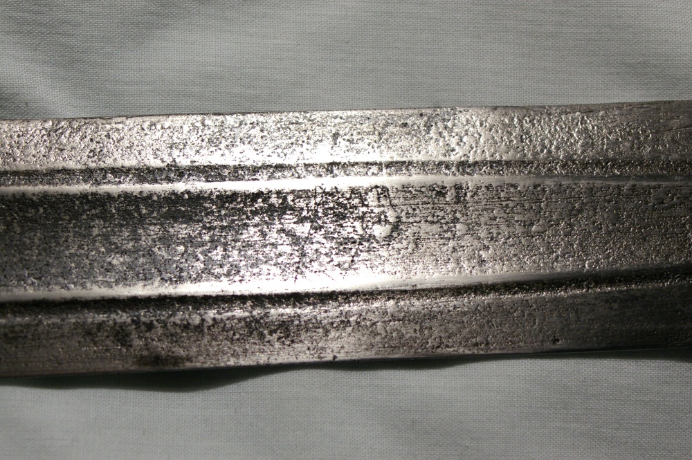

Default Two takoubas - photos of the blade from Ghat
photos

Nice! I like the symbols on the blade, is that the lion of Judah?

Posts: 847
I do not think Lion of Judah. Just a Lion.
Lion of Judah, as a symbol of Abyssinia, is standing and keeping flag

Hi Martin,
Would it be possible to see photos of the entire sword?
Interesting markings, I have seen similar although less well done. One sword I used to own had a similarly styled lion.
Are the star and lion on the same sword or two different swords (I'm just a little confused from the thread title )

Hi Iain
This thread is sequel to previous thread the name of which is "Two takoubas".
Explanation:
You can only post max 12 photos. I ewanted to post 15. So I started thread with 12 and added the rest one minute later, but I was forced to start another thread.
The first thread with 12 photos is showing two swords - one from Ghat and one from Ubari. I wanted to emphasise sequence of the threads - maybe I did nit choose the right name of this second thread.
On the photos here you can see two sides of one sword which is comming from Ghat. The entire sword you can see in previous thread.

Hi Martin, thanks I was just a little confused.
Both are nice swords. The mounts I guess are not so old but the blade with single fuller looks like old trade blade to me. I'm not sure if the marks are European but they look nicely engraved and not done recently. I would not be surprised if they are original. Hopefully some others like Jim or Lee who are much more well researched and experienced with marks can comment.

On these blades which entered North Africa through various entrepots into the caravan networks, they were often first brought into merchants in these centers. It is unclear exactly where many of the extant markings on these various blades were applied. However, what is clear is that they were meant to imitate known European trade markings which had often gained various talismanic and imbued power via quality in native interpretation.
The couchant lion symbol was a trademark used by C.Lutters and Co. of Solingen (Bezdek, p.147) from c.1840-modern. While uncertain how what volume of blades may have existed in the Saharan sphere from this maker, it does seem that Rodd (1926) did note a mark with couchant lion as present on the 'masri' blades.
The 'Star of Solomon' seems to have had certain presence of course but have not located notes yet. It seems quite possible that these marks which occurred on British blades as surround on proof marks might have been copied, again in the quality sense. Despite most blades being German in these regions, it is known that some British blades were known over time, I have seen Mole blades on some takouba and there must have been others.
