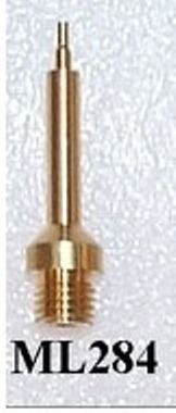

Old 12th July 2012, 09:43 PM   #25
rickystl
Join Date: Jul 2010
Location: St. Louis, MO area.
Posts: 1,633
Pneumatic un-loader for flintlock. In case you and your associates are interested. Rick.

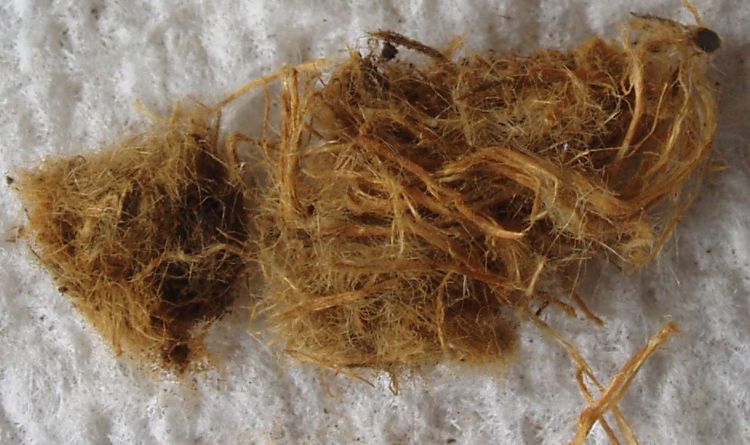

Old 27th July 2012, 02:58 PM   #26
Norman McCormick
Norman McCormick's Avatar
Posts: 1,657
Hi,
Attempts to remove whatever is in the bore have so far been unsuccessful but this piece of material, wadding?, and what might be small pieces of hard 'grease' was attached to the screw upon withdrawal. I would appreciate your opinions on it. I will make a tool with a deeper thread and have another go!
Norman.
Old 27th July 2012, 03:10 PM   #27
Gavin Nugent
Gavin Nugent's Avatar
Hi,
Norman.
Keep going mate.
This looks like the same flaxen material used in the maufacture of old sword canes. Perhaps this is part of an old late 19th/early 20th century method of deactivation.
Gav
Old 27th July 2012, 04:43 PM   #28
Norman McCormick
Posts: 1,657
Hi Gav,
You could be right, don't know whether it is an old 'de-ac' plug or a ball and charge. Never having had a sword cane what is the flaxen material used for? Thanks for having a look.
My Regards,
Norman.
