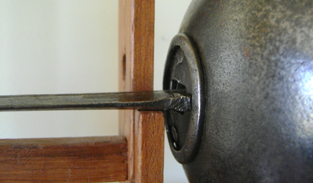

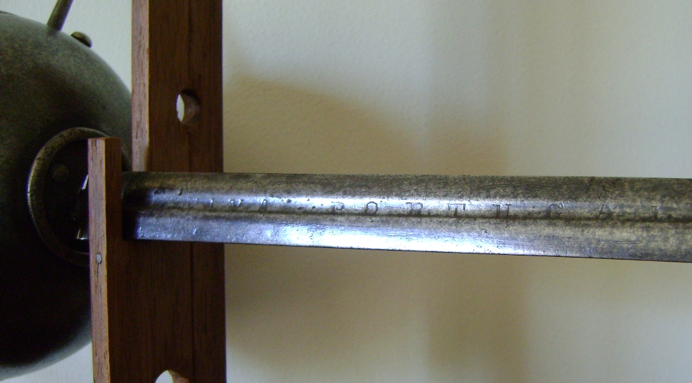

The legend VIVA PORTUGAL in the blade has generally appeared in swords by the end of Spanish domination (1580-1640), when the first steps for Restoratation of Independence took place. This sword may therefore be dated second half XVII century.

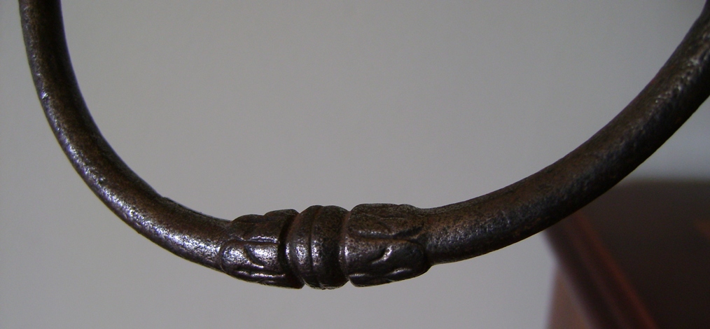

The knuckle guard not being fixed to the pommel would mean this is a civilian weapon ... as also the type of blade, within the rapier classification, with its 23 m/m width.

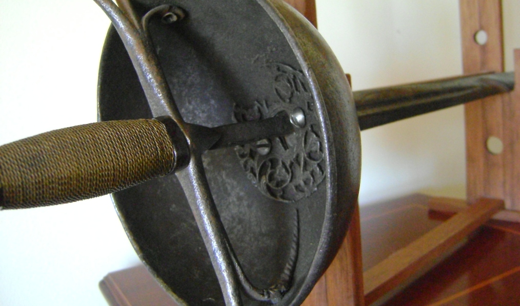

The quillon arms being fixed to the cup by screws would be more of Spanish taste; Portuguese are generally welded to the cup rim.

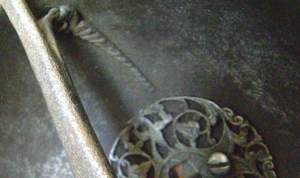

The pierced/chiseled dust guard (guarda polvo=guarda pó) is a bit broken, but still resists.
The grip wiring is a replacement ... i ignore (yet) what else.

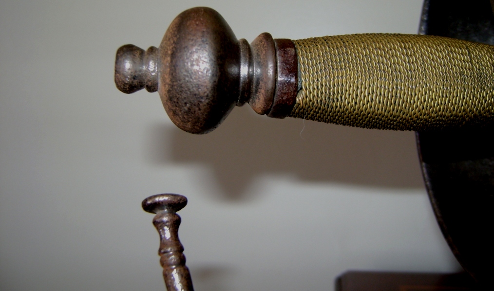

I am curious on the pommel type, I know I could consult Norman, but want to know from your experience...is there any particular chronological or regional classification for these. Some are very flat, while some have an almost urn shape to even spherical.
The blade seems consistant with rapier blades seen on Spanish rapiers of c.1680s and it seems many were made in Solingen (not saying this one is German though it seems possible as they were adept at adding these inscriptions).

Coming back to the one discussed here, Jim, i don't feel comfortable associating the pommel with the examples shown by Norman; i was actualy expecting you to do that for me ... and all interested . It is a plain pommel, like most seen in cup hilt swords. No grooves, no decoration, just as you see it in the pictures which i will try, as said, improve soon.
I can not deny the blade being from Solingen. But i beleive the words VIVA PORTUGAL were applied in Portugal and not a 'marketing' detail made by the (German?) sword maker. Particularly the words are engraved (punched) inside the short blade grooves, which they fully occupy, whereas one can discern some faded decoration on the edges, with the same extension as the grooves.

Some (maybe not) better pictures .
Such a pity that, as i feared, one of the beautiful extensions that hold the dust guard washer is missing
