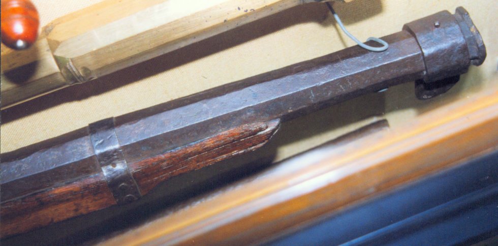

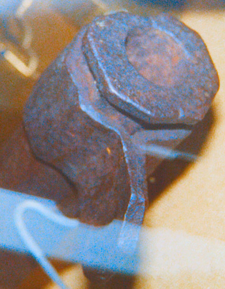

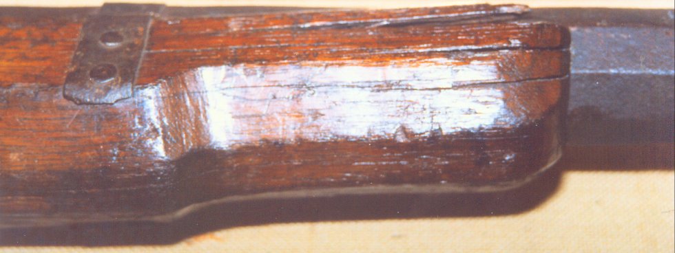

What is true for most earliest guns is true for this one: it should not be expected to have originally existed the way it looks today.
Overall length 137 cm, barrel 94 cm, bore 32 mm.
The museum description labels it as Bohemian.

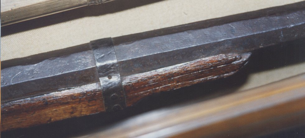

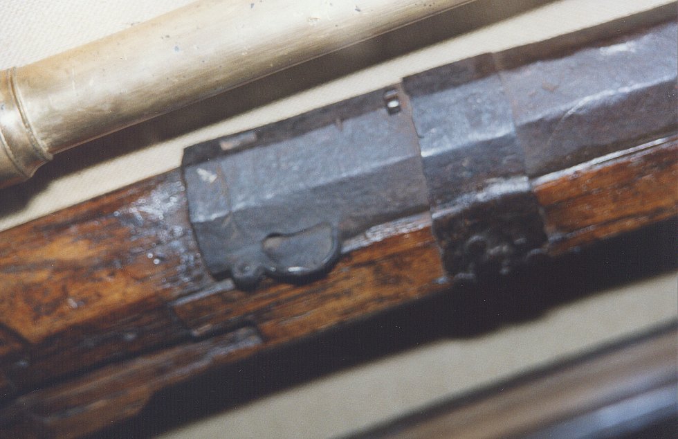

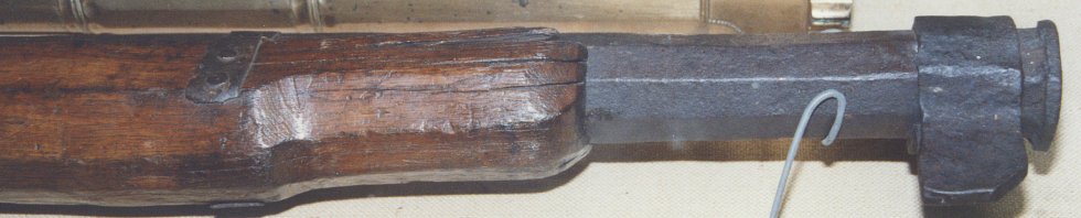

The wrought-iron barrel is octagonal throughout, changing flats within the rear section, the touch hole is on the right-hand side, the pan was probably added in around 1520 when the barrel was stocked; the pivoted cover is missing, its pin is still there). The muzzle section is short and swamped; the movable hook is not integral but a later working-life addition. Both the small back sight and the bead foresight on the hook must also be working-life additions, maybe of the mid-16th century.

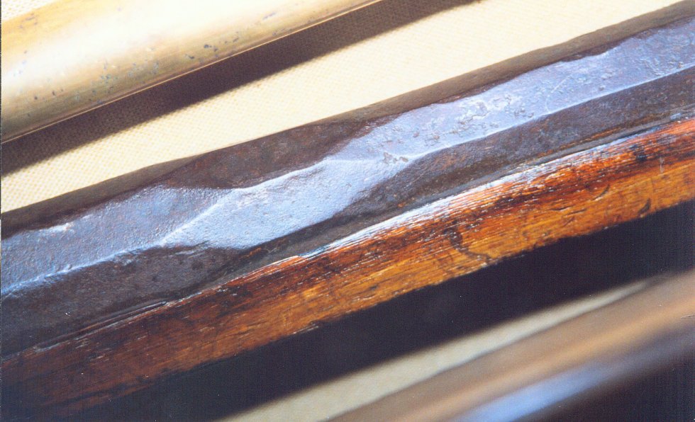

What is most remarkable is the fact that the barrel retains its original blued or blackened surface, with some remains of red minium paint (Mennige).
The barrel is nailed to the stock by two iron straps denoting that there are no stock loops on its underside. It probably was originally a heavy tiller haquebut (Stangenbüchse), then the rear tiller was sawn off and the barrel stocked around 1520. At the same time the original bach sight must have been removed (the hole is still visible) and the rear end of the barrel was mounted with one of the earliest barrel tangs used, shaped like a thick disc.

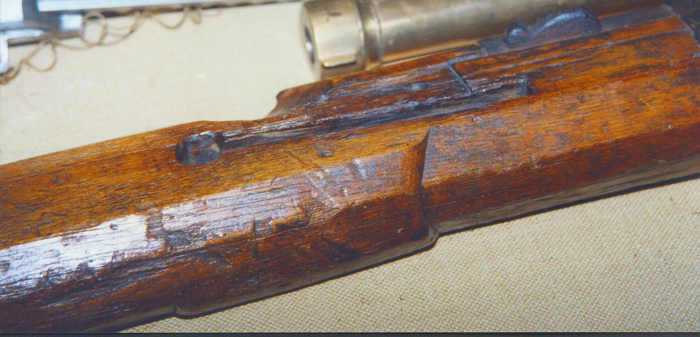

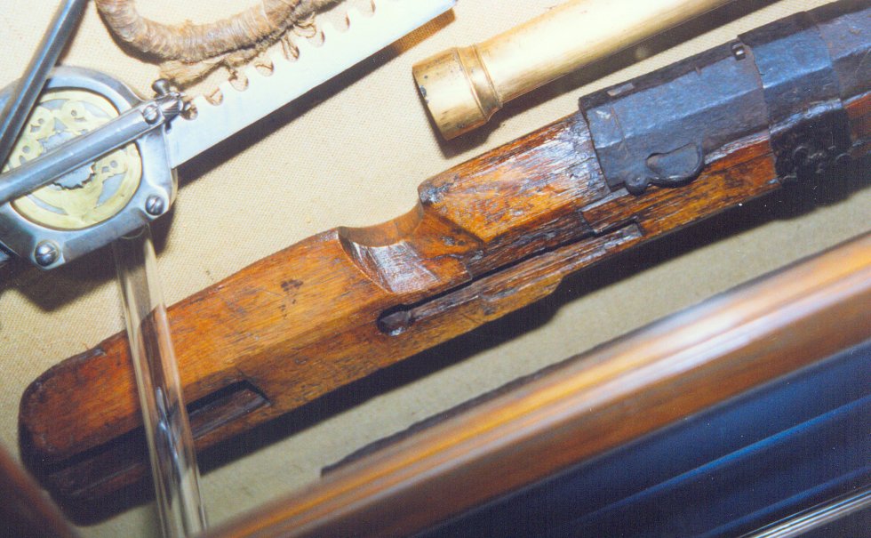

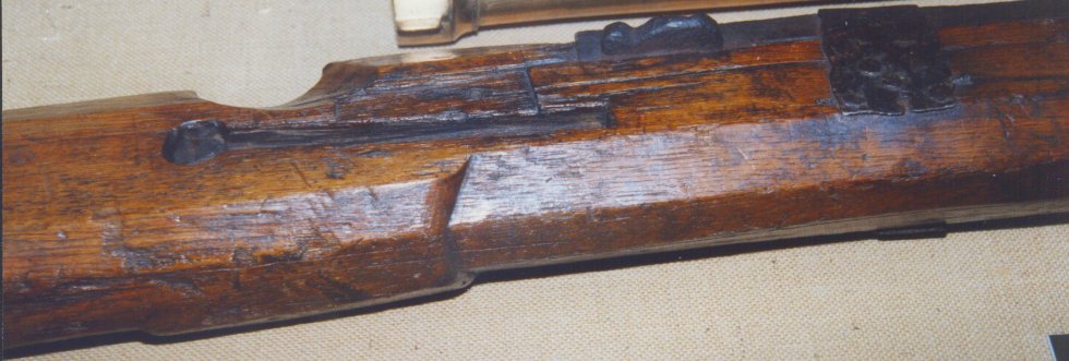

The shape of the stock resembles those of a few early-16th c. guns, with the exception that this one in Copenhagen has a butt trap the cover of which is now missing. 500 years ago, this butt trap did not yet act as a 'patch box' like on 18th-19th c. guns but probably originally contained spare balls (such were found in 'untouched' butt traps of 16th c. guns) or small barrel-cleaning accouterments such as a worm and scourer. The stock may have been added to the barrel around 1515-20.
What is most unusual about this heavy big-bore barrel is the fact that it was stocked like a 'normal' portable long gun or arquebus, which it was denititely not. The few other surviving complete - and 'real' - arquebuses of ca. 1500 have much smaller bores ranging from ca. 15-20 mm and weigh considerably less. We should therefore address this item as a stocked piece of light cannon (geschäftetes leichtes Geschütz), which was meant to be used in fortified places, e.g. to be fired from walls (wall gun).
The original lock mechanism, now missing, was most probably a snap-tinderlock; the rounded hole at the rear end of the lock recess marks the place where the lateral push button for releasing the cocked serpentine was situated.
I took the photos in 2000.
I attach images of the earliest known surviving detached snap-tinderlock mechanism, of early-16th c. date, from my collection, to convey an impression what the device originally looked like.

The remaining photos.

A second thought:
It is even possible, if not probable, that the stock was made as late as the 1560's because it already shows the characteristic deeply cut thumb rest of the early Spanish-Netherlandish musket stocks.
No other stock with this thumb rest is known before that period - and certainly not of the second decade of the 16th c.

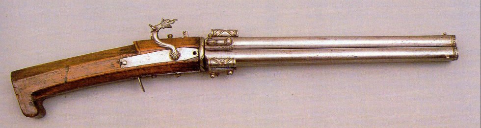

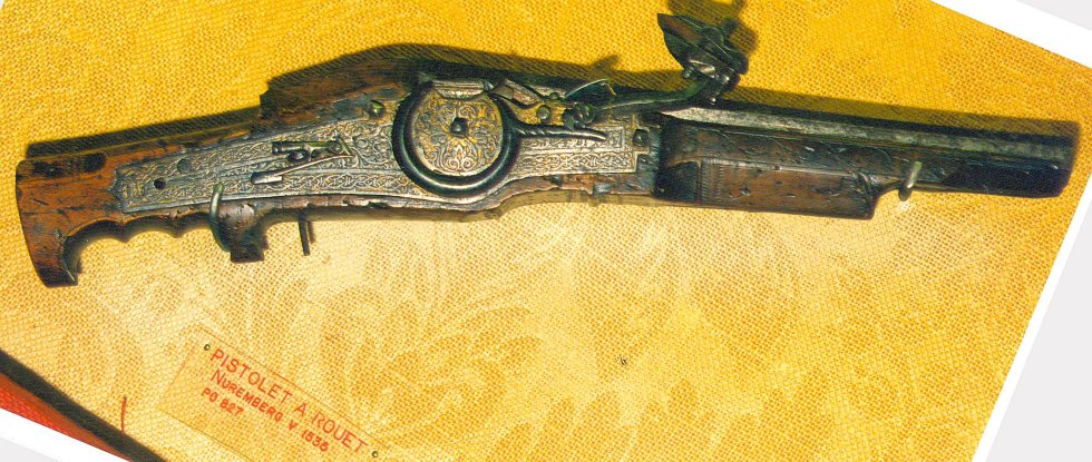

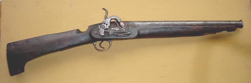

Absolutely true, 'Nando,
And let me add that the characteristc 'Spanish' toe on the underside of the buttstock goes back to Italian and German pistols of ca. 1535-40!
Attached are
- a North Italian three-barrel revolving matchlock pistol (Luntendrehling) of ca. 1535-40, in the Palazzo Ducale, Venice
- a fine Nuremberg wheellock pistol of ca. 1535-40, in the Musée de l'Armée, Paris
