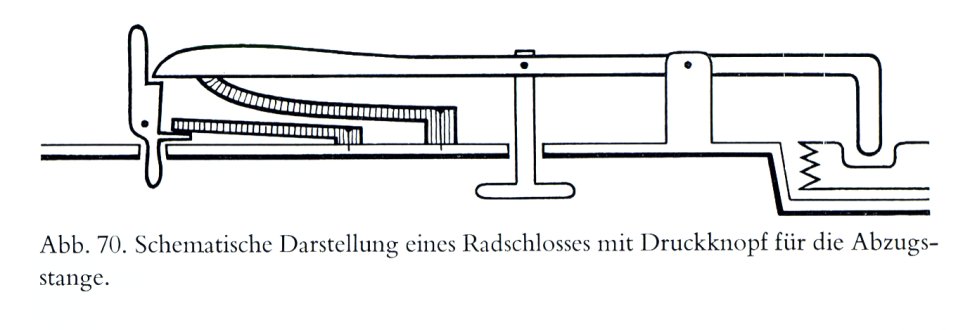

The principle of the press button, wich is normally only known from wheellocks of the 1550's in the Graz armory, is to tighten the pressure on the sear when the wheel is spanned. The actual sear spring was often too weak for a safe contact between the sear rest and the full strength of the wheel spring. With the button pressed and in activated position, the trigger had to be pulled with significantly higher force.

Welcome to the forum johnhb,
I expect you are satisfied with the answers to your question ... schematic drawings included

Segundo: El ejemplar elegido por JOHNHB para su interrogatorio, RG3 del trabajo de Brooker citado, no muestra ningún resorte actuando sobre el primer fiador (primary sear)
Tercero: Para que el resorte del primer fiador (primary sear) como aparece en el diseño adjuntado por Matchlock agregue mas fuerza al contacto entre los dos fiadores (sear), el resorte tendría que actuar acercando al extremo del primer fiador (primary sear) a la cara interna de la platina(plate) y no alejándolo, como aparece representado

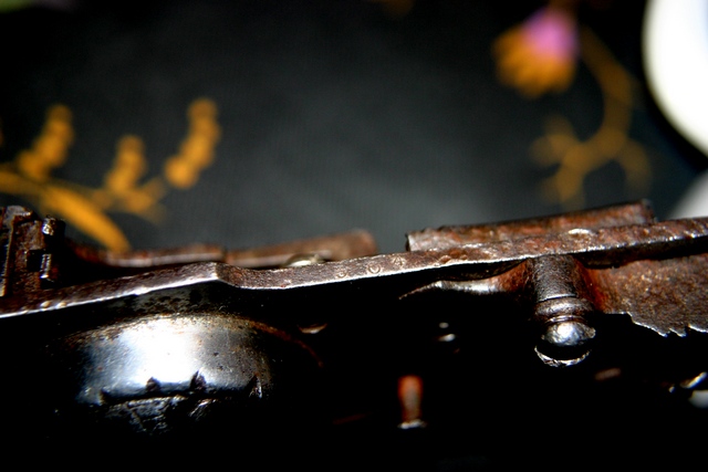

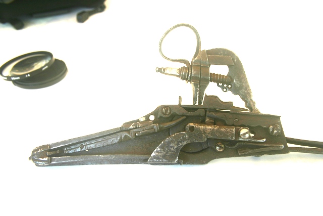

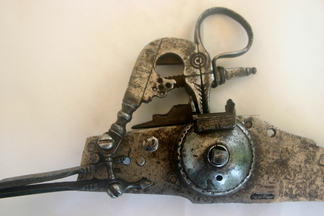

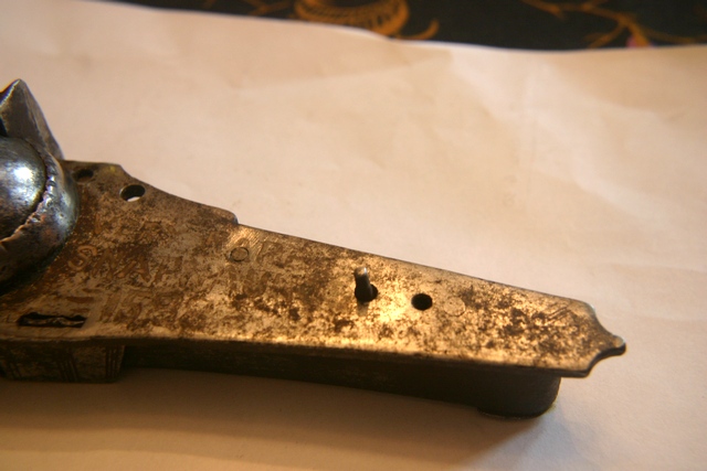

Here is a later (about 1580?) wheellock which has the sear engagement button, missing its head. The button is pushed out by a spring so it disengages the sear from the wheel. This requires that the button be pushed with one hand as the wheel is wound with the other. Must have been inconvenient on horseback!
The numbers on the bottom edge seem odd - perhaps they date from when it was made?
