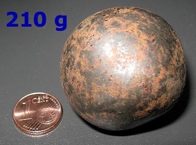

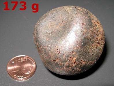

I have, for some time now, wondered from where all the wootz ingots for sale come from?
Some years ago it was seldom to see an ingot for sale, but within the last 3-4 years there seem to be quite a few for sale. I have not heard that they have started to make them again – so where do they all come from, does anyone know?

Having looked at many genuine wootz and pulad ingots, all the so called wootz ingots that I have seen for sale, are not genuine. The shape only slighly resembles genuine ingots. They are probably Mill Balls. Mill balls were made of cast iron or cast steel (therefore they can have a dendritic structure is polished and etched, like crucible steel). They were used to crush ore in the 18th century. This can produce a sort of pock marked surface, similar to the crucible steel slag. Beware of these well preseved ingots.
On another note, whether or not they are crucible steel or Mill balls, they are not from an excavation and are therefore looted from industrial archaeological sites. Buying them supports looting, looting causes loss of valuable and irreplaceable information.
I am working on comparing genuine ingots to mill balls.

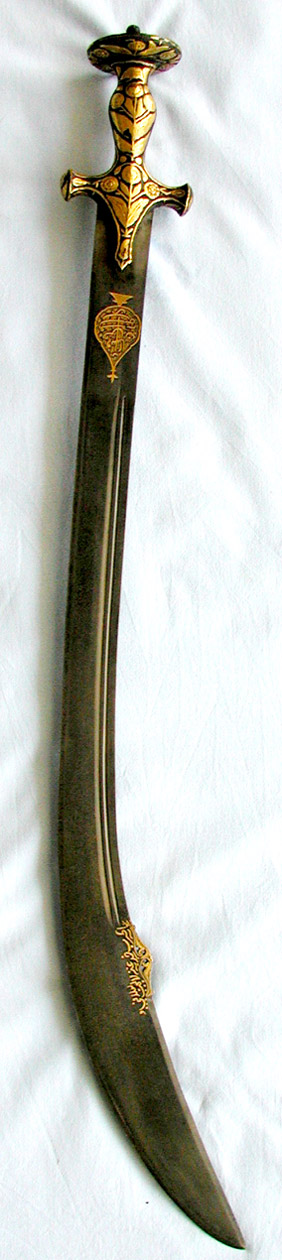

Jens, what is that pic you posted of? Obviously, a knife, and it looks like Wootz steel, but did you make it? What are the decorations made from, gold? That's quite an interesting piece, can you tell us more about it?

The picture is a detail of a blade – see the attached.
Tegha. Rajasthan. 18th century. The blade is wootz and the decorations are gold koft gari.

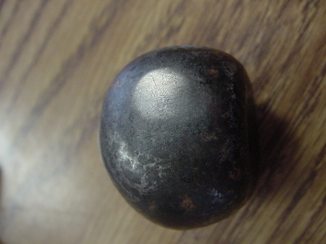

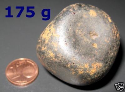

A few weeks ago Some wootz came on Ebay The seller made this statement " I found this antic piece of wootz cake or wootz bar in Rajasthan, India. It is an find from an old blacksmith of the Sikligar cast.." They sold for reasonable prices so I bid on some and won one mindful that from forum info that they most likely were millballs. It came in and it appears to be wootz after a less than final polishing. What do you think? Always looking for wootz items.
thanks, Steve

Steve,
I am not questioning the statement made by the seller about these cakes coming from India and being antique. It wery well could be. However, there are modern methods to produce them. See this: New_Wootz
The process describes making wootz cakes using cast iron, the freshly crushed green glass, dandelions and iron powder. It also shows four of these cakes, too bad no close-ups available for visual comparison.
I do not know if 'new' cakes will look the same as yours, or whether they'd show the same wootz pattern upon etching, or how to tell if they're authentic. Perhaps Rick will agree to comment.
