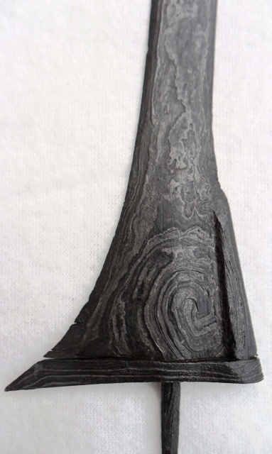

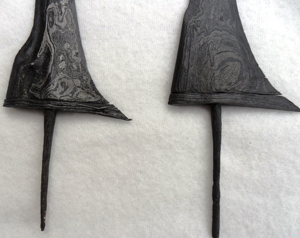

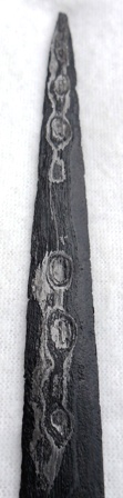

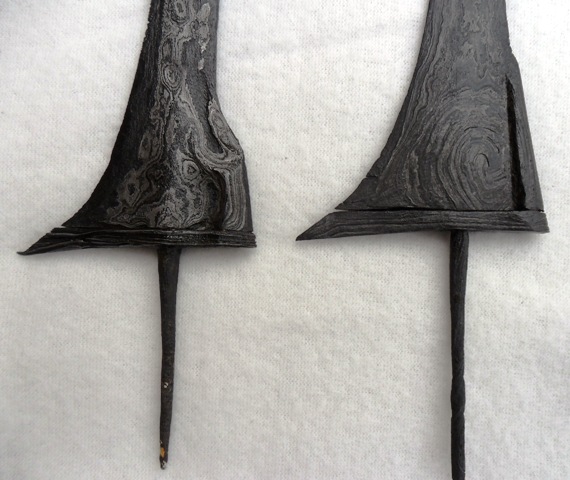

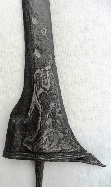

One of the things i enjoy the most in collecting keris is trying to bring blade,s back in a reasonable condition .
Yesterday i did take some picture,s during staining some blade,s and thought it might be fun to show them here on the forum .
Of course comment and tips are very welcome , because i.m still learning and trying what will give the best results .
The method i used was the ''soaking '' method in realgar with lime .
i also use sometimes the brush method but the soaking is more easy to do more
blades in one time .
Photo 1 : my luxury washing tube The blade are drying after cleaning
with detergent and lime .
Photo 2 : Drying and heating up after the first soak .
Photo 3/4 The pattern is coming up .
Photo 5 : Finished the soak and drying in the sun before oiling .
Result in the next post .

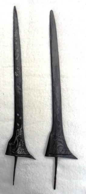

And the result .
After a night drenched with WD 40.
You can see clearly the differences in color of both blade,s because
the using of material and the time when the were made.

Good work!
Have you used indonesian (china) warangan or realgar that is possibile to find in usual mineral shop?
When i used not indonesian pink/orange realgar but realgar buyed from local shop(probabily it came from Mexico, USA or Italy) a very little orange dust (really very very difficult to get off) remained always over the blade
With warangan never!!

@ Marco.
I did use the ''normal'' orange realgar .
the problem with the orange dust i know , but i try to leave the piece,s of realgar out of the bath so no orange dust on the blades when the are finished.

@ Sajen.
Thanks , yes the blade,s are old and the are a gift to me from the daughter of the previous owner so even more special because of that
the blade with pamor batu lapak has a twisted part in the middle of the peksi , that is one of the things that always make me think why the did that on this blade ,in bali blades i did see it more often.
