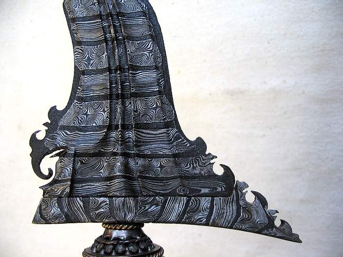

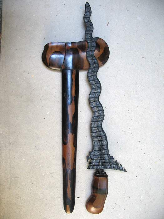

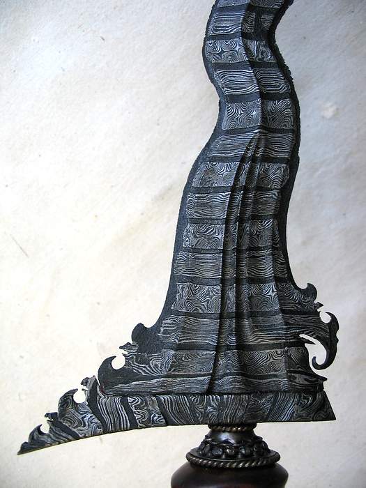

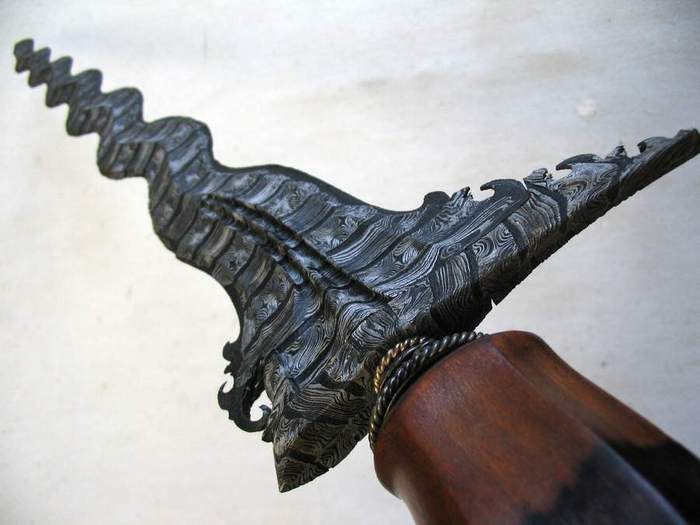

Hi Guys
This just ended. http://cgi.ebay.com/kris-knife-keris...QQcmdZViewItem
It looks more recent but of good quality it shows a nice pamor. Here are some close ups of the blade.
Lew

Hi Lew , I bought this piece from the same Seller :
http://cgi.ebay.com/ws/eBayISAPI.dll...tem=6544786628
The workmanship is quite good .
I'm pretty pleased with it for new Madura work , those guys are getting pretty advanced .
Only problem I had with my piece is that the gandar had twisted making for a poor,and very tight fit for the blade . I have been adderessing this problem with 60 grit sandpaper and the fit has improved quite a bit .
Instead of that funky deerhorn it now sports an ebony Kocet kocetan .
I like the pamor on mine (it's chatoyant) , but is probably not correct for a Bali blade .
Pictures when I get my computer back .

Hey Lew, like Rick's example from the same dealer, this one is also recent and not Balinese work. There are file marks on it that you would never find on Balinese pieces. It probably comes from Madura. I do agree that the workmanship is fairly nice on it.

Hei Lew, I agree with Nechesh and Rick opinions. Your blade came from Madura, and a fairly nice piece too.
The Madura makers have fairly advanced today. Some of them have became specialists, only doing the cold working or only work on the forging process. By doing so, their mastery in this art will be quite high. Today first-class work of Madura would almost 100% identic with the Java nem-neman works, from late 19 - early 20 c. But for the Bali style, well, it is probably not that good and still easily identifies.
best regards.

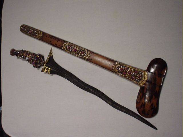

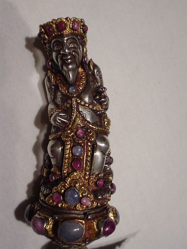

I've only become a member today. I am a sword collector and by chance got in possession of I think a beautiful Keris Bali with a silver/gold? Brahmaan hilt. I am preparing some pics which I will put on the forum later so hoping that you can give me some more interesting details. I think it is more than 100 years old and what I am most curious about is if the Brahmaan symbol has often been used as a hilt for keris. Myself I have done some research on the internet but couldn't find any keris yet with such a Brahmaan (Brahmin) hilt.
thanks.

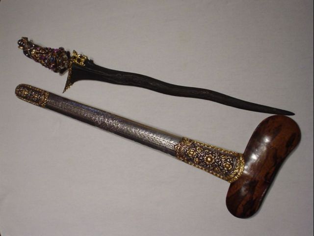

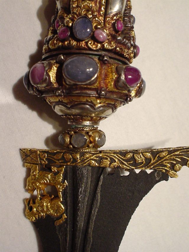

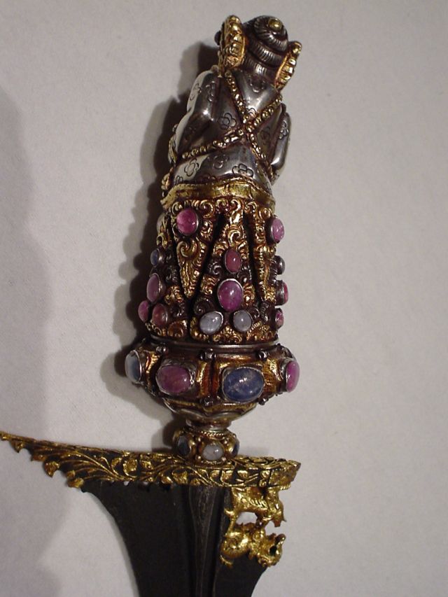

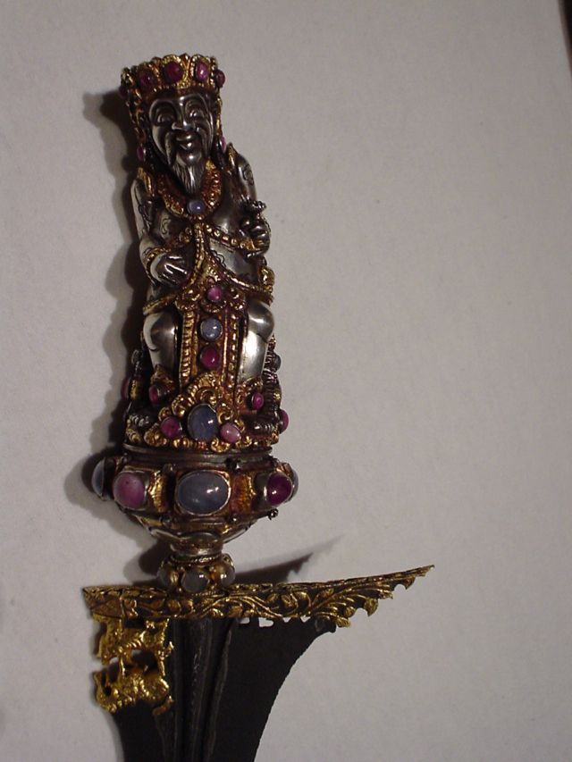

Here are some pics, hope they're of good quality in order to do a first assessment. Please let me know if more pics are necessary, for instance of the blade... Thanks

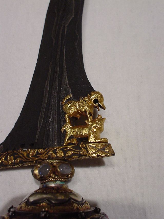

Hi Rocarnice, pretty looking keris you've got there.
The photos aren't great, but i would hazzard a guess that this is a fairly recent creation, especially the hilt. This isn't to say it doesn't have value and the silver, gold and all those stones are very nice.
I would also bet this is not a Balinese keris, inspite of it's initial appearence. The kinatah work (gold) on the blade does not look like Balinese work (i think only very few Bali keris have kinatah at all and those patterns and execution are different) and the keris does not appear to have the type of polished finish which is common on Balinese keris. Perhaps another recent Madurese blade? It is possible that the blade is older and it's just the kinatah that's new, but for somehow i doubt that. From the last photo it appears to have that even wear finish that is common on artifically aged Madurese keris. This looks like the type of flashy keris that is created to attract the western collectors. Pretty and certainly worth it's weight in gold, silver and gemstones.
