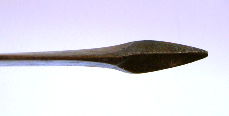

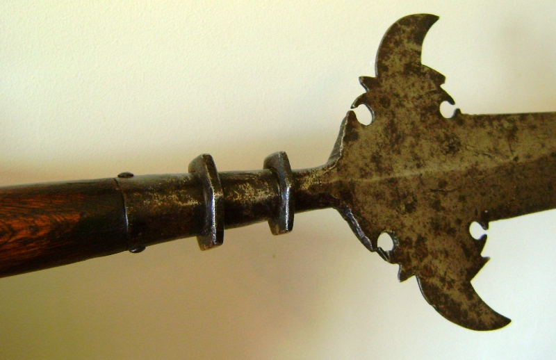

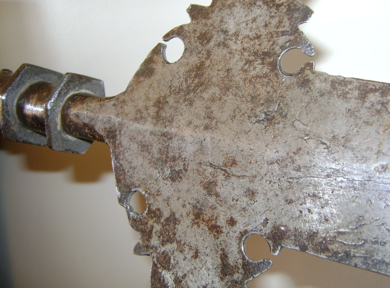

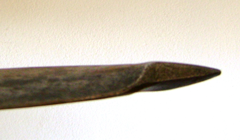

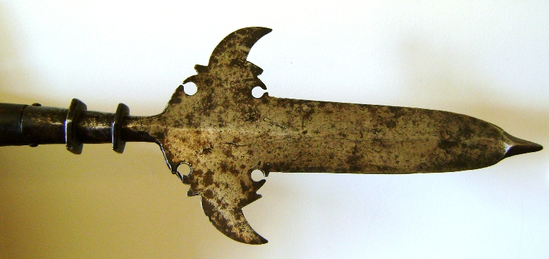

The blade tip is reinforced for armour piercing like no other.
The steel looks nice and well forged ... i would say
I am waiting for a written record from the seller, but his first approach was that it is North European, XVII-XVIII century; probably mid XVIII, i would say.
We can see a similar specimen in G.C. Newmann (picture 105 PA, page 218).
I wouldn't know if the haft is the original one, but it surely looks rather nice ... and not made the other day.
Would anyone care for coments?
Thanks

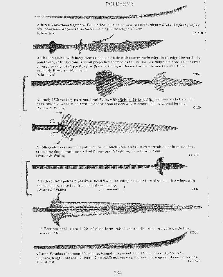

In Lyle price guide of milaria there is one on page 284 an caled it as a early 18 th century with no origin.
If i have the posibility i will scann the pages

Hi fernando,
of course here are the pictures.
Little poor quality because i had to make it by a fax.
First one from Seitz which called it a swedish partisan 1620-1630.
This one seem to have a swolen tip. it has a octagonal (?) base and engravings of Gutav Adolph.
Second one some older auction results from Lyle which mentioned no country but the swollen tip. One 17 th century the other 18 th .
