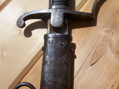

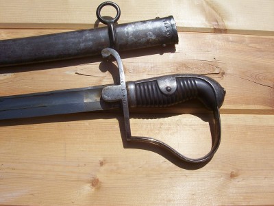

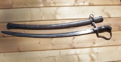

Howdy Guys,
FYVP
What I know: German Artillllery Sword, year 1907 "A la Blucher", originally based on the British 1796 saber.
What I don't know: Model? (M1854/1873?) Meaning of inscriptions?
Obviously it's weapon #110 from...
35st Rgmt. Motorized Infantry?
Has a really pleasant heft to it, being obviously designed for unpleasant work, not a court stroll.

Hi BBJW and Celtan, your swords appear to be fairly common generic cavalry weapons associated with Imperial Germany. I believe you are right in that thier design is based on the British 1796 light cavalry sabre and the German copy of it, the so called Blucher pattern. The actual date of adoption escapes me as I don't have any books with me at this time. Both swords are simplified, moderized and adopted around 1898 or so.
According to "Imperial German Regimental Markings" by Jeff Noll,
R I.M. 35 110 would stand for Reserve - Infanterie - Munitionskolonne 35, weapon #110. Ths would be a support unit dealing with suppying ammunition and the sort to infantry units. They would be mounted on horseback hence the cavalry side arm.
The other sword looks to be associated with a Artillery unit. I'd be happy to look up the unit if I can get a clearer picture of the langet.
Cheers,
Greg

I was starting to think this could be a Prussian M1873. Thanks for the translation, Sabertache..!
