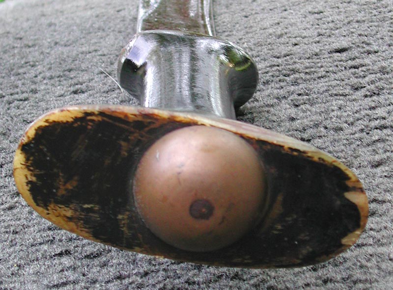

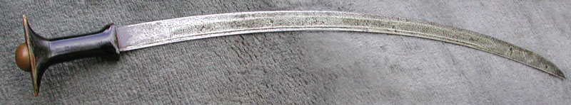

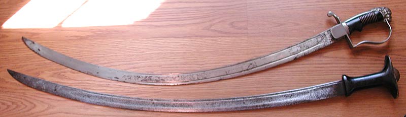

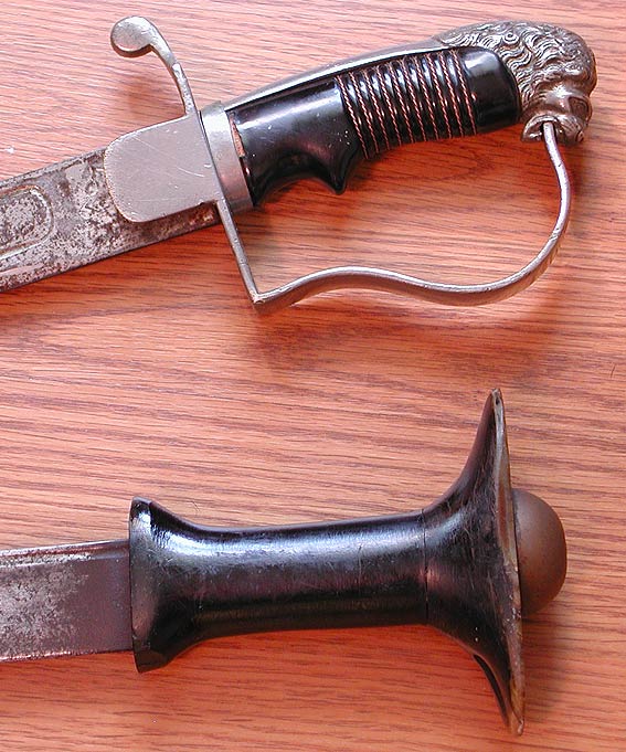

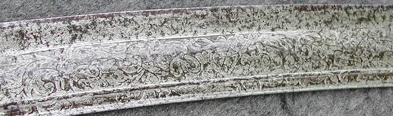

Both of these resent acquisitions have European blades, but very different hilts. Radu, I've been looking for a lion head hilt since I first saw yours! The other was a lucky pickup that I had to clean up (yes, the blade was black and I cleaned it) to find the pattern underneath. It was a nice surprise. The rhino hilt has been painted with something. It comes off pretty easily, so I don't know if it's original or done later. Anyone seen this before?

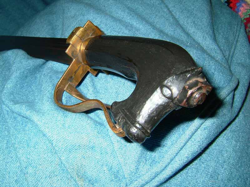

Yeah , I have a Philippine Revolution sword with a Carabao hilt that has been painted .
Now this sword has acquisition numbers painted on the blade so I'm not sure whether it was painted for preservation outside of its cultural context or not .

Nice swords the top one has a French made hilt often found on 1896 swords made for the Chilean army by the French. The other is a classical Ethiopian sword.

On the blade - a lot of mineral oil, elbow grease, and a plastic scotchbrite. I haven't done anything to the grip as I suspect anything that will take off paint will probably harm the horn as well. And that would suck.

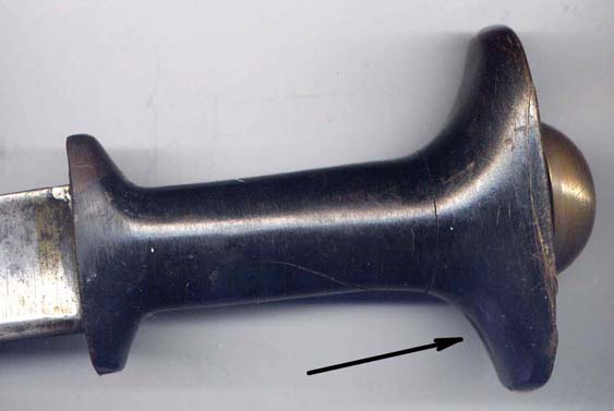

Hi Derek. Here is the hilt of one of my swords. It looks very similar to yours and it is painted black as well. I have not tried to remove the paint. I think it is "original". Also, note the cavity on the side of the top piece. You have one too. It is an indication that the grip 1s made of buffalo horn and not rhino. Glad you could clean up the sword. RON

Hi Roano,
Thanks for the info, I have a few others that are black as well, but without the indent that you correctly noted on this one. Question: is it definitely buffalo horn in your estimation, because it is fairly tanslucent and that led me to think rhino. I've seen enough variation in rhino now that I'm often not sure, especially when it's under paint.
