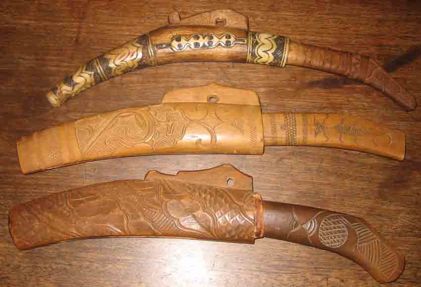

I cotinue to be eager to join this exiting list and I beg your willingness to examine a couple Ainu knives from my collection. These would be classed as "makiri" which would make them utility belt knives. The top one is certainly a Meiji era piece. The other two are pre-War and good of kind, but probably "high end tourist" pieces. Until the mid 1970's Ainu stuff was common in Japan, but with the opening of the large ethnographic museum in Senri Park, all of the best ethnographic stuff has been vacuum out of Japan. Potential discoveries are largely in the greater world. Anything can be anywhere!

Peter, would you be good enough to share the blade profiles of these pieces too.

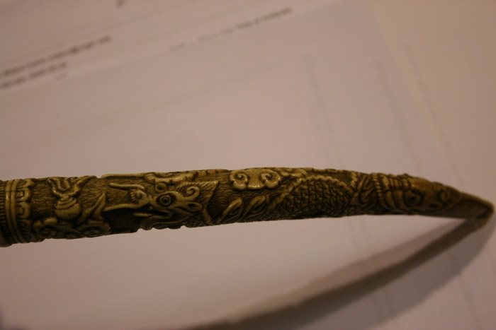

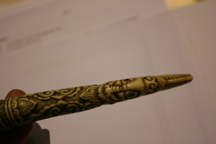

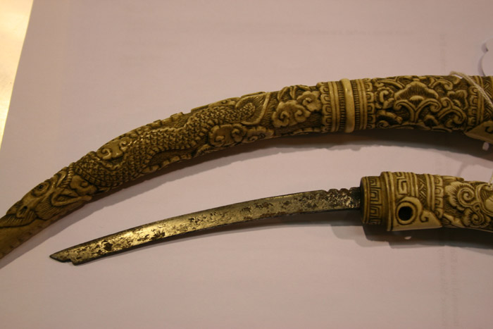

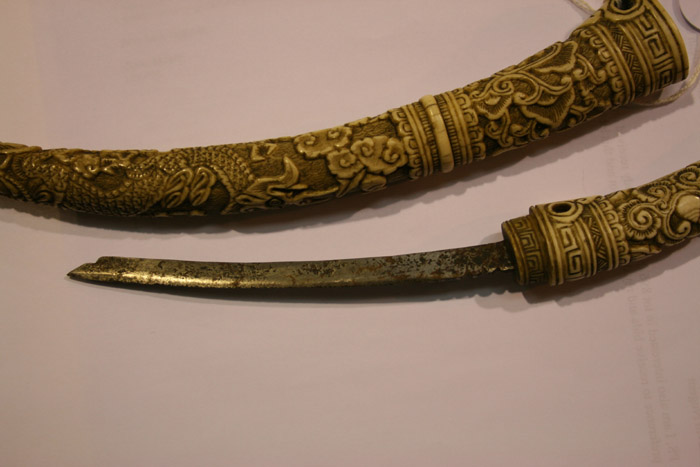

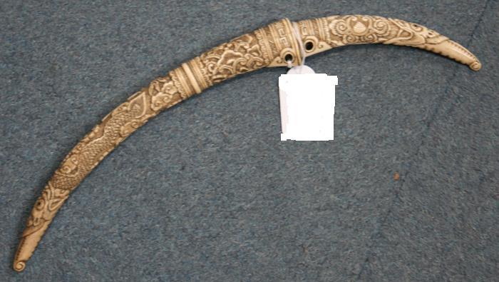

I have also recently watched a beautifully carved piece filter through an auction house, the images I have are not very large but i'll see if I can dig them up for further comparision.

The Museum I was speaking of in the Brooklyn Museum, In 1910 Stewart Culin, the museums first curator of Ethnology gathered an exceptional Ainu collection from abroad that was further supplemented by Professor Frederick Starr's collection which I beleive was displayed in 1904 at the "Louisiana Purchase Exhibition", an Ainu Exhibit.
The Piece pictured below is 36cms long.
Gav

Well, gee. I have been involved in the petty pace and slow in replying. There are 2 issues that need comment.
1. The small ivory knife frm the Brooklyn Museum that Gav posted. Far be it from me to disagree with the experts in Brooklyn, BUT, I am pretty sure that this is NOT Ainu. I would bet that it is early 19th century Japanese work in what is called a "topei" style mouting and that it is basically a flower arrangment tool. I have seen these little knifesd almost Netsuke size in a style rather like Ainu blades, but I am sure that this one is pure Japanese. I say that for 2 reasons. First the work in ivory is very well done, professional rather than "folk." The motifs are not very 'Ainu.' Second, the blade - inside sharpened, scoll clipped tip -is right out of flower arrangement. But, hey, can museums make mistakes?
2. To Jim's statement about "ceremonial use" of Ainu swords, I would say "Well, yes, but..." Makiri and bush knifes were basically working tools. I'll post a couple more images tomorrow to illustrate these types. The ainu also had longer swords that were large "trade goods" from Japanese officials. I think these overwhelmingly WERE used as symbolic and 'ceremonial" rigs that marked " 'portant people.

1. The small ivory knife frm the Brooklyn Museum that Gav posted. Far be it from me to disagree with the experts in Brooklyn, BUT, I am pretty sure that this is NOT Ainu. Peter
G'day Peter, just to be clear this is a knife that was passed as an AInu knife in an auction.
I have not had the pleasure of viewing anything from the Brooklyn museum other than what I have seen in print.
Thank you very much for pointing out what the piece is though and I am glad I refrained from bidding and I can adjust my notes.
