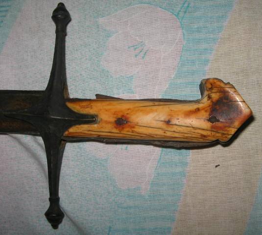

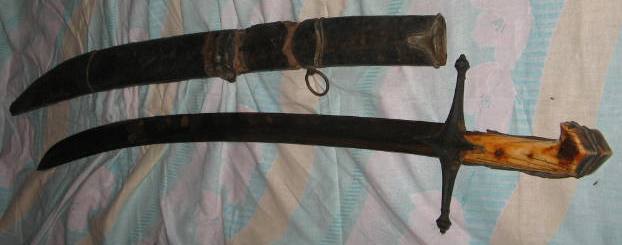

this belongs to a friend.do you think this can be a fully orginal karabela, with this cross guard, or the guard must be a later replacement to the hilt?
regards

Can't see details, but it may well be perfectly original Turkish karabela.
I love this type of weapons: old, scarred, not fancy, faint odor of rotten blood....
Soldier's stuff...

i've seen very limited number of samples in real till now, and all had short or up curved quillons. and i 've seen this long type guard on mostly 19th c. kilijs.
None of the groups shown in the previous "Polish karabela" topic have such guards. thats why i am confused. so this can be accepted as a new group?

Hi Erlikhan,
I agree with you, also the grip scales do not match the shape of the grip band.
Jeff

Could it be just age deformation? Would be good to examine the sword in greater detail.

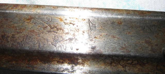

Karabela ("eagle-head")was originally a Turkish sword , probably even named after Karabel (near Izmir), and I would not be surprised to see the "Kilij" guard on one of them. I agree, this looks like a most likely 19th cen creation. What about the blade? Any distinguishing attributes?

there are some figures on the blade. i dont know if they will help. But the blade shape is technically a perfect karabela . i really dont know if a place with name "karabel" exists around Izmir, but karabela means exactly "black curse" in Turkish, often used in daily life , even can be used as a nickname for a tough bully .it could be a healthier root for the name of this saber model.
The grip band is silver, and is just deformed by time, tips of broken parts going bent up.

It does. Please see..
http://www.livius.org/he-hg/herodotus/hist13.html

This seems to be as noted, likely to have been furbished in the 19th century (possibly earlier) and the crossguard appears to be from an Ottoman sabre of that period (probably kilij as noted by Ariel).The grip seems too thin for that crossguard as well, at least from appearance. This only means that what may well be earlier components were put with this guard in the swords working life, and this seems to be, as Ariel notes, a good fighting example.
It is interesting on the discussion of the term 'karabela' and I have of course heard of the plausible thought of the city in Turkey as having suggested the name. This seems quite possible as if I am not mistaken, Islamic swords were often termed by places associated with the origins of form, forging, even materials used for the sword.
On the term it seems even in Poland, where these were adopted as a form of national weapon especially as parade or dress sabres, the term alludes to a Latin root such as including the 'bella' (=beauty) and kara. I think this was in an article which I will have to reference later. Naturally this was presented as another conjectural theory, as the actual origin of the word remains elusive.
In any case, these are always beautiful sabres, and like Ariel, I like the real rough ones, this one is nice!!
