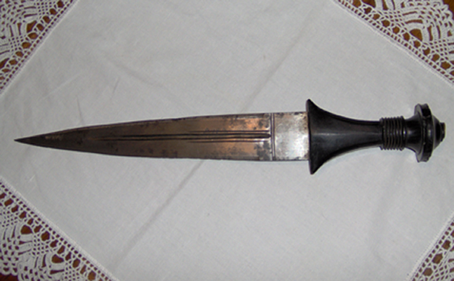

Hi all,

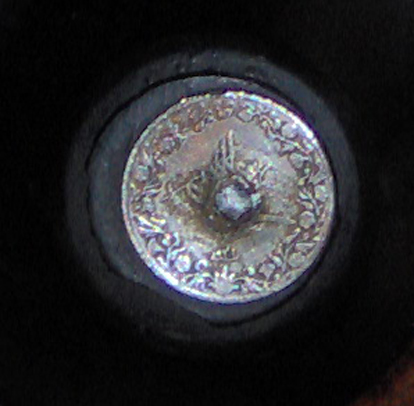

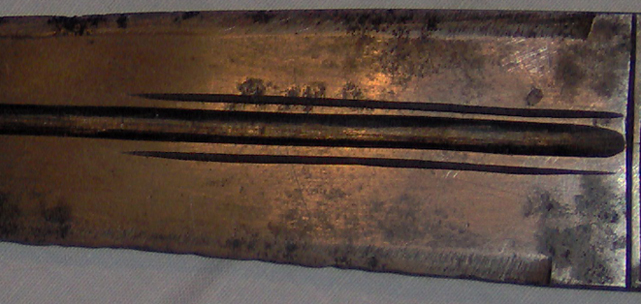

This is my last purchase: it's a sudanese dagger (meaning for Sudanese all the zone to south of the Sahara). The handle is made of ironwood and on the heel of the handle there is an arab silver coin. It's quite normal to find a coin on the heel of these daggers, but my question is: someone recognizes this particular coin? The provenience and the dating? The blade is of good iron/steel with some chipping on the edge and the tip bent and beaten again.

What you have on the dagger appears to be a coin minted in the Ottoman empire as it carries what appears to be a Tughra, in other words the Sultan's emblem in the shape of an elaborate calligraphic composition which contains his name and imperial titles. The Tughra may shed a light on the period the coin was minted but the picture is a bit too small. But mind you, Tughra writing is not easy to read.
I'm no expert on Turkish history and coinage, so can someone help?

Hi Flavio. I have a decent collection of Ottoman coins from the time of Orhan (abt. 1325 AD) till the last Sultan Muhammad VI (1923 AD), altogether some 600 – 700 different pieces. So I feel free to identify your coin. First of all, I like to state that the coin is a very good help for dating your dagger, as it is obvious that the assembly date can not be earlier than the date of the coin. (nevertheless, some parts like the blade might be much older). Your coin is indeed from the Ottoman Empire, it is a 5/10 Quirsh minted in Misr ( Egypt), so minded not far from Sudan. The side with the Tughra of Sultan Abdul Hamid II. is visible, below there is the Arabic number 21 and the word Sene, which means year. So this coin was minted in the 21st year of the reign of this Sultan. He reigned from 1293 AH till 1327 AH, which is from 1876 AD till 1909 AD. So the year of minting was 1896 AD (you have to add 20, not 21, as that would count the first year twice).
On the backside, you will find a large Arabic 5, date of accession 1293 and the name of the mint Misr. I only have to disappoint you about the material, it is not Silver, but Copper-Nickel, the silver coins from this Sultan have much different ornaments.

Kamil’s statements are right, all coins of Egypt were struck in the name of the Ottoman Sultan till 1914, the beginning of the British Occupation. Nevertheless, it was merely for formal reasons. (They were different from the coins being in circulation in Turkey, they only have the same Tughra, the "seal" of the Sultan on it)
Especially this coin in question does not fit into the traditionally monetary system of the Ottoman Empire, which counted 40 Para to the Quirsh. You see that the Quirsh is now divided into 10 parts and Copper-Nickel is used as a metal for coins. (until that date only pure copper, silver and gold were used) This type of coinage was introduced in the year 1886 AD, definitely under influence of the British, the “de facto rulers”. As far as I remember, they were even struck in Birmingham and put into circulation in Egypt.
