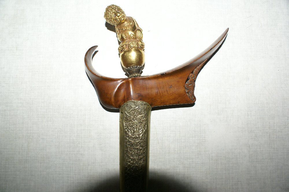

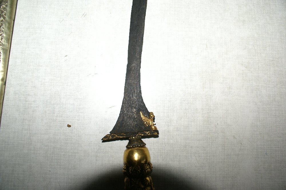

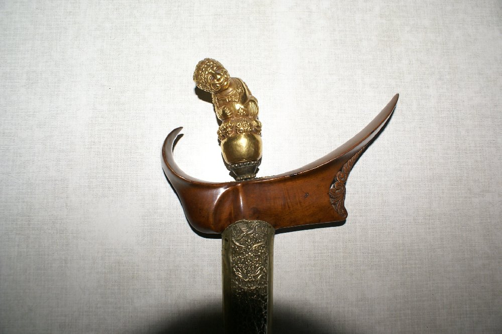

Hello All,
some years ago I bought in Indonesia all this parts in one year. A golden Cirebon handle, a nicely carved Cirebon warangka, a pendok buton from Yogya and a blade which become thin by many ritual cleanings. Also the pamor is gone. The gandhik Widadari (?) is covered with gold, fractional missing alike the kinatah emas on the ganja.
I know that the pendok is not adequate but until now I don't found a better one.
I would like to read your opinons of this keris, thank's in advance.

The wrongko is from Madura. The ukiran has more the look of an East Javanese or Maduran Raksasa. Imho this keris originated more from East Java or Madura than Cirebon.

Dear Henk,
thank's for reply. Isn't the wrongko/warangka not the same style like the keris in this thread: http://www.vikingsword.com/vb/showthread.php?t=7839
I also thought long time that it is a Madura wrongko.

Dear Detlef,
I will eat my hat if that wrongko isn't from Madura. Certainly not Cirebon. The style is ladrang and most ladrang wrongko's have that similar style and one has sometimes to look very careful to notice the differences between the regions.
In return I give you this link. Study, but above all, enjoy!!
http://www.vikingsword.com/vb/showth...hlight=wrongko

Dear Henk,
I don't want that you have to eat your hat . You are right, on the second page of the link Mr. Maisey show a wrongko very similar to mine. But so the handle have also Maduran style and goes with the wrongko?

hi Detlef,
nice piece! But... i also think the wranka is from madura a little more
fancy carving then what u see often on this wranka,s
and the hilt ...... could it be bali or lombok? it,s a wild ques..
danny

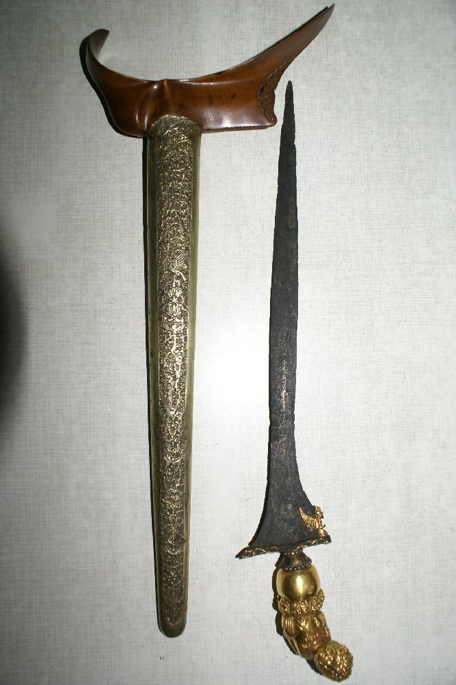

Yes, it looks Maduran warangka -- if we look at the carving on that part of warangka...
Below, for comparison -- I am posting for you, some Cirebonese warangkas originated from Kasepuhan, Cirebon. Two in the middle, with 'wadasan' carving, and one plain without pendok (left) and one 'iras' type warangka (one piece of trembalo wood)...
Many old Cirebonese warangkas, found without metal pendok. But some have specific Cirebonese pendok...

I am confident by your help. Because I have never before seen a warangka like this from Madura and the affinity from my one to Cirebon ladrang form I've thought it's a Cirebon one.
But what is with the handle and blade? Both adequate to the sheat?
