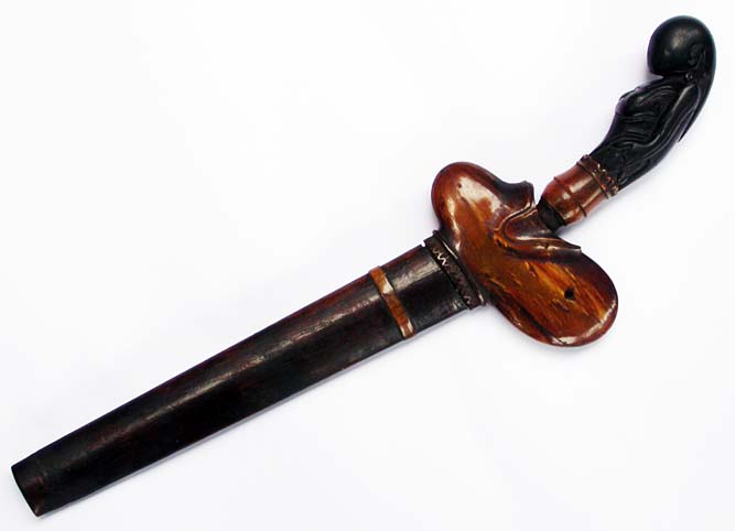

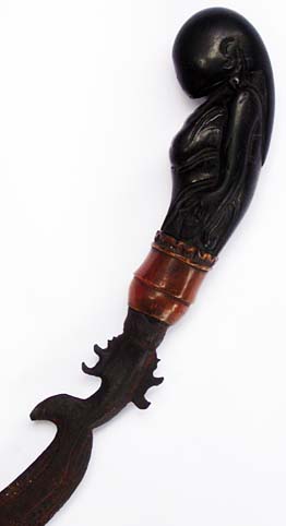

Dear All,
I took this photo at an exhibition, Pesta Rakyat Cirebon (Folk Festival of Cirebon) at Jalan Siliwangi, Cirebon last week. An interesting combination -- "durga" hilt (?) combined on an old "kudi tranchang" (kind of sundanese kujang) -- in an unordinary sheath (the form, and the material of the warangka). The upper warangka, the "pelokan" part (not the gandar part) is probably made of "albino-buffalo" horn...
What I want to know, is there any information on this kind of (durga) hilt?
GANJAWULUNG

Originally Posted by VVV
I don't think that's a hilt usually seen in Cirebon?
I don't know, Michael. But at least I saw two more hilts such like this in the Pesta Rakyat Cirebon last week. They called such hilts as "gendheng permoni hilts". (I myself got two hilts such like this from Cirebon and Banyumas (south of Cirebon) area in the past...
"Gendheng Permoni" known as a goddess in Wayang world. A very beautiful goddess with "bad" manner. She wished to be Bathara Guru's (the highest god in Kahyangan or Heaven Kingdom) wife. But Bathara Guru only took Permoni's beautiful body as his wife, while he exchanged Permoni's soul/spirit with Dewi Uma's.
Previously, Dewi Uma was cursed by Bathara Guru -- to become a "raseksi" (female giant creature) after Uma refused to make ... with Guru, while they were riding "lembu Andini" or sacred buffalo of Andini.
The "raseksi's" (the giant Uma's body) with Permoni's soul, then called as Bathari Durga. While beautiful Permoni's body with good-mannered Uma's soul, as Dewi Umayi. Only Permoni's body, became Sang Hyang Bathara Guru's wife. And not Permoni's soul...
GANJAWULUNG

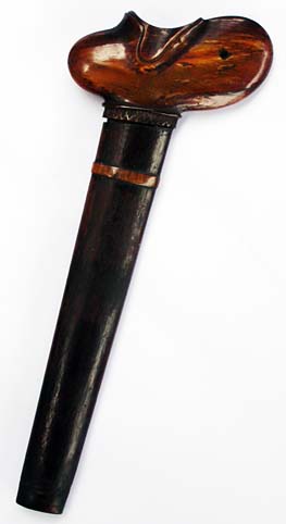

... And this is the "Bali version" of such hilt. Of course, the hilt size is much much bigger.
GANJAWULUNG

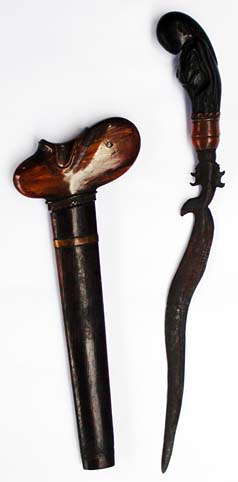

Another pics on "permoni" or "durga hilts". The brown one, I found it in Banyumas area -- about 100 or more kilometers South of Cirebon (western part of Central Java), and the black one I got it from Cirebon area...
GANJAWULUNG
