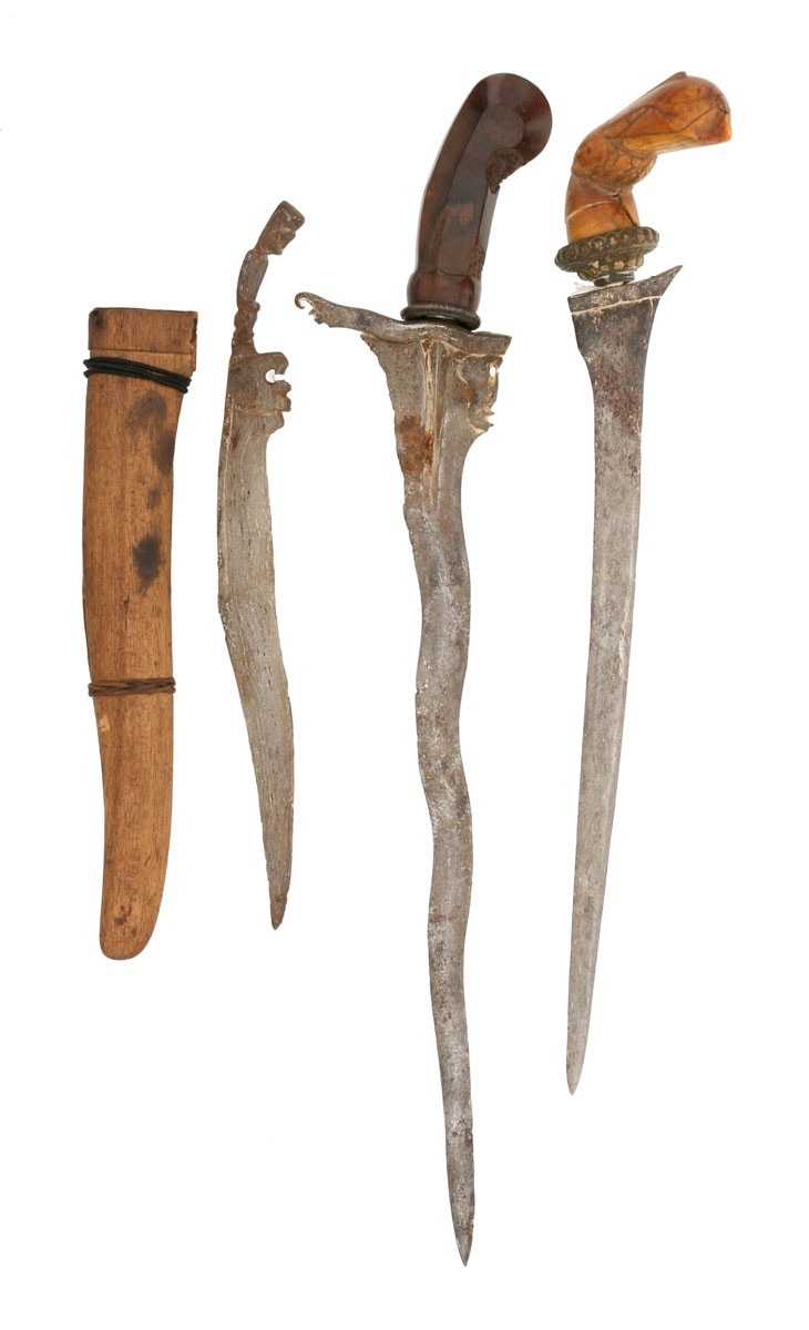

I have been collecting krisses for the last few years.
Recently I got a nice buy, three very interesting items at once.
Would like to hear your opinions about age and more if possible.
They come from an old collection (where they obviously where not kept well) but they came to the Netherlands before 1940....
Sajen Kudi? Not my field so would like to hear more
Keris Singa Barong (interesting mendak/selut?) that might be madjipahit period?
Bugis Keris, rather small with an (marine?) ivory handle with obvious damage but very nice nevertheless.

Hello Erik,
This form of keris sajen is usually called cundrik. Here's a nice overview from Alan: http://kerisattosanaji.com/kerissajen.html .
Bugis influence but the blade looks Sumatran to me.

Very interesting website which I did not know yet.
Very nice.
Indeed maybe not Bugis but Sumatran.
In both cases it is quite small which makes Sumatra a bit more likely I guess.
Thanks, Erik

It's both Sumatran and Bugis. The hilt form is another indicator of Sumatran (Riau) origin.

Thanks for the comment BluErf.
So you would say it is Sumatran (Riau) of origin but with strong Bugis influence?
