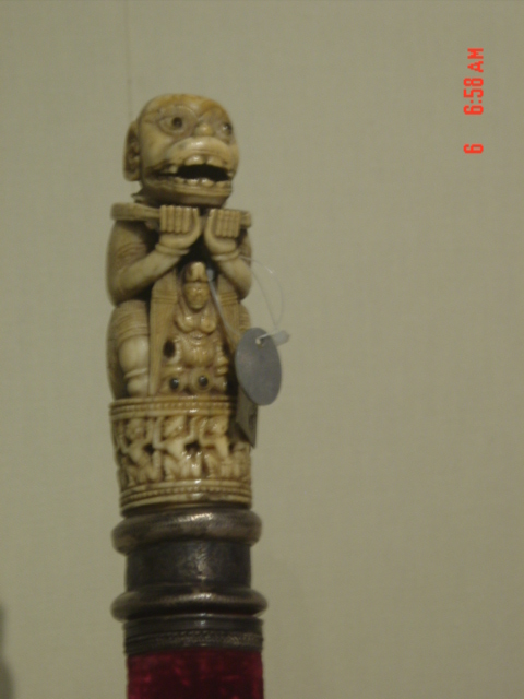

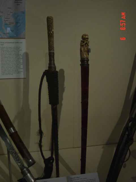

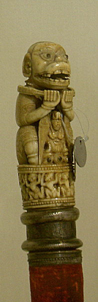

Have you seen anything like that before?

I haven't. At least not on a dha. The proportions are off: too short for the weapon it's mounted on. Almost looks like a keris handle.
Some interesting stuff in that case. Got a pic of the text panel, Ariel?

No: the reflection in the glass was far too strong.
I agree, very short handle, but the sword was a dha, no doubt. Also look at the dancing figures at the base of the handle:typical Burmese. And the 'monkey" itself is holding a Dha!

not much help, as i think even Dr Quincy would have trouble deciphering the blur. bits can be made out if you squint enough.

I'm almost certain we discussed, if not this same object, then a different statue of the same figure on the old forum, but I can't remember more than that; I've definitely seen this guy before....

I recall our previous discussion also, in the old Forum. The image of Hanuman is not rare in Burmese culture. The handle does seem much shorter than usual, even for Burmese dha which often have shorter handles than their Thai neighbors. This example is closer to the length of hilt seen on knife length dha -- whose blade lengths are in the 10-16 inch range -- rather than on longer swords such as this one.
B.I.: Do you still have the original digital picture of the description at a higher resolution (pixels per inch)? If so, then Adobe Photoshop is a great program for manipulating images and it is amazing how a 300+ pixels per inch image can be encouraged to yield its hidden secrets. The photo you posted above is only 72 pixels per inch.
I can make out the heading and first line of text:
"Sword (dha)
Burmese (early 19th century)
The blade and scabbard of this dha ... "
and the rest is hard to decipher, with a few tantalizing references to "monkey."
If you have a larger file I'd be happy to work on it in Photoshop.
Ian.

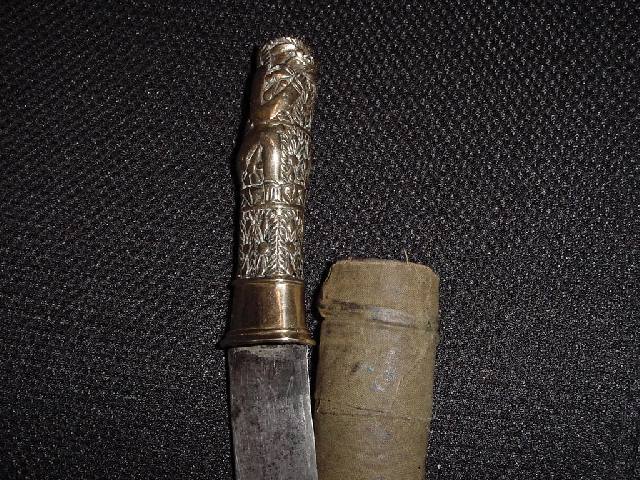

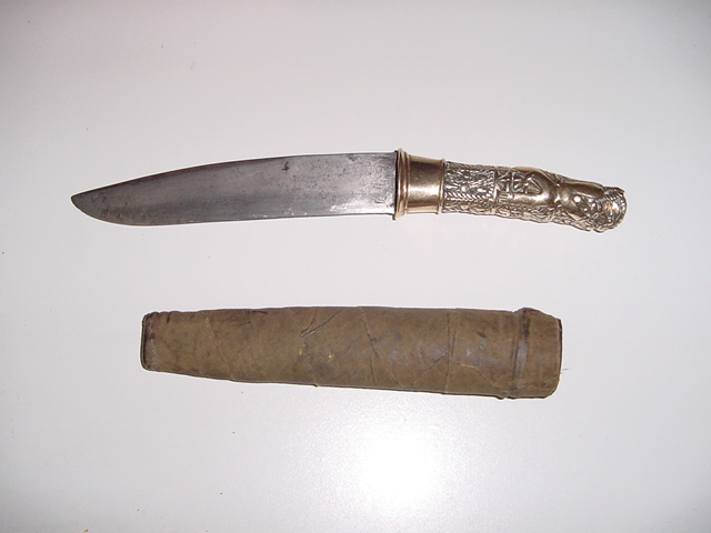

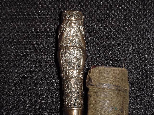

Archer asked me to post these images: a short Dha (a knife, actually) with the handle remarkably similar to the one from Leeds.
Judge for yourself.
Archer, thanks for the info!

Yup: looks like the same little guy to me.
Nice grab, Archer. I was really looking at this one, and decided not to bid. I now regret that decision.
Ariel, I still think the carved handle in the Leeds' collection is too small for the sword it's mounted on. I submit it's a remount from a dagger similar to Archer's. Many thanks for starting this thread, as I must have missed the first one.

I REMEMBER SEEING SOMETHING ON THESE KNIVES THEY WERE REFERED TO AS PRIESTS KNIVES AND SOME HAD VERY WELL CARVED IVORY HANDLES AND SOME WERE PLAIN. THEY WERE ALL DAGGER SIZE AND THE HANDLES WERE IN PROPER PROPORTION, WISH I COULD REMEMBER IF IT WAS IN FORUM POSTS OR ELSEWHERE I MAY HAVE SOME PICTURES SOMEWHERE IF I RUN ACROSS THEM I WILL PUT THEM IN.

Good call, Barry. Archer's knife is what I would call a priest knife, which I theorize is actually as much related to the piha kaetta as to the dha. I agree with Andrew that the handle on the Leeds dha is likely a transplant from a knife.
