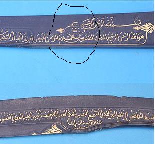

In another thread ( Turkish / Indian ?? Kilij Sword ) the early date of the sword posted above raised some questions regarding its age. It was thought that this type of Kilij blades (or Pala, to pacify Ariel), are rather late. Mid to late 18 C. and onward. The sword in the earlier thread was dated to 1037 (1627). I am bringing up for comments another blade, of even more important provenance, and of an even earlier date:
A close up of the inscription on the obverse side near the Yelmen:
Which reads: Al Mughazi Sinan Pasha Saneye 1000 (The invader Sinan Pasha the year 1591)
And:
Bisrasm Saheb al Dawlah (Ordered by the country's ruler)
And follows with: Bismella al Rahman al Rahim (In the name of God, the most Gracious, the most merciful) and than on both sides of the blade all the attributes of God:
He is Allah, the Beneficient, the Merciful, the Sovereign, the Holy One, the Peace, the Keeper of Faith, the Protector, the Majestic, the Compeller, the Greatest, the Creator, the Maker, the Shaper, the Great Forgiver, the Dominant, the Bestower, the Sustainer, the Opener, the Knower, the Withholder, the Expander, the Abaser, the Exalter, the Bestower of Honor, the Humiliator….. and so all the 99 attributes:
Sinan Pasha is a well known figure in the Ottoman history. For most of his mature years he was a high ranking commander in the Ottoman army under Murad III and Mehmet III, and five time appointed as the Grand Vasir until his death in 1596.
Was this his sword?? Why not. The blade is definitely old. The inscription is of top quality both in inlay technique and calligraphy and fits the period style. The blade might be even earlier: On the reverse side there are traces of an earlier cartouche.
So what do we have here: A late 16 C blade that was supposed to appear in the late 18 C. may be we should reconsider our knowledge on Pala swords??

What can be said about a blade like this, but "amazing"....and if it is 16th century, it turns on its head previous assumptions about kilij/pala blades of the this style.

I would look for a real 16th c. Ottoman expert to get assistance,about the correctness of the inscription,its grammer and caligraphy . We have been seeing samples certainly from 18th c. but which have 16th c. datings.
My general & amateurical opinion,16th c. was very glorious for Ottoman Turks and arms of that period could possibly gain demand in collapsing, unsuccesful 18th or 19th. centuries in parallel to the miss for those glorious old times, and such swords with earlier inscriptions can perhaps be named as "antique fakes ", not? But yours is lovely, even lovely enough to belong to a grand vizir, -or to invest long time and skill cost to produce as a convincing fake -not today for sure but 1-2 centuries ago-, to sell for a very high price. I doubt about the earlier cartuche traces. It should be very easy for a skilled 16th c. artist to remove those traces (I guess like the one signed in the attached picture) completely ,or to restore them in a harmony with his own golden decoration on the blade if he or his customer wishes to save them. Why would he leave them as they were ?

I think it is real. This one shows so many signs of natural aging that it is difficult to imagine it being made as a "historical fake".
This one may re-write a big chapter in the chronology of Ottoman weaponry!
Artzi, my hat is off to this blade. Mazal Tov!

I dont doubt about the age wear of the sword. Just the koftgari and dating as I dont have any idea about reading Arabic alphabet or 16th c. Ottoman caligraphy. In 18th or 19th centuries, artists were still skillful enough to create beautiful and noble koftgaris as they were in earlier ages.

Of course I will be most happy if this sword belonged to Sinan Pasha. This will add great value to the blade, but the major issue here is how old is this blade??.
We used always to think that this type of Pala blades with the deep curvature and wide raised Yelmen appeared only in the second half of the 18 C. The earlier Kilij blades where slimmer and longer. Whenever an earlier date, 16 or 17 C. appears on such a blade we explain it as later inscription added to commemorate an early event or added to upgrade the value of the sword. But may be we are mistaken?? May be these blades appeared earlier than we think??
Four points in favour of an early date for this blade:
1) The patina: The patina on the blade is very dark, even and quite deep. It is not rusted or pitted steel. I cleaned a small area of the blade near the tip and find out that the surface of the steel below the patina is very smooth and clean. Such patina can be developed over very long time in a relatively dry area. A good storage for example. An 18 C. blade stored in good condition would not develop such a deep patina. An earlier blade may be.
2) Length: The length of this blade is 33 inches. Compared to inches average 27 on later Pala swords. Is it possible that the shorter 18 / 19 C. Pala blades are evolved form earlier, longer "Pala" shaped blades like this one??
3) The Gold inscription, language and grammer: I am not an expert on early Turkish language and grammer. I actually do not read Turkish or early Arabic. I trust the gentleman who translated the inscription for me and he thinks it is an early work.
4) The gold inscription, inlay technique: It is indeed a koftgari work and not true inlay. I agree that it was added after the blade has seen some age and the earlier worn cartouch is the best proof for it. But I modestly admit that I have examined many gold koftgari works and never seen one of this quality. In koftgari work, a gold wire or gold foil is hammered into a criss cross of scratches cut into the steel. In a good koftgari work, the criss cross cuts are seen only very little outside of the gold pattern. In later works they are grossly (and quite ugly) extend out of the pattern. I examined every millimeter of this blade with a strong magnifier and could not find even a fraction of a mm where the cuts appears outside of the inlaid pattern. I could not find any spot where the scratches cut into the patina, they all looks below the heavy patina. This in my opinion date the inscription not very much after the balde was made, surely before the patina developed. ( I will try to take a close up photo of the inscription and post it here)
I admit that I myself a bit puzzled with the older cartouch. If I was a faker adding a later inscription I would take all measures to erase the older decoration. If I was an artist commissioned to do it by the sword owner I would do the same. Why it is left there, and why it is not interlaced into the later work?? I am afraid I do not know.

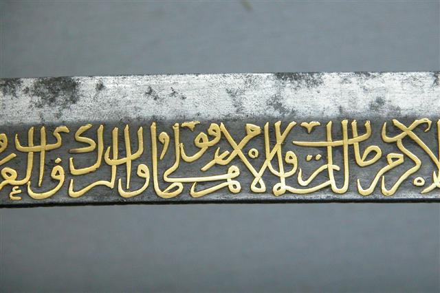

Here is a known 16th century example from Topkapi....
for me ...
the problem of Topkapi identification for what ever they show in display,
is subject at a lot of suspicions
when you see for instance;
- the wooden stick from Moïse, used by him to create miracles ...
- the wooden soup ban from Ibrahim (Abraham)
I doubt about their ability or their volontary to be correct ...
again 2 days ago (I still yet be in Istanbul) visited the Topkapi for the 4th time,
I was perplexed front to some identifications
à +
Dom
Old 14th December 2008, 09:12 PM   #14
Well, the items you describe, just like some other objects allegedly belonging to Mohammed are strictly religious artifacts and as such are beyond any fruitful discussion.
This does not mean that many other objects ( swords included) related to the merely mortals are misidentified to a degree greater than in many ( if not all) other major museums.
