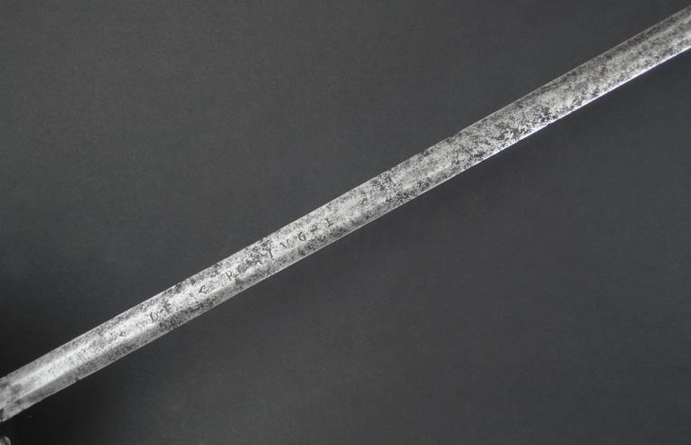

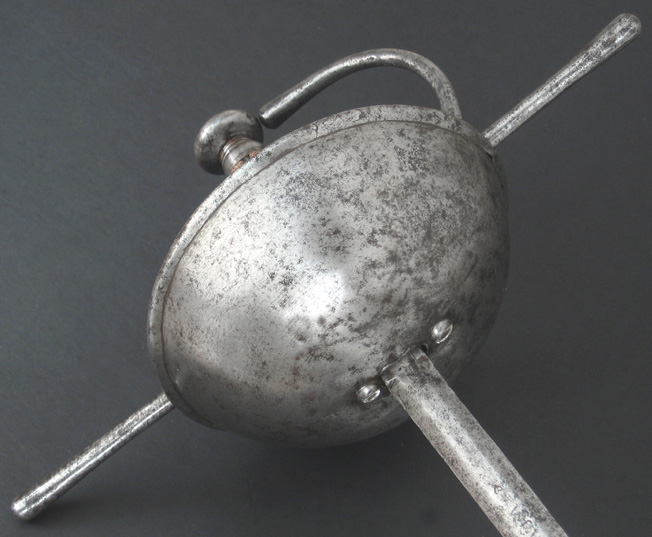

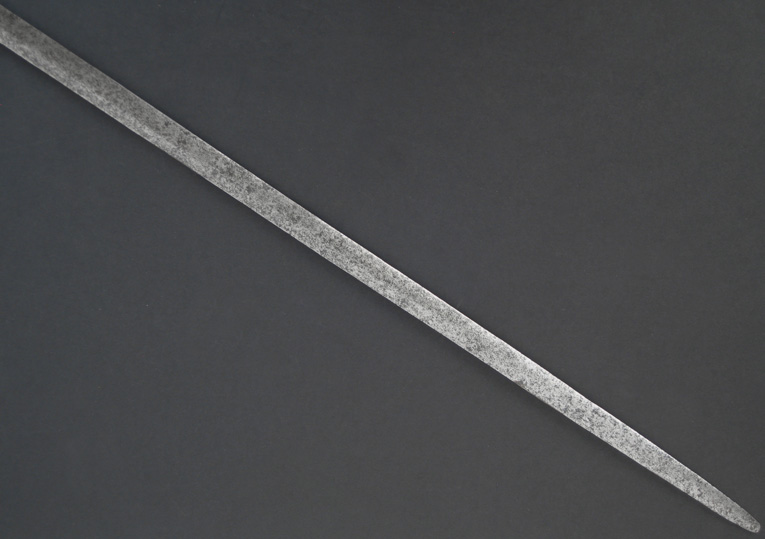

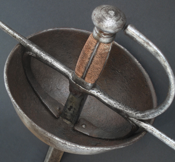

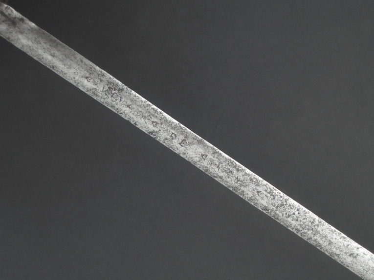

This one will be home for Christmas.
Blade 98 cms (38 1/2").Total length 114 cms (45"), which makes it almost two inches "off mark" , as the allowance was five palms (110 cms=43").
Blade width 20 mm (3/4") which, together with the particularity of the knuckle bow not being fixed to the pommel, makes it fall into the civilian rapier typology.
The huge cup bowl is 16 cms (6.3") wide, which is the largest cup this seller ever sold.
Attributed date around 1700.
Slightly faded inscription on the blade reads in one side VIVA EL REY and on the other DE PORTUGAL. However the (Spanish) seller opines that this sword was made in Spain, for a Portuguese order. I am asking him on what he is based to think so.
Maybe we end up with the Iberian interpretation
Fernando

Its a fabulous sword Fernando,
And a four posted grip like my rapier! Length seems fine to me, great condition!
I'd have placed it a little earlier than 1700! Its certainly another fine beauty for your collection! Have you won the lottery recently? ;-)

Hi Fernando,
I agree with Gene, this is truly a beauty! and I would think of it probably c.1680 to about 1700. It is exactly the kind of weapon I like, more of an arming type sword, and I'm inclined to think these more austere examples were quite possibly military, usually infantry if I am not mistaken. I always look forward to Marc's comments on these In Norman, the author notes that he is not aware of any military portraiture with the cuphilt being worn, which is primarily the basis for the observation that these were not used by the military.
The wrapped wire grip held by four vertical posts I had always thought were more an 18th century military feature, however in going through the Wallace Collection reference, I found several Spanish cuphilts of c.1650 all with this feature. These were quite ornate, and of course seemed more civilian, which says to me that this four posted feature was not only earlier, mid 17th century, but civilian as well.
In looking at A.V.B. Norman ("The Rapier and Smallsword") this cuphilt form is shown as #100, and as c.1630 to 1700 or later. The pommel on your sword is the same oblate shape seen on this form, but without the prominant capstan. In Norman, #101 is also cuphilt, but with deeper cup, without apparant rompepuntas or rolled edge on the cup and the quillons are without finished terminals nor central bulb on the knucklebow.This form seems to have existed contemporarily in the same periods, and it would seem this example is rather between the two.
I'm curious what indicator tells that this was made in Spain for export to Portugal, other than the inscription, which seems like it could have been made in Portugal as well. It is curious there would be no makers mark, just the inscription.

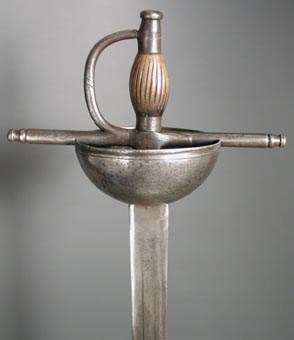

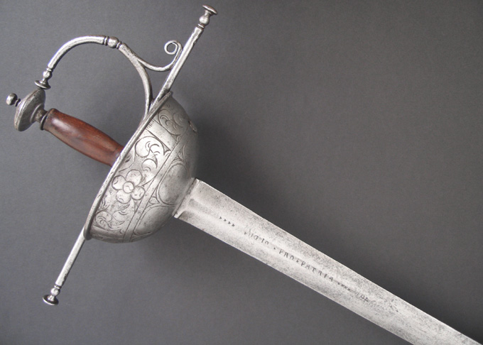

A beauty. It remembers me the style of rapier Marc uses on his avatar. Yes, a portuguese model, but no security about where was it made. Just look at this entrance on the catalog in the Museo of Lázaro Galdiano:
http://www.flg.es/ficha.asp?ID=7414
does it recalls you something? Tough, the hilt is different.
Un abrazo
Gonzalo

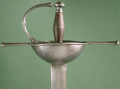

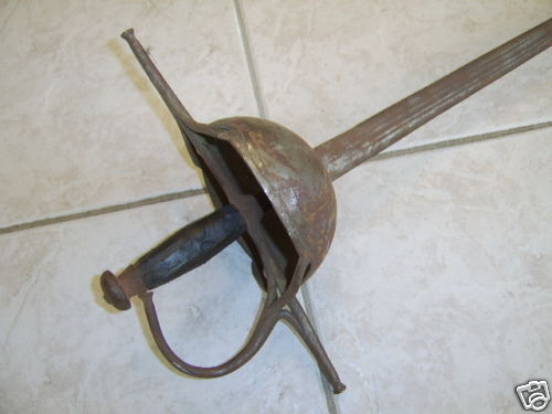

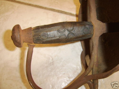

Fernando: Congratulations, a wonderful piece - I have been looking at that sword since it was put up for sale and was taken by it, especially its truly oversize cup hilt.
Here are three photos of broad bladed swords fitted with cup hilts. I believe that some of these were clearly military, from the 1600s on, towards the late 1700s.
We have to keep in mind, that before the adoption of regulation patterns towards the end of the 18th century, there was relatively little uniformity in side arms in most European armies and that anything could have seen service, whether from choice or necessity, as in the English Civil War when civilian rapiers were pressed into use Also, that many swords were re-hilted over the years and it can be a devilishly difficult task to assign a definite identity to some.
Cheers

Hi Gonzalo,
Thans a lot for your words, the picture and the excelent link. I didn't even know about the existance of this museum. I will have to go through all 509 items relative to Armas y Armaduras.
You have surely noticed that there is a misspell in the legend the museum quotes to be engraved on that blade; they write VIVA EL REY DI PORTUGAL, whereas it should be DE. Maybe the misspell is not in their tag but on the blade itself; this sort of errors was often found on blade inscriptions, specialy if they were imported. Actualy Portugal could also be found written with a V instead of an U, which happens to be the case of my example; i only noticed that when i had a second look to the pictures, as the seller has wrongly spelled it with a U.
Saludos cordiales

Hi Chris, thank you for your kind words.
So you were also watching this piece?! I thaught i had to make a quick decision, as usualy this type of swords gets acquired in no time, at least in this web site. Actualy the other day i saw one of this kind and when i contacted the guy to start negotiations, the sword was already sold ... this within a couple days. Amazingly it was a specimen similar to the one you are posting here in the first picture ... or even the very one ?!.
Thank you for the pictures of three examples of broad bladed swords. It might be that they were military ... or not. I humbly agree that the definition of such and such sword being civilian or military is not an easy task, even after regulation took place, to a certain extent. But naturaly things are taken by their generic, or majority, or statistic aproach, to allow for some points of reference. We all know that the rapier, having been conceived for civilian purposes, like (street) fencing and so, was also used by military; i have read that, for instance, they were used in India and thereabouts by Portuguese rank (noble) soldiers... often en suite with the left hand dagger. But coming to a general manner, military ordnance swords had a broader blade, less or no decoration, and knuckle bows fixed to the pommel, to increase their strenght in battle.
Within this reasoning, the sword in the third (last) picture might have belonged to some civilian aristocrat; could even be Portuguese, or for a Portuguese customer ... who knows ? Besides that fine decoration (and the loose knuckle bow), the legend engraved on the blade, PUGNO PRO PATRIA, was (at least also) often seen in Portuguese swords, in allegory to national independence achieved in 1640, after the Spanish Philips period domain.
Forgive me if i said too much nonsense; i was sort of think aloud .
Fernando

Default "Pirate" rapier on eBay
Alas, I was outbid... Very nice and affordable, too.
eBay #170278679255. I was wondering if someone could post the pics of this one for me? I'm clueless when it comes to posting pics.
While not as nice or in the same catagory as that sweet example you picked up, Fernando ( )(Envy!!), I like these Caribbean/ Spanish Main type swords. They border on a form of "folk art" in a lot of ways. One very similar is pictured in Brinckerhoff's "Spanish Military Weapons", plate 125/126. Guide says ca 1700, but I'm thinking more mid-18th for this example? You will note the crescent moon-shaped markings on the grip. I've seen this on some of the Brazilian espada cutlasses before and other Colonial Spanish pieces.
Jim, I think we'd talked about this crescent design in the past as far as the connection with various Spanish ports of call, such as the Brazilian coast and Salee, but perhaps my mind is wandering?? These same markings turn up on Berber sabers as well, and as I know Morocco had many connections with Moorish Spain and Spanish shipping, I wonder if there is a connection. In any case, I'm in a state of mourning from missing out on this sword...

Old 22nd November 2008, 11:59 PM   #29
Here Mark.
Old 23rd November 2008, 02:22 AM   #30
M ELEY
Location: NC, U.S.A.
Posts: 2,236
Thanks so much, Fernando, and congrats on your Christmas gift!
