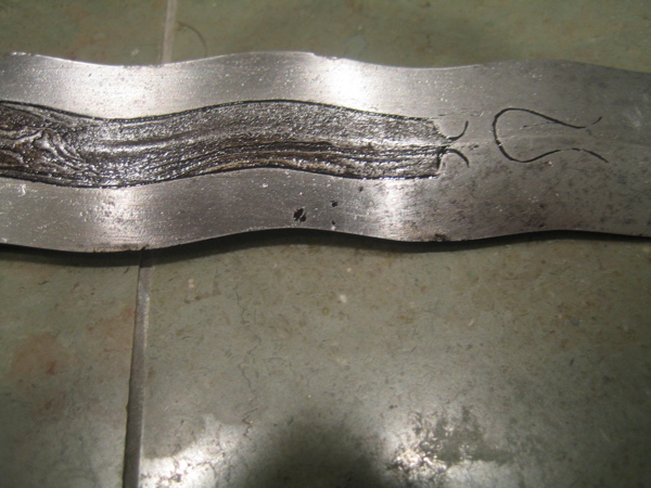

I just got this Kris with a center that resembles pamor.
All comments appreciated.

Would love to see a close up of the pamor area .
Old 3rd June 2005, 02:11 PM   #4
VVV
VVV's Avatar
Posts: 1,637

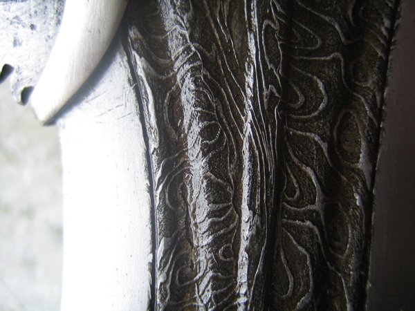

Rick,
Here is a close up.
Thanks,
Old 3rd June 2005, 02:33 PM   #5
Posts: 6,441
Exclamation WOW
Really topographical , nice !
Is there any possible way this could be a wax resist etch ?
I doubt it is .
Quite a complex pattern .
Beautiful Michael .

Very nice kris it strikes me as an early to mid 20th century sword 1920-40? It seems to be of excellent quality! I must agree with Rick that the pamor is wax acid etched and not mechanically forged. The baca baca are very well done but I have noticed on original older kris prior to 1910-20 that the baca are of one piece construction rather than two separate pieces as in the one pictured above but this is my personal opinion of course.

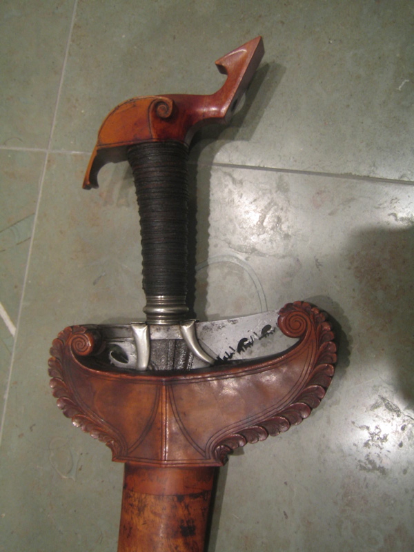

Michael, Could you give us more close ups of the sheath & the hilt? The blade certainly is 19thC & the over all appearance is so pristine, one has to wonder what was original & if anything has been altered; sometimes the problem with doing too nice of a job cleaning, you remove the "age". Michael, what is your impression of the sword & sheath, what appears to you as being receint work? When you look into the wranka (where the sword inserts) does the carving look receint? When you look at the top right corner of the close up you can see the structure of the metal continue past the cut of the fuller line. But the cut line is done so sharply, it looks as to have been done with modern tools. Could some sort of acidic paste been put on the center of this blade, that eat down into the pattern? This sword obviously has been taken apart & cleaned, I suspect the fuller work was done then, etched, edges polished & the hilt re-wraped. The sheath also is in such good condition, is it recient or just so nicely cleaned; no age cracks or signs of wear. The horn tip is unusaul, more like Sumatra work, but then again there is no end to the uniqueness of Moro pieces. If things have been altered on this sword, the person who did them, knew what they were doing.

The horn tip is unusaul, more like Sumatra work, but then again there is no end to the uniqueness of Moro pieces. If things have been altered on this sword, the person who did them, knew what they were doing.[/QUOTE]
I must agree with bill the scabbard looks to be Indonesian in style to me. Could you post a close up of the hilt? This could be an older kris that was reworked at a later date.

I have the feeling this is true pamor, and not a wax resist. If you look at the blade tip, there are spots that look like there maybe lamination. My sneaking suspicion is that the center panel may have been restored in Indonesian fashion using arsenic, hence the odd coloration and deepness of the etching. Strong tophographical etch with citric acid, followed by arsenic. However, even without the arsenic, I have seen similar effect/pattern in other kris/budiak/etc...

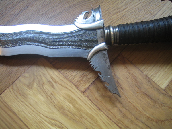

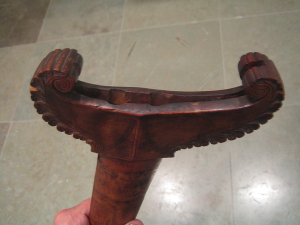

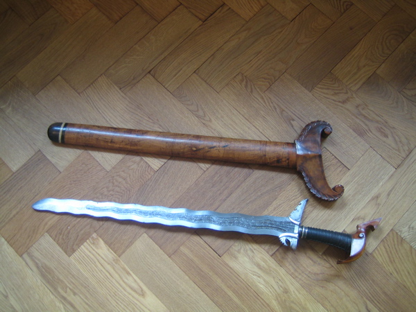

Thanks all for your comments on this Kris.
I have enclosed 2 additional pictures on the hilt and the wrangka.
It's not as perfect as it looks and I believe the sheath is original or at least quite old.
The hilt has been broken and reglued. And there is minor damages on the sheath from wear. It reminds me of the feeling of well restored antique European furnitures.
I suspect that it has been brought to Europe a long time ago and been kept for display. And somebody restored it very professionally before I got it. Maybe somebody who usually restores European antiques?
The center resembles Balinese pamor, except the topography.

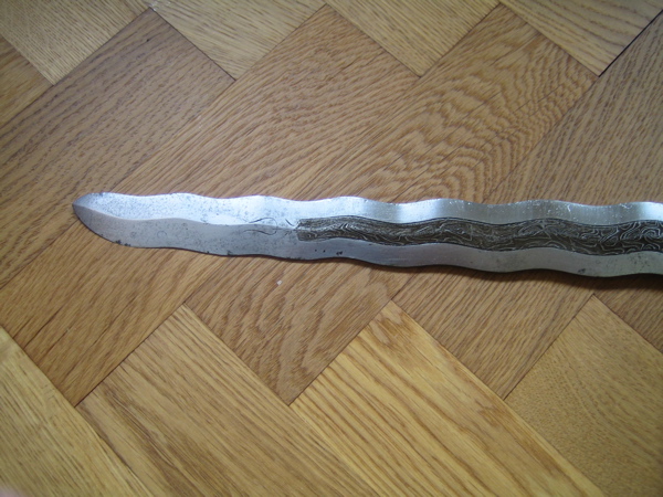

Michael , could I ask you for a close up shot of the area where the patterning ends near the point ?
Also has anyone else noticed the pronounced taper of the blade , or is that just a trick of the camera ?

You posted the scabbard and hilt pics while I was writing and I must say that looks like genuine old patina .

Sure Rick,
Unfortunately it's late here now.
This was the best I could do with the light.
Maybe I should try again tomorrow with daylight instead?
Thanks,

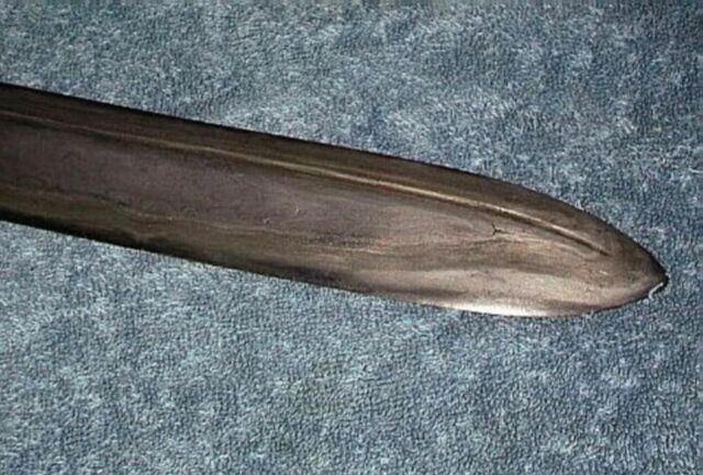

This is no wax resist ; I think that if it were etched (please don't) it would show an added on edge of regular laminate much as my budiak has or this sword :
Old 3rd June 2005, 10:18 PM   #15
Lew
Lew's Avatar
Location: East Coast USA
Posts: 3,191
Originally Posted by Rick
Michael , you're great !
Pictures on demand !
I stand corrected!

Thanks for the additional pics. The scabbard does look old & a Sulu look to it. Is the extended piece of the hilt new?, it looks like there is a hole in it for a wooden dowel or screw. The pattern looks genuine, but how was it etched so deeply. seems that something was left on it for days or even weeks to go so deep.

Bill,
The grain on the reglued part of the hilt matches the other.
It looks like it just broke off.
The hole is more like a small dent. Similar to where small stones could be attached.

Hi Lew , when I first wondered about a resist I was wondering if the pattern itself was drawn in wax . Now I'm thinking that the smooth edges were the resist covered area and the acid was allowed to work on the center panel to bring out the patterning .

Any old kris sundang I've ever handled and examined in person seemed like san mai type lamination. Just saying......
That one closeup looks distinctly like faked pattern, but if so it lacks the usual mistakes that prove so, and it does seem to "run off" the edges of the center panel a bit, as real pattern might do.....I would mention that lam lines in the other part of the blade don't mean much as to faked/real pattern; most old blades with faked pattern are folded/laminated, just not interestingly/complexly.

I have the feeling there was not a wax resist done. If you look at the transition border between the polish and etched area, as well as the lamination hints in the tip, there is a raggedness that is very consistent with after the fact polish vs a more precise wax resist. Also, the polish of the rest of the blade has a very odd grit look, not really typical to these pieces. Looks like an aggressive modern stone vs older pieces. I dunno, hard to explain, Ive just polished enough of these swords to recognise the look.

I'd like to add concerning the idea that the pattern could be faked, that the way it seems to go linear and lose its complex pattern toward the end of the etched area seems to argue for it being real.
