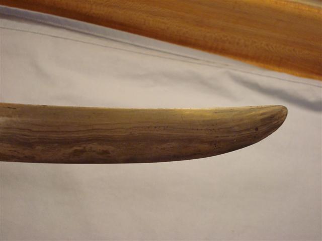

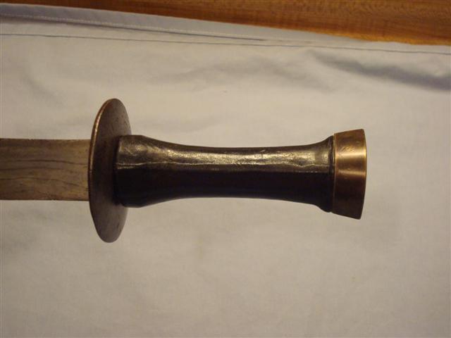

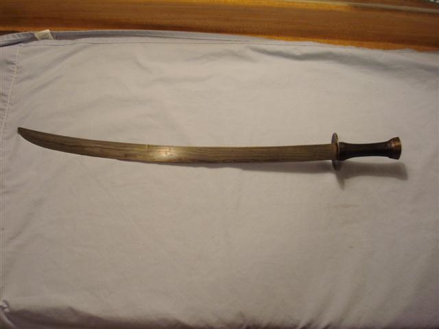

This is an unusual piece to be purely Tibetan so thought it would make an interesting discussion piece. The hilt appears classical Eastern Tibet in style, but with a saber blade as opposed to a straight blade most typically found on Tibetan pieces. The blade exhibits very nice lamination, not unlike Tibetan swords, but the pattern flows through to the tip versus having the classical hairpin turn. You do find Tibetan style hairpin lamination in swords from Assam and also Bhutan. The blade has an unusual false edge about 8-9 inches from the tip which is atypical for Tibetan. It has been hypothesized that perhaps this sword may be from a border group in the corner of Tibet, Bhutan and Assam. Would certainly help explain some of the non-Tibetan features of the blade. The sword feels fantastic in the hands and has an extremely hard and sharp edge so it was meant for business. Thoughts?

An interesting hybrid. I would say the blade profile is more Indian than Chinese, so a more southern provenance or origin makes sense (at least to me). Is it possible that it is a re-profiled straight sword, made by grinding out along the spine and at the tip? It seems to me that the grain doesn't exactly follow the curve of the blade.

Hi Mark. It is not a reprofiled straight sword as the edge hardness/tempering goes all the way to the tip. An altered sword would not typically have that hardness/tempering remaining in the tip of the sword.

The hilt as you say is typically Eastern Tibetan, and is typical of what I have seen coming out of Qinghai. My guess is the saber is from the Kokonor Mongols.
The Mongols adapted many Tibetan styles, but LaRocca mentions that Tibetans recognized curved blades as typical of the Mongols. Given some time I can find the name for the saber type in the appendix of terms in the Tibetan arms and armor book.

A nice clean example of an unusual sword Rick!
Great Josh thinking, maybe I can help with the time factor and have a look.
There are two names that I can see within the appendix that may shed some light on this unusual piece.
The first is shang lang and the second is hu bde. The first refers to a single edged curved sword that the English would call a sabre, the second is a Mongol sword.

As usual, Rsword comes up with some of the most intriguing weapons I have ever seen! and this one is most definitely in that category. I honestly never realized that pattern welded sabre blades existed, though I would expect that sabres would certainly be favored by tribal groups such as suggested by Josh.

The Eastern part of Tibet seems to reflect in its swords much of the Bhutanese style, which I believe is most associated with this hilts basic form, though of course typically with the more ornate pierced steel motif. As always, it is difficult to assign distinct style and form to specific geographic region, but I have always thought of this shape as Bhutanese.
The profile of the blade on this sabre, is as suggested by Mark, most like Indian and seems to me very tulwar like, and truly beautiful in this well executed pattern welded blade with the hallmark Tibetan style hairpin turn.

It would seem that in its simplistic beauty, this sabre was likely produced for an individual of tribal importance, probably from lower border regions from Eastern Tibet to Sichuan and in the Qinghai province. If its age would support by close examination, it should be noted that the Qianlong emperor of the Manchu's (Qing) who was in power until end of the 18th century, very much favored Indian weapon forms and affectations in these times. Indian style became apparant in numerous Qing weapons, and I wonder if perhaps those more focused influences might have come into play here with a curved sabre with Bhutanese and apparantly Indian features brought together in tribal regions then under Qing dominion.
