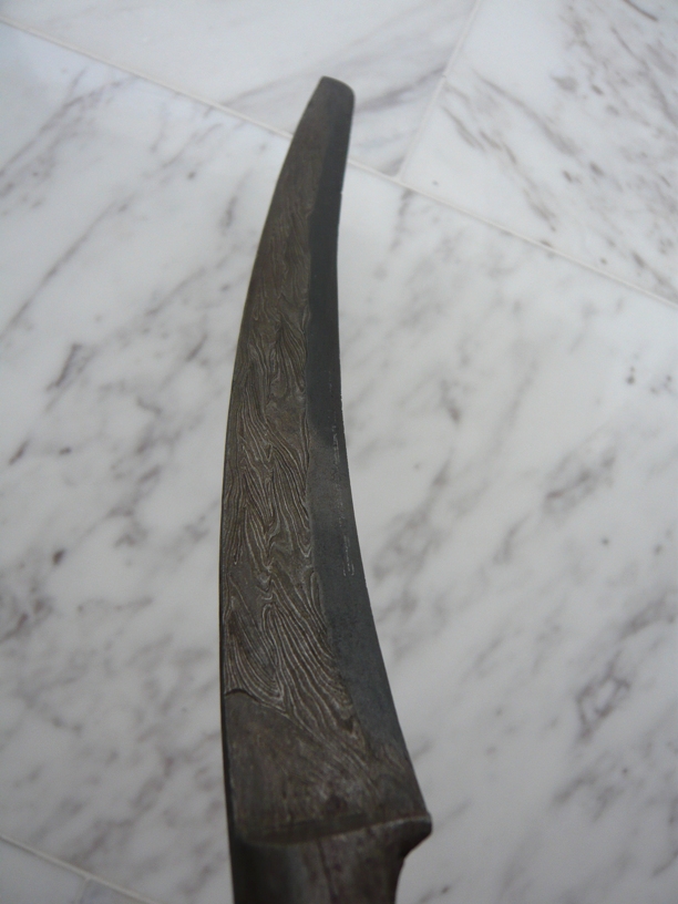

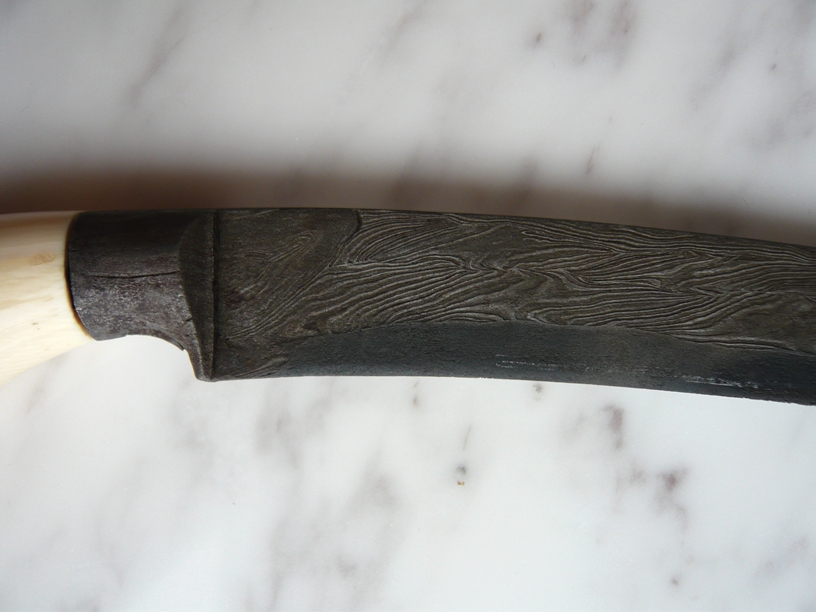

It's not every day that we see a sewar with pamor and an obvious temper mark.
This is a rather big sewar. total length in sheath is almost 16 inches.
Original sheath and hilt are made of black horn and wood, and hideously chewed out by some bugs a long time ago. Here's the new dress, based on the old sheath and hilt.

Hi BluErf
That is a stunning piece! I do not think that the blade has a true temper line it seems to be more like a hardened inserted or welded edge of a different material than the main body of the blade?

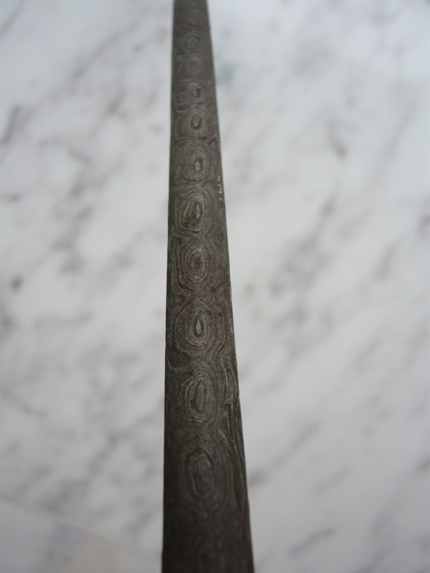

beautiful dress, lovely blade. I wince to see it etched so deeply, but if that is the style I can't hold it against the smith/owners.
Plain edge with two twist-bars for the body. Lots of work! lovely.

Thanks to everyone for kind comments. I love this sewar too.
Hi Michael - I thought the classification would be based on the shape of the blade, and not really the size? I have another sewar of similar proportions, but with a plain blade and nice old patinated wooden sheath and hilt.
Hi Lew - thanks for pointing that out. However, I always thought the extra black portion of the edge, running from 30% up the forte to the tip was a sign of the tempering. The metal at the edge looked rather homogenous, except for the extra black shade, which turns out with etching.
Hi Mr McCormack, nice to hear from you. Unfortunately, kerises and other blades in the Southeast Asian context are often heavily etched, or even 'cleaned' with acid, resulting in rather corroded blade. Yes, the results can be quite upsetting to blade-lovers, but I guess that is part of the culture here - everything has a lifespan.

[QUOTE=BluErf]Thanks to everyone for kind comments. I love this sewar too.
Hi BluErf
The hardened edge on your sewar does not exhibit a continuation of the pamor that we see on the rest of the blade. A temper line forms when one quenches a mono steel or pattern welded blade in oil or water this forms austinite or martinsite along the edge which appears as a temper line. Maybe one of the smiths here can explain it better than me?
Lew
