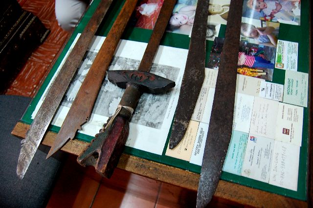

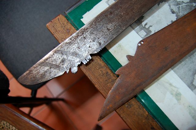

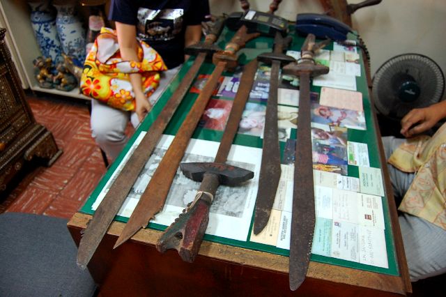

Following Spunjer's tip on which shop to check out in Manila for good Moro pieces, I got to see the other day the five kampilans below.
Can I please request for your usual kind comments and suggestions on which one/s should I buy? Let's say if my budget is good for just two kampilans, which two would they be in your opinion?
We are not after a consensus obviously, as it's understood that there's also subjectivity involved.
Hope you can give feedback!
Here's the first set out of four sets of photos:

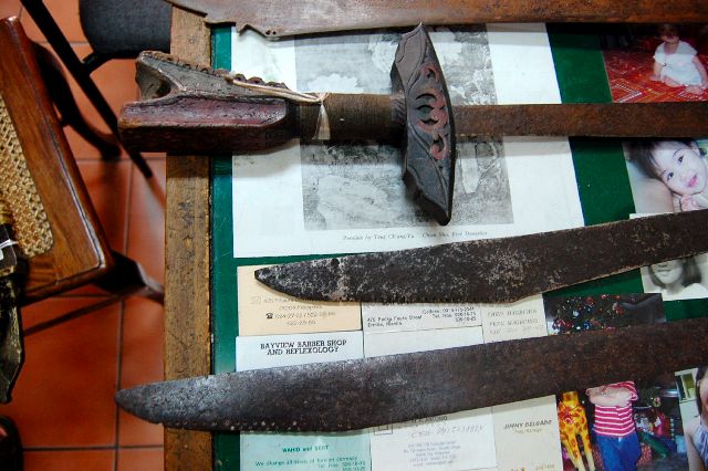

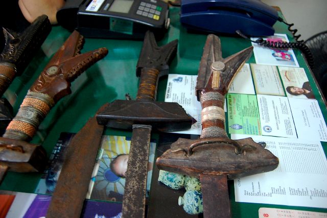

Second photo set of four:

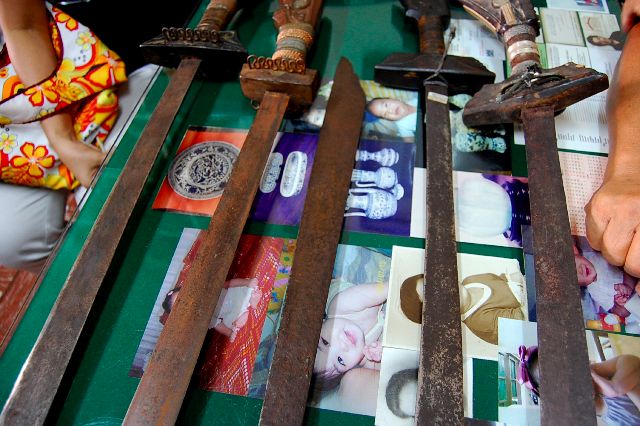

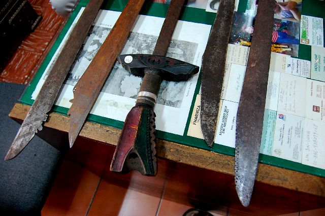

Third photo set of four:

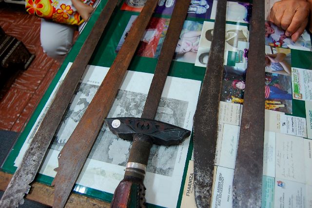

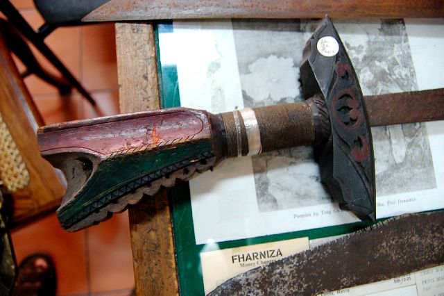

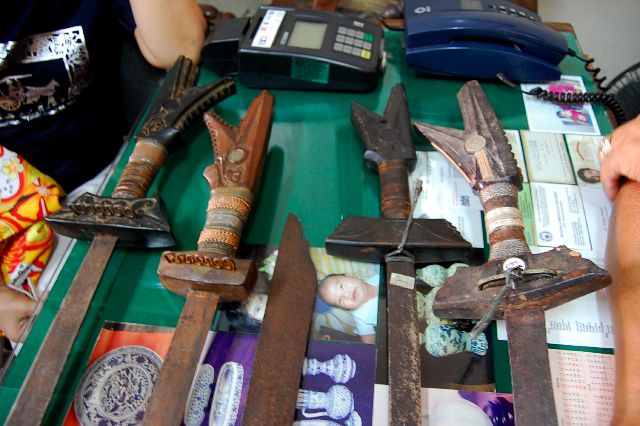

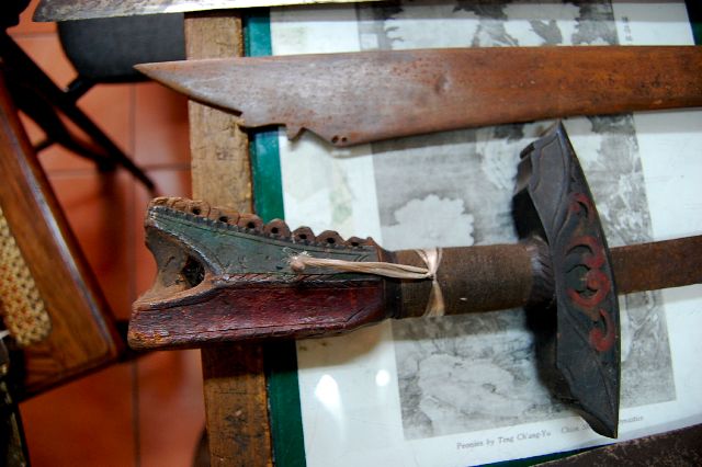

Fourth photo set of four is found below.
So which would be the top two pieces you can recommend? Remember, we are not after a consensus here ... so please feel free to give your own views.
Thanks again!

IT WOULD APPEAR THAT YOU HAVE MADE THE SELECTIONS I WOULD HAVE. ALL OF THESE MAY HAVE BEEN MADE FOR THE TOURIST MARKET BUT IN THE EARLIER PICTURES THE 2 TO THE RIGHT ARE OF BETTER WORKMANSHIP, THEY ARE ALSO THE TWO YOU PICTURED LAST. THE ONE WITH THE COIN FOR AN EYE AND THE SILVER WIRE WORK AND ATTACHED PANNELS OF SOMETHING IS THE MOST ATTRACTIVE. I CAN'T TELL FROM PICTURES IF THE BLADE OR HANDLE IS AN OLD ORIGINAL OR NOT BUT DO SUSPECT THE COIN, WIRE AND ATTACHED PANNELS ARE ADD ONS IF IT IS AN OLD ONE. THE OTHER ONE'S HANDLE LOOKS OLDER BUT IT ALSO LOOKS LIKE IT MAY BE ARTIFICIALLY AGED. BEARING IN MIND ALL THAT CHECK BALANCE BLADE THICKNESS AND IF THE WORK LOOKS OLD AND THAT SOMETHING IS NOT JUST A BIT OFF TO MAKE YOU SUSPICIOUS. THEN IF YOU LIKE THEM AND CAN GET A GOOD PRICE ON THEM GO FOR IT. EVEN IF THEY ARE OF WW2 OR LATER MANUFACTURE IN 100 YEARS THEY WILL BE GOOD OLD ONES.

Look for good flex in the blade; check the taper of the blade looking down the spine; it should taper evenly to almost wafer thin at the point .
