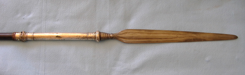

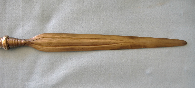

Here is a nice Filipino spear I recently picked up. It is just over 7ft., though my pics concentrate on the spearhead.
At first glance it seems to say Moro "budiak", and features a nice, clear lamination pattern, but there are some features to the bolster and ferrule that are making me second guess its Moro origin. Didn't the Bogobo and T'boli use similar types??
Comments, opinions, and info welcomed.
Thanks!

Thanks Rick. I would have expected to see brass work on Bogobo or T'boli pieces.
Somehow, though I did not want to be too quick to put a "Moro" stamp on mine.
Thanks again!

Moro ferules are different. Have you tried doing a little cleaning on the brass? I had one that really looked brass or bronze, but it was some kind of varnish or shellac that had been on it a very long time. When I did some cleaning (paint remover) a really nice silver came through.

I can understand that; the ferrule seems more Indonesian in flavor .

Thanks guys. The ferrule is silver. The flash may be creating a "sepia" tone making it look brass.

Thought so. Good! Nice spear BTW anyway you look at it.

I had a Moro budiak spear liked this one including the ferrule style only made of brass/bronze. I have seen old pictures of Moros (Maguindanao) with ones just like this in style. This is not lumad IMHO but Moro.

Found the picture - it is on p. 194 in A Philippines Album . The spear is on the left and the style of textiles are Maguindanao I am told. The caption does read that the picture is from Mindanao (please ignore the false hand tinted color).
VVV - I suspect that yours might also be Maguindanao.

btw, charles, yup, that's a moro budjak..

What are the specific features that denote its origins....the bulbous, rather then banded, nature of the ferrule??

I would say yes. I need to go back to my research, but for now I am inclined to say that the banded "bamboo" looking ferrule sleeve is more Sulu. Bulbs at the top and bottom of the sleeve would be Maranao as far as I can tell. The picture has Maranao textiles with it.
BTW - great spear - with silver no less......
