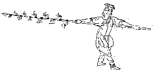

I'm looking for pictures and/or more information on a weapon called the lang xian in China and the Nangseon in Korea. This is an old pattern from the Ming (c. 1560) and Joseon (c. 1598) dynasties respectively.
It's described as a "thorny spear" or a "multi-point bamboo spear." I've attached a picture from the Muyedobotongji, a Korean martial arts manual, and it's the only information I could find.

There are some examples listed in the Huangchao Liqi Tushi, but I have never seen an actual one. I have the vague impression they have a long history, but I don't know it. My understanding is they were developed to imitate bamboo, which could be used as a screen for arrows as well as a way to tangle weapons.
I have only seen the old illustrations.

Since the weapon's basically a spear tip on a piece of real or imitation bamboo, I'm beginning to speculate on the design. Perhaps the way you make one is to take a bamboo stalk, and rather than cutting all the side branches off to make a smooth shaft, you deliberately leave some of the side branches on as sharpened stumps? It would be relatively easy to make, so long as you chose your bamboo well. Moreover, sharp bamboo points would definitely tangle and cut, especially on poorly armored targets. The weakness of such a weapon is that bamboo tends to shatter, so if it failed, it would fail catastrophically.
I'm still hoping that one of the Korean revival arts, such as Muye24gi, is using the nangseon, so perhaps there's a picture somewhere?

Thanks for the pic. It's like the earlier one (of a nangseon) except that it doesn't have the overt spearpoint. Thing that's bugging me about both of these pictures is that they look like bamboo, with the exception that there are two stems at each node, not one as in real bamboo.
Maybe I'm naive, but I'm still scratching my head about the utility of copying bamboo leaves and small stems in steel, and sharpening them. It could certainly be done, but that's a lot of work!
What I'd like to see, ideally, is a photo of a real one from a museum or armory. I'm curious if it resembles the illustration or not.
