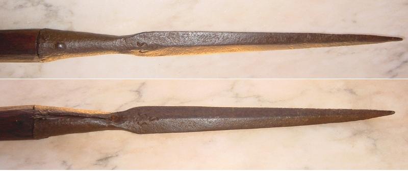

Default Would you call this a lance or a pike ?
I wouldn't mention spear, as we don't have a strict translation for such term in Portuguese. We currently say 'lança' for lance and 'pique' for pike. We also have 'zagaia' or 'azagaia' for assegai, but that's another story.

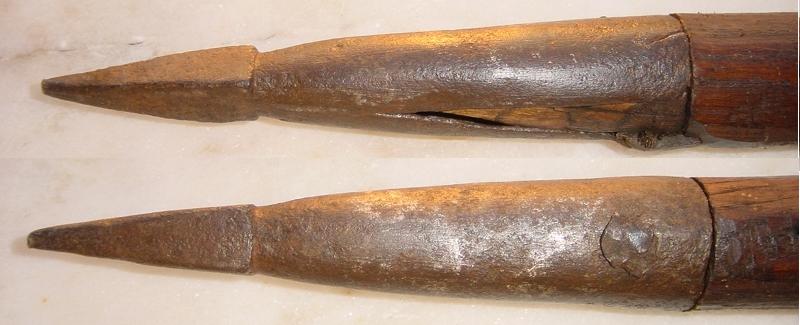

This piece was acquired by the seller in a mannor house in the north, where noble old places with coats of arms at the entrance abund. The house keeper said it belonged to the 'house defences'. So in principle this isn't a pike, but a lance, with a butt to stick on the ground, to resist a mounted atack.
The seller remounted it in a 1,7 mt. haft, made from old used oak.

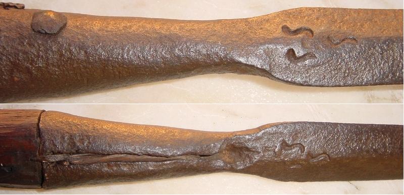

The triple S marks (symbols or letters) in both sides of the blade surely belong to owner ... probably a part of the house crest, or family name initials.
It is dated 17th century.

Fernando,
I would call this the remnants of a 16th to 17th century pike, thinking that the original haft was much longer. As you refer to its latest use, however, it may well have seen private re-use as a shorter lance in later times. Only one thing is clear: when the lancet iron originally belonged to a pike haft, the iron finial at the other end was not part of that original haft; it makes sense, however, in stabilizing a lance haft when put to the ground.
I also think that the S-shaped ornament does not refer to an owner. Telling by the deepness with which it was struck, the iron must have been warm and the striking must have been done by the smith, so I should rather identify it as a workshop mark in the shape of a stylized S. That might, but does not have to, mean that the gunsmith's name had the initial S. S-shaped ornament was widely in use in the Renaissance period alluding to snakes, sea monsters and the like.

Well, i was considering some points that lead in a contrary direction to that of these marks been the smith's own (or traditional) symbol (isms).
I place myself in those days where rural civilian smiths were not allowed to make weapons from their own willing, but only if they were comissioned by (big shot) clients, for their house defences or private armies.
In such context, how could the smith have the impertinency of striking such show off marks in both sides of the blade and, instead, not the client's symbols ?
I once had a sugestion (Rainer Daehnhardt) that these could be the initials of a family with houses in three different places ... or i didn't catch the correct sense.
I would also guess that multiple equal letters may appear in the construction of coats of arms, indicating various family branches; there are ancestral families with their names starting by an S, such as the Sousas and the Silvas.
... Not that the client couldn't instruct the smith to strike the weapons with 'public' symbolisms, instead of those from his private universe.
Concerning the piece itself, i can assimilate it is a pike later modified into such quoted house defence lance. I may even admit that the iron head and the but spike actually belonged to different weapons and the seller had the idea to join them, makig a composite from his imagination.
... Just wondering. In fact i allways go for actual names or representation marks, by default, and only consider esoteric stuff when supported by actual or consensual evidence .
