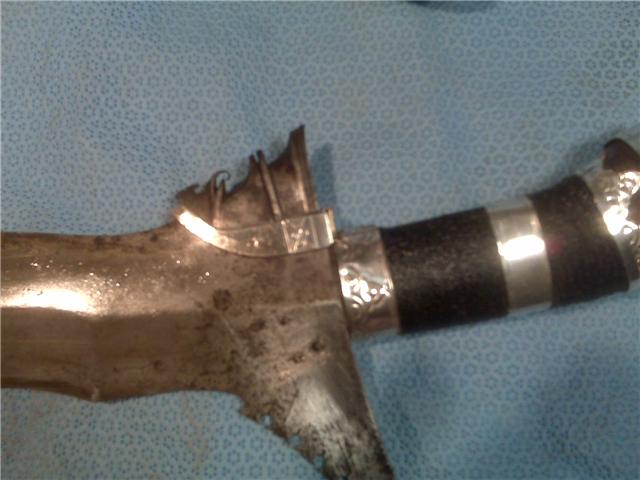

Since some have asked me in the past to share process, I thought I would here. The first pictures are of a kris as it came to me. It needed hilt restoration, a baka-baka clamp, and a large part of the scabbard was missing along with the wranga (top part).
Old 1st September 2008, 01:58 AM   #2
Posts: 7,370
I based the silver restorations on imprints I found on the hilt as well as the baka-baka.
The bigger process was the wranga. I had to cut a chunk of burled walnut from a log and carve it out. Then I stained it to better match the hue of the scabbard patina.
Old 1st September 2008, 02:00 AM   #3
Posts: 7,370
Finally, I took plain sheet silver and wrapped the scabbard, making silver bands and placing them on the scabbard.
Old 1st September 2008, 02:01 AM   #4
Posts: 7,370
This is the end result:

Here is the best picture I have of the baka-baka and hilt.
Steve, I am embarrassed to say that I am not familiar with your terms.
