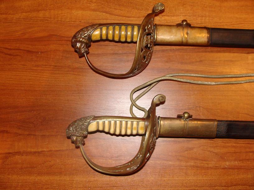

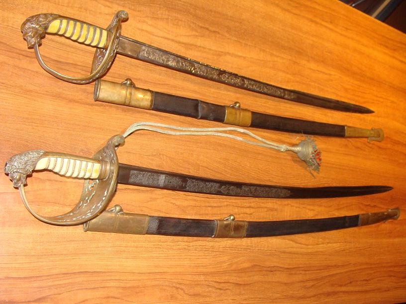

Here are a couple of rare interesting pieces of History, a pair of Dutch Naval swords I currently have and I thought I'd use these whilst I have them in my posession as a learning tool for us all.
Both I beleive date from the 1870's, have wire bound ivory handles with pipeback blades and etchings to these blades, they do vary slightly in length and are complete with scabbards. The images can tell you more about the item than my fingers at this hour of the evening.

Wow! Those really are beautiful examples Gav!
I have always liked those pipeback blades, very impressive.
It seems that Dutch weapons are relatively seldom seen in the collecting community, so it would be interesting to know more about these.
What are the inscriptions on the blade? makers ?

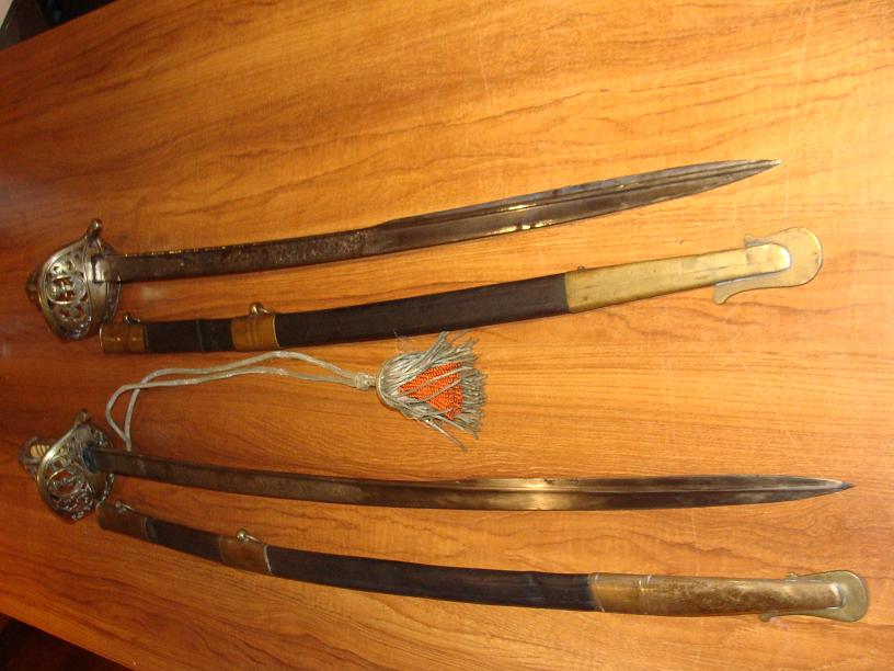

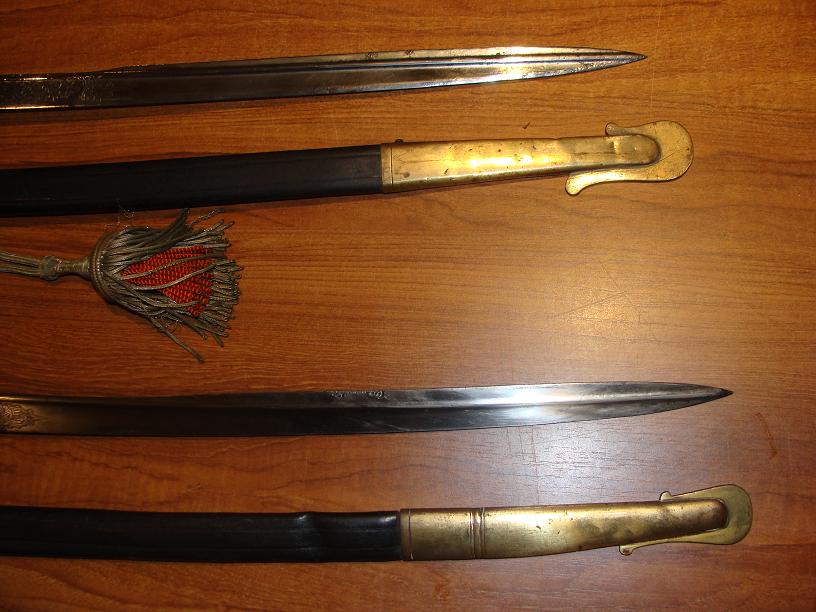

Just wanted to add some observations on these 'pipeback blades' on Gavin's two Dutch naval sabres. As I noted, I've always considered this blade feature most interesting, and it seems it occurs on Solingen made swords for Germany cavalry from about the 1870's.
In Wagner's "Cut and Thrust Weapons" these pipeback blades in which the rounded 'piping' becomes a ridge near the stepped point which seems to recall the famed yelman often seen on earlier East European sabres.
In Wagner, plates 13,18 and 19 illustrate German cavalry swords as noted dating 1879, 1889 and 1891 respectively, and two of the sword were by Geb'r Weyersberg firm in Solingen.
I wonder if that firm might have made these two swords?
It seems like these 'pipeback' blades were quite prevalent on early British swords, but later ceased about mid 19th c. on British sword blades. I wonder what brought these back on the German made blades?

Does anyone know whether there was/is a functional reason for the rounded spine ie the 'pipe back'. Smoother draw from the scabbard ? better 'parrying' control of an opponent's blade? Thank you

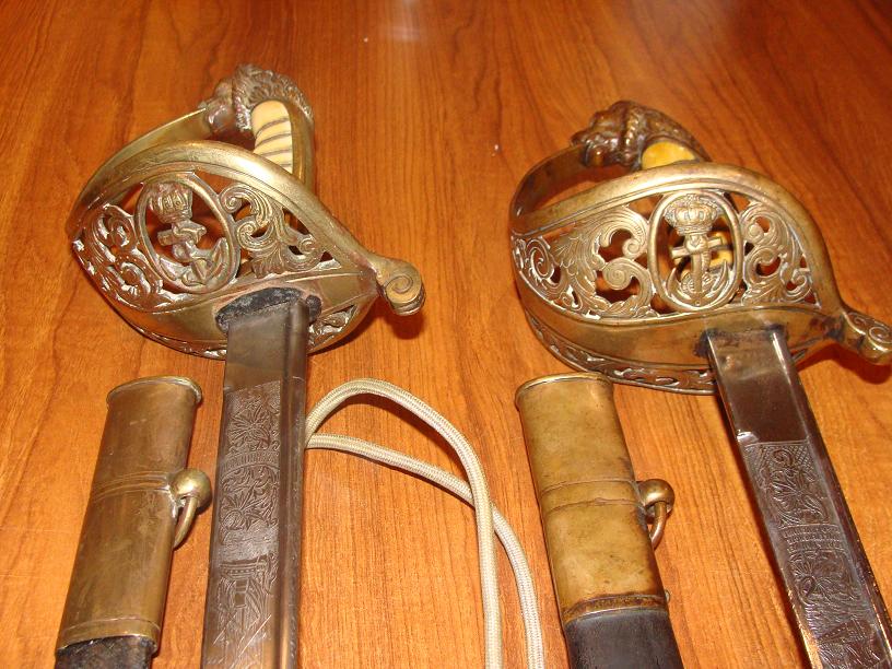

The markings or quality mark on these blades are "Yzerhouwer". They also sport floral engravings down the spine of the blade and on the blade too, also ships of the line and the famous naval fouled anchor.

I must say these little beauties have some quality spring in the blade and when pushed into the floor boards can easily bend to a 45degree angle and bounce back with some force, I am guessing the would pass the wire bound wood or iron bar test too.

These really are very appealing sabres, and that pipeback is indeed interesting. I can only imagine it was a strengthening feature David, and it was used a lot on British swords then discontinued. Like to know more on it as well, and wonder if other military swords used it.
