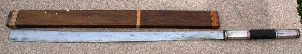

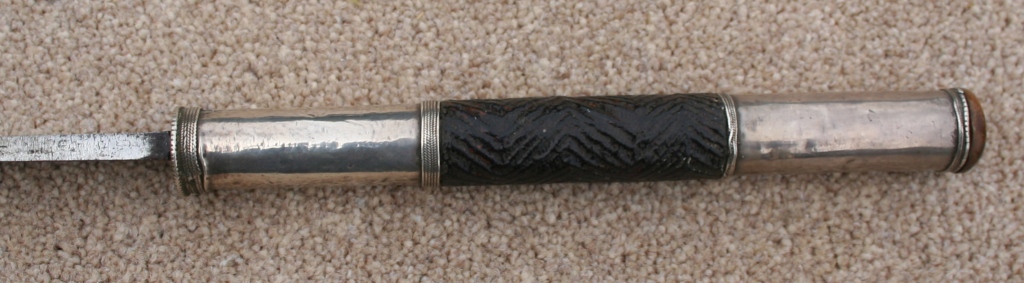

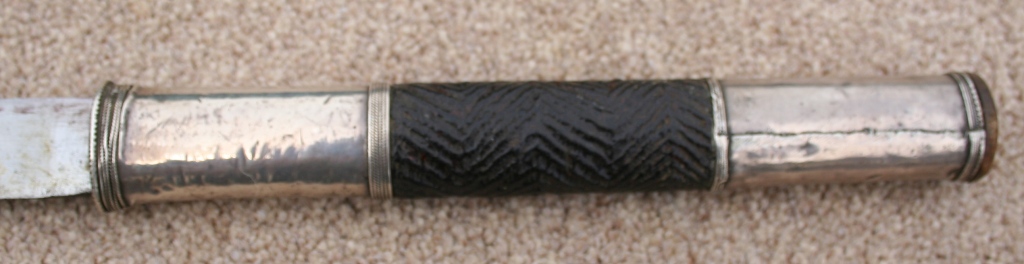

Does anyone have any ideas about this one ? I have always assumed it to be a Dha but have often wondered about the oval cross section of the hilt and the straight blade. Any info will be welcome.
Thanks
Royston

Dha with this style of blade are not uncommon. usually they are associated with the Kachin Look at sword 231 and 232 here
http://www.arscives.com/historysteel....swordlist.htm
Several others can be found on Marks index here
http://dharesearch.bowditch.us/SwordsFrame1Source1.htm
I have never seen one with an oval hilt but maybe others have or maybe it was originally round and was "flattened" a bit by something that happened to it

This is a Burmese dha, likely from one of the Kachin (Jingpaw) tribes.
The three part handle is very typical of swords from this region/ethnic group, as is the blade profile. Similar blades do appear on swords from other areas but, in combination with the handle, I'm confident in the Kachin attribution. The oval handle cross-section isn't common, but isn't unknown--I have one in my collection that I got from Mark.
Parenthetically, the laquered cord center section isn't very common, either. I've only seen it on two other swords, both of which are believed to be Thai. Obviously, this is not necessarily a Thai feature.
The scabbard looks like a later addition, not original to the blade, nor this type of weapon. Having said that, if the scabbard is original this, in combination with the oval handle, it may indicate a NW Burmese origin to this sword as it has strong similarities to weapons that form a "nexus" between Naga sword dao and more conventional dha.
Cool sword.

Gentlemen,
Thanks for the references, most useful.
The hilt was definitely made oval and has not been flattened. It is too uniform in construction to suggest some form of damage.
I agree with the comment about the scabbard being a later addition. It fits well enough to have been made for the sword but it does not look original.
Is there any evidence of trade between Eastern Naga's and Burma ? Is it possible that elements of weapons were copied from each other ?

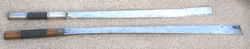

This just turned up.
It also has an oval hilt, but this time an open scabbard which perhaps the first one should have had.
Although a lot plainer than the one with the silver hilt, to me it looks more Naga than Burmese.
I think you were all correct to suggest the Naga origin for the first one.
