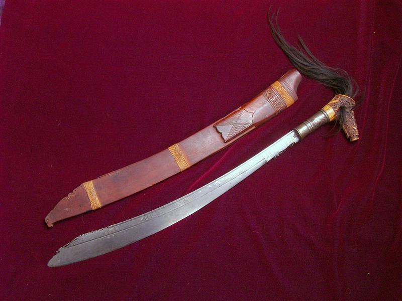

Henk I agree, Silver wire is also ok in my opinion. I once had one with silver or a silver alloy braided wire on a mandauhilt. See picture attached.
I still have one with iron braided wire which I know is iron because it is very rusty. The one I had on the pic didn't show any rust at all.
