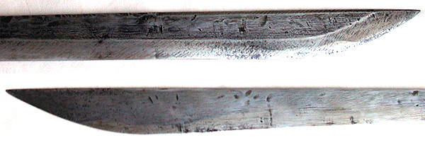

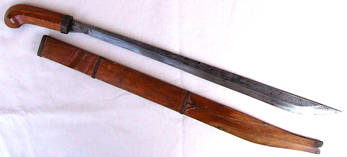

Default Another example -- sword length
Further pursuing narrow-bladed Visayan weapons that may be called pinuti, here is another one that I picked up a while ago. It is probably WWII vintage, judging from the old khaki-colored metal strips around the scabbard and hilt. These could be off old WWII ammo containers, which I have seen before on WWII era Philippine knives.
The hilt is one of those abbreviated kakatuas which are often found on the heavy, blunt-ended choppers from Panay, Negros -- binangon. The blade is basically a very skinny version of a tenegre. The edge is hardened, as seen in the pictures.
This sword is village quality in its construction, but does illustrate the pinuti theme.

Old 18th April 2005, 01:15 AM   #11
tom hyle
Location: Houston, TX, USA
Posts: 1,254
Interesting that the temper line does not seem to curve back to go all the way to the tip(?) I have a parang nabur with a similar feature, which is common on kukuri.

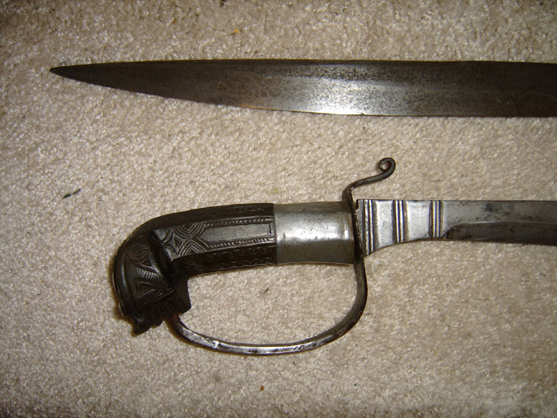

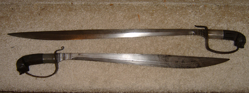

Old 18th April 2005, 03:12 AM   #12
LabanTayo
LabanTayo's Avatar
Location: Kansas City
Posts: 177
Here are 2 of my Tenegre / Pinuti

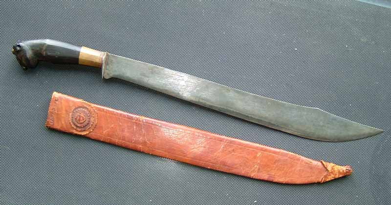

that's just it; i've never heard of "bonifacio" type sword until recently. whenever i see a pictures or sculptures(notably the bonifacio monument in Monumento, Caloocan city), of andres (bonifacio) weilding a sword, it's always what is comonly known as itak, nothing more. I wonder if this certain type (the "bonifacio") is derived from these pictures, or did andres has a specific type of itak? hmmmm....
Old 23rd April 2005, 04:51 PM   #19
Posts: 6,441
Arrow Bonifacio ?
This is what I understand to be a 'Bonifacio' bolo .
Corrections are more than welcome .
Old 23rd April 2005, 07:07 PM   #20
Posts: 4,745
Thanks Rick. That was my understanding too. Be interesting to see what other styles people think are also called Bonifacio.

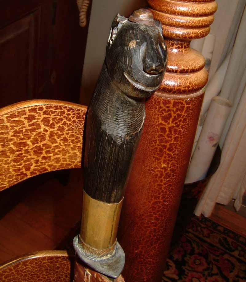

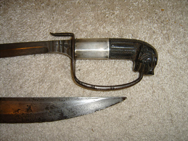

Old 1st May 2005, 12:42 PM   #24
tom hyle
Posts: 1,254
The doghead hilt on Rick's sword is sometimes seen on European machete blades. The usual attribution is PI. Thanks for the instructions on posting ebay links, Rick; one time when I'm less clouded I'll try to understand them; I may even succeed. For now, one such sword with a leather scabbard is ebay # 6527728238 (closed auction). I recently got an English Mole blade of very similar form mounted in a wooden boot type handle (usually considered Mexican; it's a Mexican style cowboy boot....), and in an identical sheath (including the suspension system) to the ebay one. Pancolonialism?........
Old 1st May 2005, 01:13 PM   #25
Posts: 6,441
It's not really a dog Tom .
It looks much more like the WWII era Elzie Segar cartoon character 'Jeep' from Popeye ; some of us older members might remember him .
But then if it is Span Am war era it could be more of a demon head of sorts , albeit a friendly one .

Old 1st May 2005, 03:18 PM   #29
Posts: 6,441
Smile Bonifacio
Originally Posted by tom hyle
I see what you're saying; I was going by the ears and thinking the rest fell under the category of stylization. Looks more like a cat, I suppose (the side view looks a bit like the Penn State cougar), or Eugene the Jeep (I recall it at least sometimes having said name I suppose that makes the Jeep male, but who knows what it is? It isn't quite a baby.....). The ears, if anything, are bearlike, but could fall within cat or dog pretty easily, I think. Are there bears in PI? I'd expect so, but don't know. Interesting work on the ferule. Is the guard iron then?
Hi Tom , after giving the spine of the blade a close look with a strong magnifying glass I've come to the conclusion that there is a center core with cheeks of steel laminated on either side of the blade . This is most evident before the clip begins . So this would be a san mai type of construction then ?
I believe the guard is made from the same material as the cheeks ; I drew a file across a small part of the edge of the guard .
