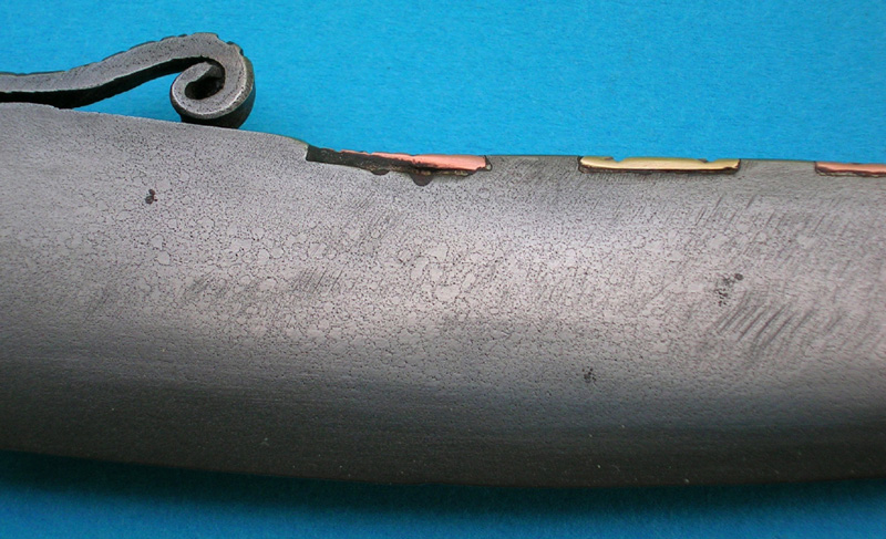

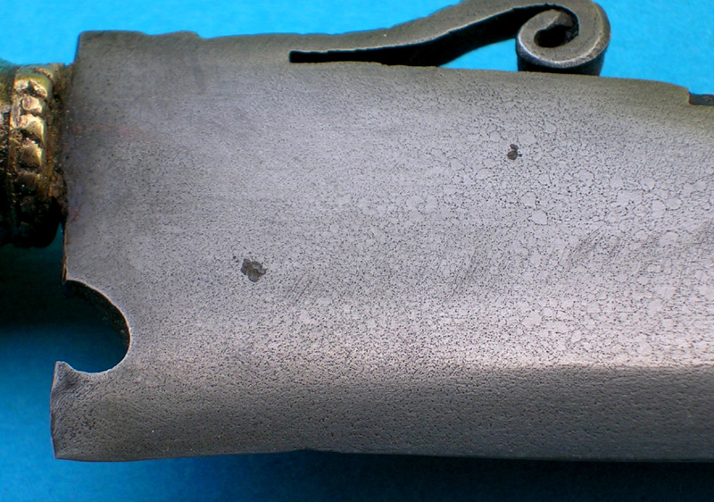

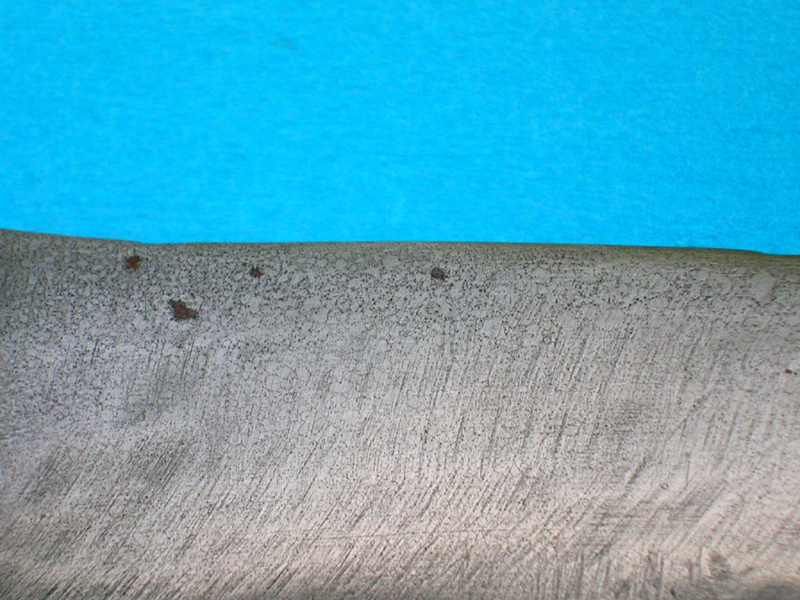

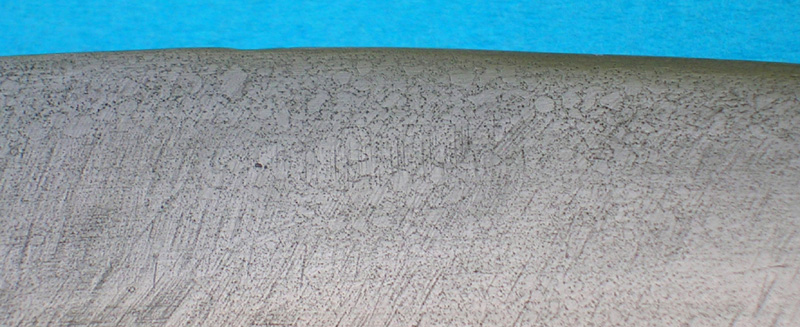

Hi all,
I have recently got this kudi tranchang. I etched (lightly) the blade and I found a pattern that IMO is nor pamor nor laminated steel. It looks to me like a not too contrasting wootz , but I must be wrong because this kind of iron be very unusual for this area and for this kind of tool/weapon.
May I have Your opinion ?
Thank You
Paolo
The pics of the blade close ups are the best I can do.

Hi Paolo,
Its a nice thing for sure! I'm not familiar with them, so I'm not sure how the steel/iron is produced.
So I'm just gonna throw some thoughts out there.
Could the steel be produced from a mixture of salvaged/reclaimed ferrous items which may result in a final product with 'hard spots'?
I know that this can be the case even with industrially produced western steel from recycled sources, I wonder if the larger 'spots' which look almost like a birds eye or raindrop pattern could be something to do with an accidental mixture of steel grades not completely mixing in the smelting process.
How oxidised was the surface before you etched it?
Is some of the pattern from cleaning out the pitting?
If you can remove the blade you could 'recut' an area of the tang to completely flat and polished then etch that area and see what pattern emerges?
Edit:
Do the wootz style patterns diminish where the blade looks to have been filed (As in where the surface has been cut back)?
Just been comparing it with bits of steel I've got laying around, sadly I've no actual 'wootz' but I've got some pattern welded.

Hi Atlantia,
Thank You for Your thoughts.
I try to give some answers. I received the kudi polished, with the trucks of file You saw, so I don't know the oxidation degree it had.
I looked under some patterns, so I etched the blade before with citric acid and then (only few seconds with a brush) with ferric chloride diluted 1 : 3 with distilled water (the spine has brass and copper inlays). I don't think that the patterns are dued to the rust (or pitting) removed (but it's only my opinion).
I don't want to remove the blade from the shaft; You are right when say that "... patterns diminish where the blade looks to have been filed "

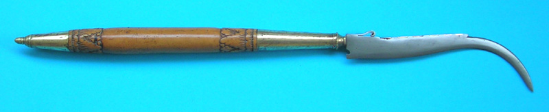

Its certainly an interesting thing Paolo, is it a weapon?
How long is is?

Hello Paolo,
That's not wootz. I suspect that this pattern developed from heat treatment of monosteel (this usually happens by chance).

Hi Kai,
I suspected it was monosteel, but I didn't know that the heat treatment on this kind of iron may cause this kind of (so wide spread) pattern.
Atlantia,
the kudi tranchang is 65 cm long (25,5 inches).
On Van Zonneveld book " traditional weapons of the indonesian archipelago" it is so described : a knife with a fanifully shaped blade and a long hilt, to which magical powers are attributed.

Old 1st July 2008, 08:43 PM   #8
katana
katana's Avatar
Location: Kent
Posts: 2,658
I remember seeing a sword with a 'wootz-like' pattern, Lew kindly re-educated me with the notion of shear steel, but this type of steel was mass produced late 19thC -early 20th C. It may be possibly 're-cycled' shear steel and forged into this interesting piece.
