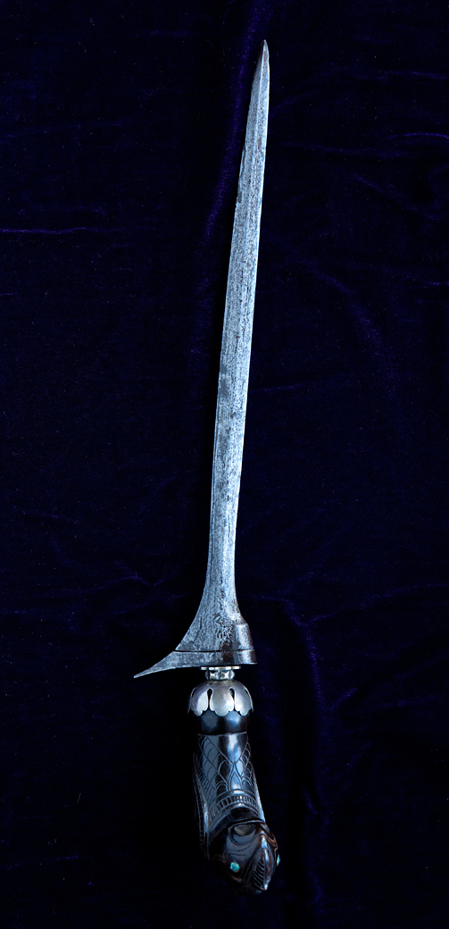

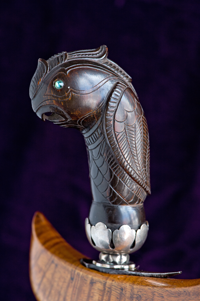

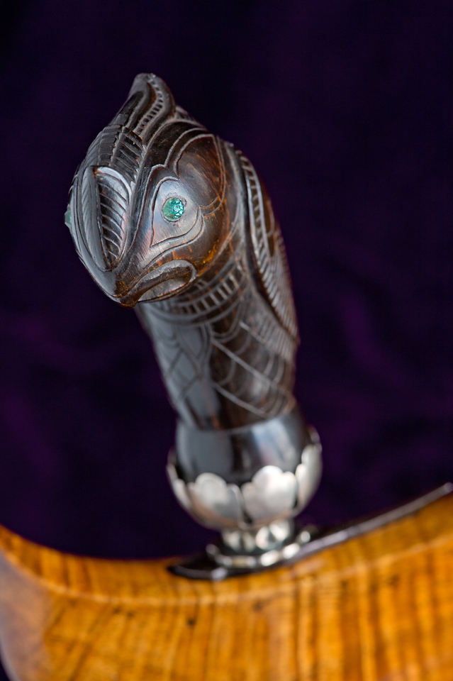

Things seem a bit slow around here so perhaps i can spark a little conversation with another mystery. Again, at least a mystery to me. I have shown this keris to another group of collectors and frankly the thoughts on origins were all over the place from Sumatra to the Peninsula.
Blade is just under 10 inches (25 cm.) with a very narrow profile. I have nicknamed it "needle" because of that. It get's VERY narrow at the waist (just about one cm). The blade has a bit of a diamond shaped cross section. Hilt is horn. The eyes in the parrot seem to be cut glass, but could be rock crystal. The pendokok i believe is silver. The flashing grain woods on the sheath are quite intense and beautifully arranged.
Some folks have suggested to me that this is an anak alang, but if so it is of a dhapur i have never seen on other blades of that category.
All comments are welcome.

Hello David,
wow, a real beauty. And like usual from you very good pictures.
My guess would be Peninsula, the hilt and the scabbard toe let me think like this. I have a very similar keris respective the blade shape in my collection, see here: http://www.vikingsword.com/vb/showth...hlight=panjang, post #40
The blade is as well like a needle.

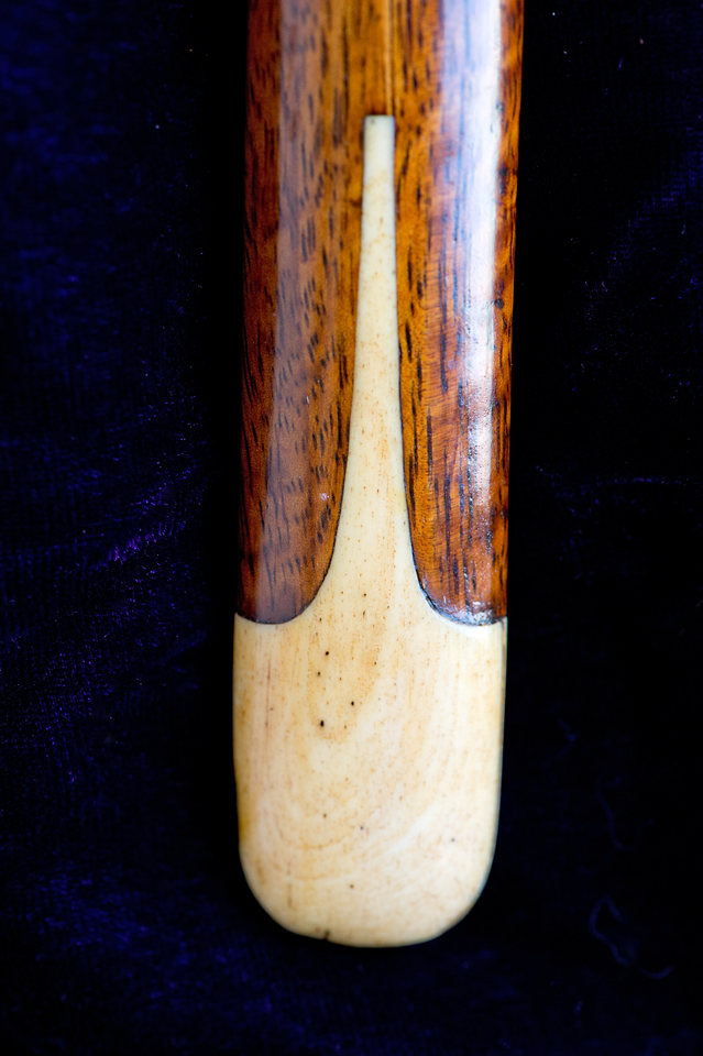

But wouldn't this keris of yours be from Sumatra? I do also find the parrot hilt a bit Peninsula like, but i believe i have seen Sumatran sheaths with this kind of toe before.
Anyway, thanks for your input.

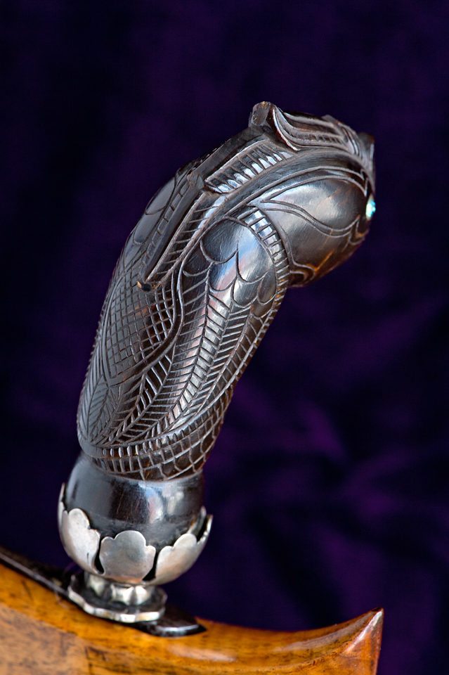

A very interesting and good-looking piece. I especially like the way the ukiran has been cut on the back; very neatly done.
As for origins, I'm not speaking from any position of authority here, but to me the dress looks very Malaysian, especially the pendokok. I don't think I've ever seen anything like that from Sumatera, but would love to see pics if others have!

Hello David,
Thanks for posting that beauty of yours!
The pendokok and hilt are classic Terengganu style and also the scabbard and blade suit this designation. I'd believe the hilt to be not antique - possibly post-WW2.
Very likely glass (very commonly utilised, even in antique pieces).

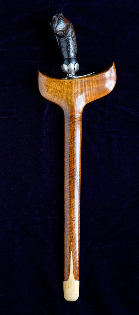

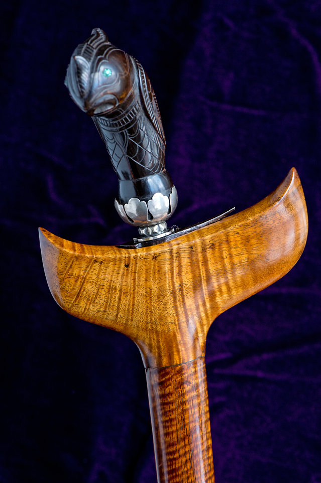

Yes, very nice wood, especially for a somewhat newer piece!
Some folks have suggested to me that this is an anak alang, but if so it is of a dhapur i have never seen on other blades of that category. :shrug
I'd posit that this blade was intentionally designed to resemble the Bangkinang family of blades while being based on a more generic keris blade design. A nice touch IMHO!

Actually I cannot see nothing typically Terengganu neither in hilt and Pendokok, nor in scabbard and blade.
As I understand, the most old examples of this Burung Serindit hilt form are coming from the opposite coast - Perlis, Kedah, Perak.
Also the elongated Buntut Lipas of scabbard is associated with this coast.
Perhaps there is a little possibility the sampir has been very slightly changed in form at some time.

Going over old threads looking for clues on another matter, I agree with Gustav To me, all features, including the manner of the carving and incising, it has a very Perak flavour to it.

I fully agree, Gavin. Apologies for not responding to Gustav's correction! Not sure what happened back then - must have been a senior moment, twice...
BTW, any ideas what might be the southernmost limit for traditional production of this burung serindit hilt type? They might have been traded more widely while apparently genuine ensembles seem to point to the NW coast of the Malay peninsula (and possibly the NE Sumatran coast across the Straits?). During the 20th century, this motif seems to have been picked up more widely by carvers.
Interestingly, a distinct style of non-stylized representation of cockatoo hilt (for sewar) hails from the northeastern coast of Sumatra (now part of Aceh and possibly reaching down to the Deli/Asahan region?) and apparently the western coast of the Malay peninsula, too. This seems to be an older type than the keris hilt.
I agree with your thoughts Kai.
To me personally, I feel the Tumbuk (Sewar to some) with the distinct parrot head hulu and parrot head sampir can be in some instances be a good deal older than the keris hulu, and it does seem, (but) at what point I do not know, that the keris hulu did find its way over to the east coast too, in both keris and Sundang as seen in these pages.
It is possible they developed together though as many of the Sundang I've seen from Malaysia/Malaysia Borneo appear to carry an eagle head pommel.... and very Terengganu like blades and features...
Just out of interest, when looking at the Perak Royal Regalia photo from 1907, there is a large example of the Tumbuk with a head that looks dressed like the Parang Nabur/Beladah Belabang of Kalimantan. One of our learned colleagues here calls them Pedang Salin Alai Waloet.
The most southern point, I've never really explored.... delving in to the mind's archives, it seems to have stopped at the Sultanate of Deli and the regions below had their own unique carving styles.... I may look in to further some day if a LONG life is had.
