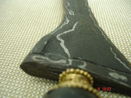

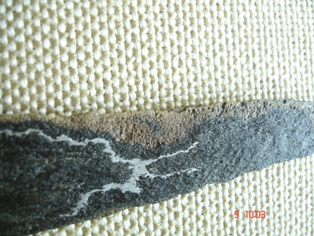

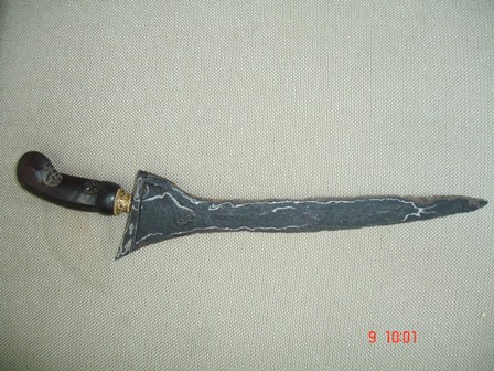

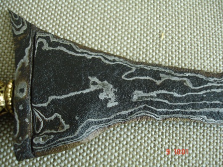

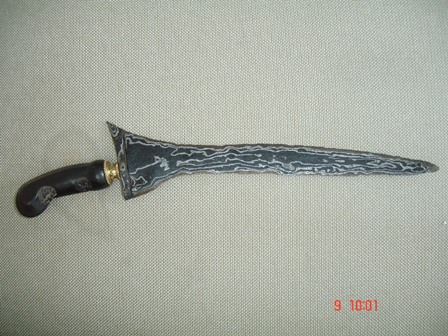

I'd like to share this pidtures with you guys.
this seem like a betok with pamor.
round healthy pesi
blade lenght : 23 cm
the pictures speak for it self.
I welcome any comment on my keris.
please....
FERRYLAKI
Jakarta
ferrylaki is offline   Reply With Quote

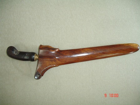

the mendak is a new made brass mendak.
nothing special with this keris.
I just wonderign about the iron...
Old 13th May 2008, 03:56 AM   #3
Posts: 7,229

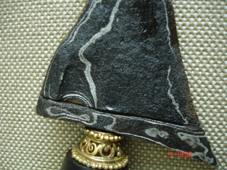

That's a nice little keris, Ferry. I don't think we can call it a betok, though. Betok are usually considered to be a bit more broad across. To me, it looks like it might have been made simply as a short keris, or maybe shortened during its life.
I would not be confident to comment of the quality of the iron just from a photograph.
Tell me, can you give us a photo of the top of the gonjo?

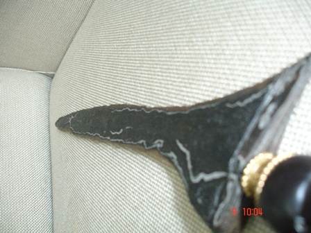

here we go...
the gonjo part.
This is the best picture I can show to you.
Old 13th May 2008, 06:52 AM   #5
Posts: 7,229
Sorry Ferry, its not really good enough.
Tell me, is the buntut urang nguceng mati ?
Old 13th May 2008, 08:39 AM   #6
ferrylaki
Posts: 285
the buntut urang is 3mm wide.

Old 13th May 2008, 02:27 PM   #9
Posts: 7,229
Yeah, it looks a bit Tubanishy, but I can't see if the sirah cecak is the right shape---looks a bit that way, but you really need to look straight down on it. A Tuban buntut urang is not quite nguceng mati, but it sure isn't nyebit rontal---its a straight,heavy, pretty ugly gonjo that looks like the tail has been cut off, which results in it looking like a shortened nguceng mati---that is, if it was longer, it would be.
However the iron looks too black for Tuban. The Pawakan will be more or less ovoid if its Tuban.
This blade seems to have some Tuban characteristics, but as always, its a bit hard to tell from a photo.
Yeah, I'd say it could have been reshaped---the pawakan is out of balance---see the way it tends to sort of lean forward, but its not really leaning forward? Proportion and balance is wrong.
But even so, its still not a real bad thing--- it all depends on whether you like it or not, and how much you paid for it. You'd be surprised at some of my favourite keris.
Old 14th May 2008, 01:19 AM   #10
ferrylaki
Posts: 285
the"pijetan" looks suspicious to me.
basicly, I do not hate reshape kerises.
but like every body else, I prefer an original piece.
I do have a doubt at this moment.
Thanks a lot for your comments...

the pijitan looks smooth and shallow.
and also the gandik looks too smooth.
