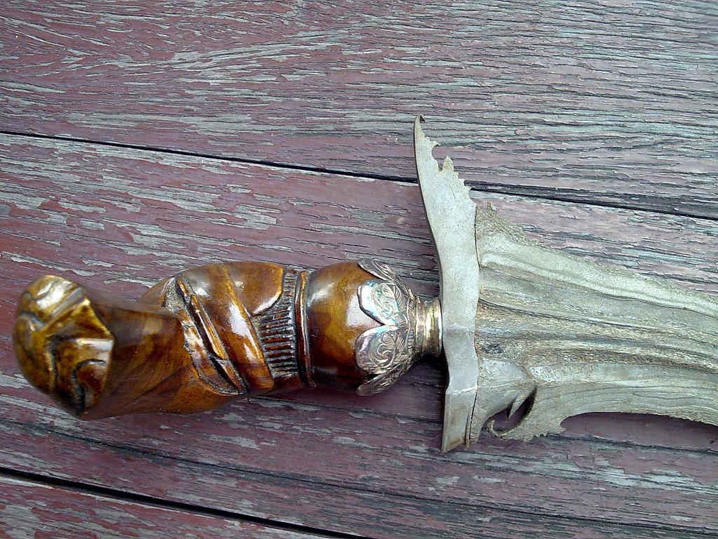

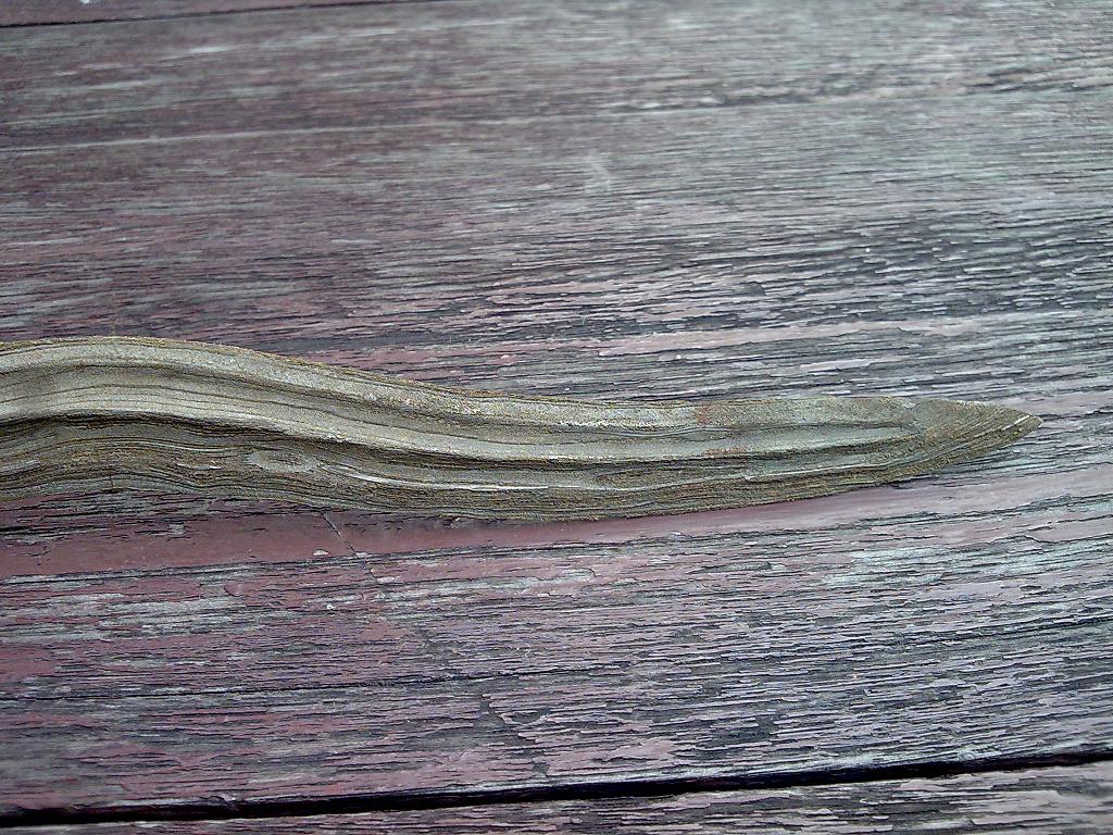

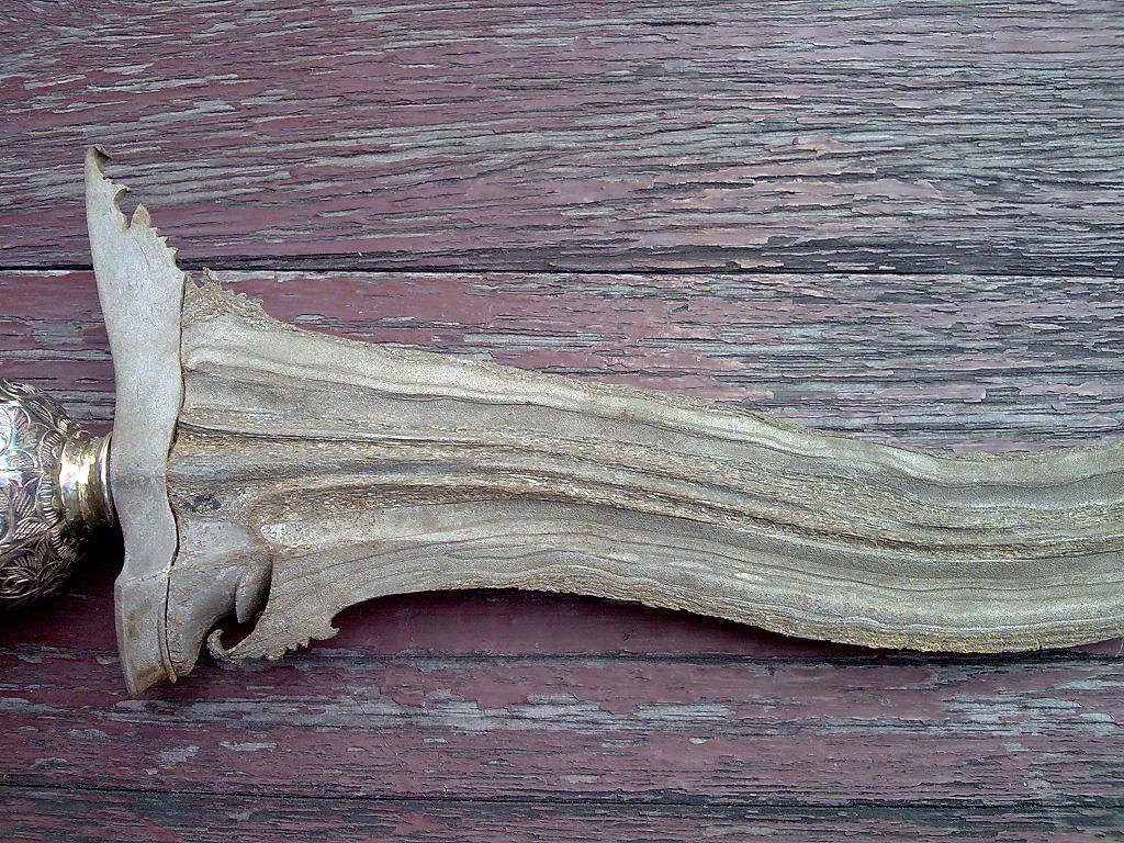

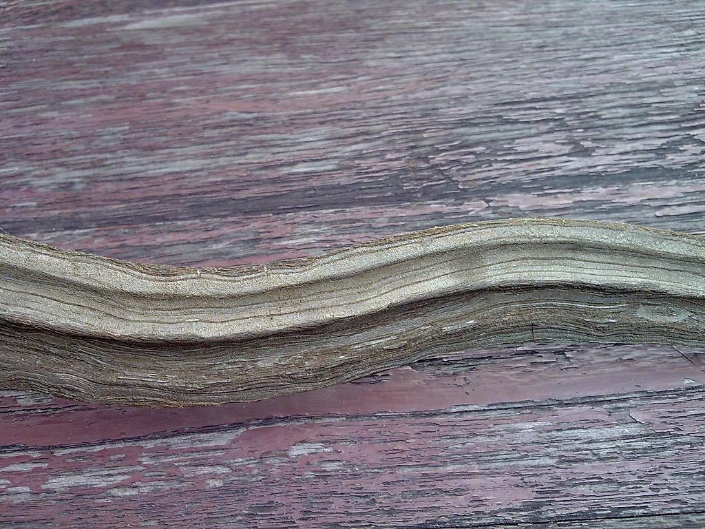

a malela luk 5 with pamor i think.. any comments??

IMO, the iron used is called "besi Malela" that originates from beach sand. I dont think the keris is pamored.
Old 16th May 2008, 04:47 PM   #3
Posts: 7,297
I agree that this probably isn't pamor that you are seeing. I think it might just be the layers of the blade revealed from years of cleanings.
Is it just the photos or does the gonjo look like different metal which isn't nearly as eroded. I wonder if it is a replacement.
Either way, a nice keris.

It is always quite difficult to comment on material from a photo. You really need to touch it, and turn the blade all around so that you can see exactly what the smith was doing when he forged it. However, based on what I can see in the photo, and assuming that an all-round inspection would not deliver any surprises, my guess is that a piece of very fibrous wrought iron has been welded with one or more other types of wrought iron to provide sufficient material to forge a blade without a core. I'd say that when the smith was finished he was probably a bit disappointed with the result, because instead of getting a blade with a nice consistent quality throughout, the fibrous iron had surfaced in a number of places, even on the edges, where it would most definitely not have been wanted.
Yes, to a present day collector this is an unusual blade and to a present day collector that probably makes it somewhat desirable, however, from the point of view of quality of fabrication, I'm afraid this blade just doesn't make it.
It is definitely not a Javanese blade.

On what do you base your assertion that this blade is forged with silver? It doesn't seem clear from the pictures. Have you handled this keris?

A single line description of the piece would be,
Keris Malela Terengganu, Luk 5, Miang Perak...
Imho, besi malela when mixed with miang perak, weakens the structure of the blade. With the architecture of the malela's fullers, the blade strength weakens. You'll still get a lightweight blade... but.
Although unique, this is not a common practice for malela blade, afaik.
For malela blades, the metal is more 'compacted', thus enhancing its strength. Newer pieces tend to be nicely sculpted but the material, less compact.
