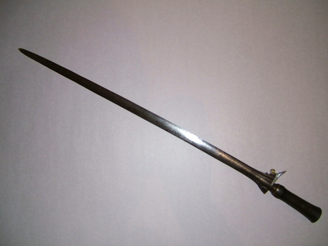

Hi All
I picked this up last week at the show. Seems to be an old one but from where? Blade is 21" long the hilt is horn.
Lew

Good Keris Panjang. But I think the hilt is not the right form.

Newsteel
This may be an older hilt form everything is very tight and seems original to the package that is why I posted it. Usually the ones I have seen in the past have an slightly curved hilts. There is a hollowed section or hole in the butt of the hilt that extends about a third of the way down and I can see the end of the pesi.

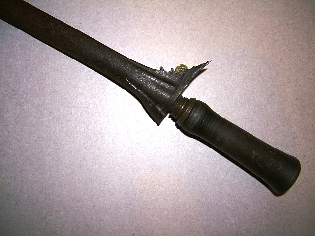

Old 25th March 2008, 05:45 PM   #5
asomotif
asomotif's Avatar
Join Date: Nov 2006
Posts: 2,238
The hilt is indeed a bit western influenced imho.
Enclosed one I recenlty bought for comparison.
Also not the most elaborate of hiltforms.

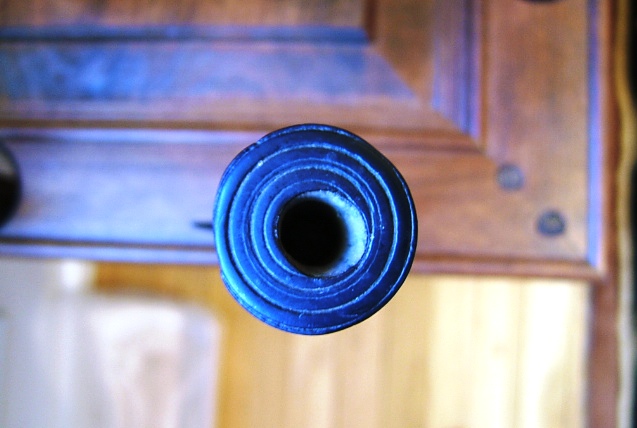

Lew
Lew's Avatar
Location: East Coast USA
Posts: 3,191
This is a pic of the butt of the hilt on my keris.
Lew
Old 30th March 2008, 02:26 AM   #10
on the first pages of Van Z's book there is a wonderful executioner keris with a handle of the same shape of Lew's keris
The one in Albert's book is carved (and slightly asymmetrical) while Lew's seems to be turned. Also, the "mendak" doesn't look Indonesian. The hole apparently going completely through the hilt doesn't help to convince me of its Indonesian origin either.

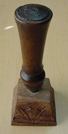

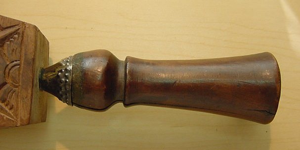

Naga Sasra
Naga Sasra's Avatar
Location: Boca Raton, Florida, USA
Posts: 108
Attached a couple of Sumatra Keris Panjang handles. They are not all that uncommen, as pointed out in an earlier post Van Z's book show an example on page 4.
The examples shown include one original handle and one that I had copied in Indonesia.
