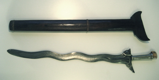

I have just finished etching this strange kris.

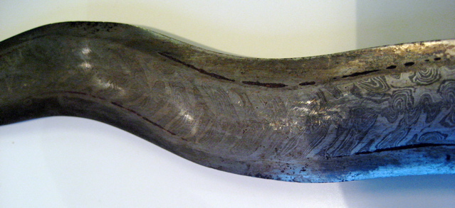

It looks very old and a nice twist core showed up along the blade.

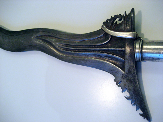

But there is not a separate ganja and its size is inbetween a Javanese and a Balinese keris.
This is the smallest Moro kris I have seen (so far).
It's 52 cm (20 1/2") in scabbard and the blade is 39,5 cm (15 1/2").
What do you think it is?

Actually, VVV, this is about right for an old pre-1800s Moro kris like this. They were smaller then and got larger as time went on. Not unusual at all, and I knew that it would have a twistcore. It probably does have a separable ganga, but it will take magnification to see it, and it may be in a straight line, making it harder to see (or just hard to see).
I wanted this piece, but did not have the funds this time. IT is one of the best examples of this type and you are fortunate to have the scabbard with it. Congratulations! (grumble, grumble, envy, envy ..... ).

Hello Michael,
Congrats, that's a beauty!
Seems like I won my bet.
Wow, are you sure? 10x magnifying lens?

Hello Michael,
The wear seems to be consistent with a really old blade.

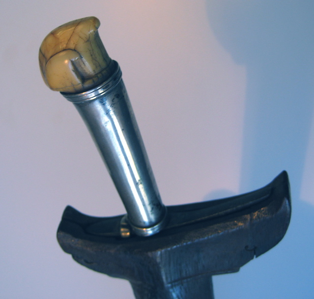

How long is the gripping length - isn't that too long for a (Moro) boy's fist?

Kai, you make some good points. I agree that this is not a boy's kris and that the hilt is too long for that.

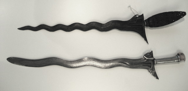

The gripping area is only 7,5 cm, slightly less than a ukiran keris (see comparison picture).
On the ganja there is none (checked with a 8x).
But I have recieved off-forum info that this, ganja iras, could be a sign
of a really archaic keris/kris.
That's not much; however, it's within the range of mature Southeast Asians - just remeasured a non-representative sample of fully grown hands with exactly this gripping length...
Thanks for the confirmation! So, some grain of the steel running into the gangya area?
But I have recieved off-forum info that this, ganja iras, could be a sign of a really archaic keris/kris.

Old 23rd January 2008, 01:12 AM   #8
Posts: 7,152
Blade length 18".
Overall length 22.75"
Length of grip section of hilt 3.25"
Scabbard damaged but original.

An 18 1/4" blade, close .
If yours is a Ganga Iras it would be the first archaic example I have ever seen .
