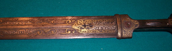

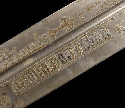

This is a large qama with a Persian maker's mark but the lettering appears Russian, perhaps Armenian. Does anyone recognize the language?

What a nice qama it is! The language is/looks Armenian (or Georgian) (not Russian for sure). Hopefully someone on the Forum will be able to translate.
Old 26th December 2007, 11:38 PM   #3
It's Armenian.
There are not very many kindjals with Armenian inscriptions: thus, it is quite rare.
The best armourers of the 19th cen. Caucasus were ethnic Armenians ( Papov, Purunsuzov, Mamikonov, Khachatur), but they all were high class and made very tasteful and luxurious swords and daggers. Necessarily, their works followed the accepted level of decoration, ie. it was Caucasian, rather than Armenian.
The "in your face" Armenian work was likely done by the second-string masters or by those who worked in isolation ( Karabagh, Persian or Turkish Armenian diasporas etc.) Their works are cruder, with overdone ornamentation, not much free space. The marks on this kindjal are not truly Persian: they, too, were made by the same Armenian master in a Persian pattern.

The first 2 pictures: I was told is Armenian as well but Inscriptions are based on a language script and not actual words. It is bigger than the other at 34 inches--a true sword.

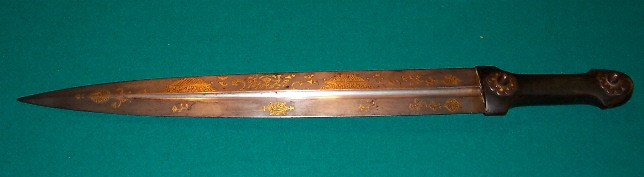

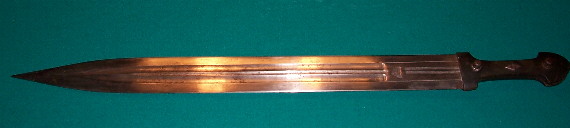

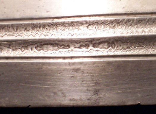

3rd and 4th picture: is a more Persian style but this one looks like real patterened steel in the fuller---some sort of sandwich construction??

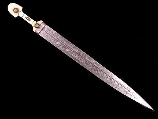

The 5th and 6th picture: I was told also Armenian--decoration is very gold colored and much finer--also looks like a date ??16 in the Georgian calender.

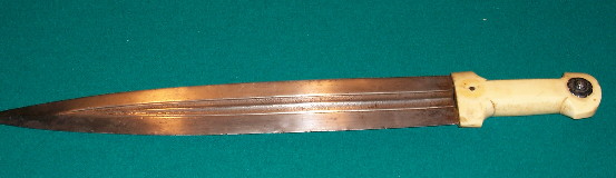

The 7th picture: is unknown---large and wide and razor sharp--false damascus etch in fullers.

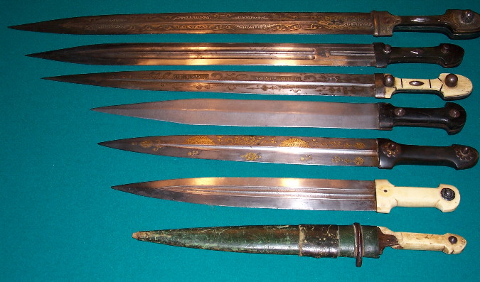

Thank you Ariel and Alex for the information. I would appreciate your comments on the other pieces I have.
Here is a pic of other qamas I have kept over the years.
They range in size from 33 inches for the top example to 17 inches for the bottom piece. I've kept all the sword size ones with wide blades I've come across.
The first piece has been identified as armenian as well but inlaid by an illiterate smith.
Second piece is very wide and very sharp with false damascus engraving in the fuller---origin??
third piece was the one that started the thread.
Fourth-a wide heavy sharp qama
Fifth has also been called Armenian--heavy gold decoration and a Georgian calender date of 16??
sixth has real patterned steel in the fullers--some sort of sandwich construction??
Seventh--smaller 12 inch blade qama.
I appreciate any knowledge shared.
Thanks
matt
