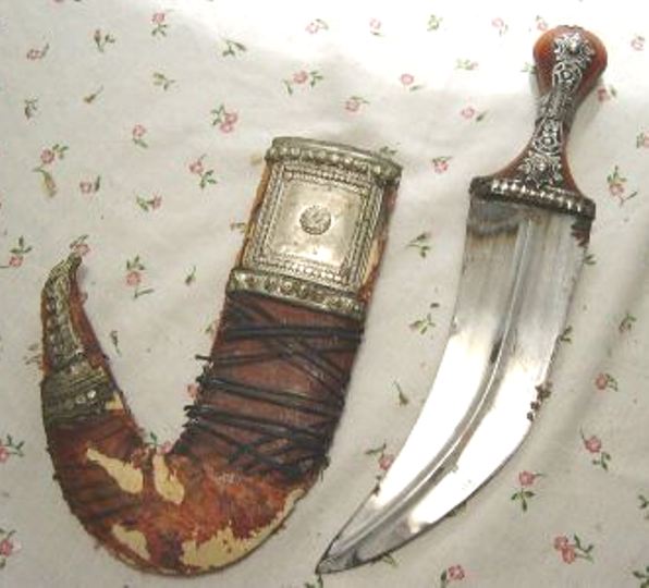

Took a risk on this Jambiya from the Yemen. needs restoration on the scabbard. The blade is described as 3mm thick (not including the central ridge) evidence of sharpening but described as 'bluntish' and is 9" long (OAL 13")

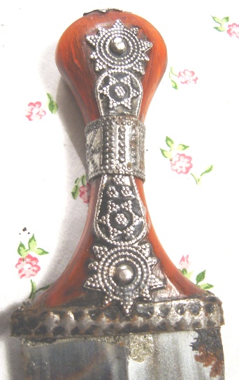

The grip seems to have some 'translucence' ....could it be Rhino horn?
The leather on the wooden cored scabbard needs repair, uncertain as to whether the hilt / scabbard decoration is silver/white metal/pewter ?
This is 'out of my area' .....but is this a reasonable example? Could this be late 19thC to early 20th C ?
I would appreciate comments or advice....thank you

(??) rhino horn would no be translucid (??)

Maybe amber?
Old 22nd October 2007, 10:16 PM   #4
Hi Robert
Amber was my first thaught too. Only i browsed for janbiyyas with such material hilt, but spelling ambar like in Portuguese. Now i see there are amber hilted janbiyyas. So it could well be.
Being the case, isn't that an added value ?

Your jambiya seems circa 1970s-80s the quality is ok for that time period. The silver work is not as nice as the the ones seen prior to 1948. Many of the skilled Yemeni silversmiths were Jewish and most of them immigrated to Israel after 1948. So you do see a decline in over all silverwork quality after that time. As far as the hilt being made of rhino horn you will need to look for those tightly packed fiber bundles at the top of the hilt. Here are two older 19th century ones for comparison the top one is rhino horn.

Also some rhino horn can be translucent.
Old 22nd October 2007, 11:18 PM   #7
Yes, with the coming of age. But maybe not so bright as David's example(?)
Old 22nd October 2007, 11:46 PM   #8
spiral
Posts: 1,712
Rhino horn can be translucent & bright in sunlight etc at any age. Depends on the individual horn. Goat,cow or buffalo horn can be translucent to on occasions.
At least it looks like a real blade as well.
The amber jambiyas dont seem to be real amber to me. More a plastic resin mix.

Hi Lew, thank you for the additional info, I agree totally that the silverwork on mine has less quality than the really nice examples you posted.
Hi Spiral, the pics do suggest that the blade is 'real' ( I do hope you are right) and it was this thought that I took the risk and bought it. I understand that a number of recent blades were made with two sheets of steel welded together (I assume that the central ridge contour is 'pressed' on each sheet and gives the illusion of a solid central spine when the two halves are joined)

The Rhino / amber is in fact resin/plastic it has a grainy, marbled effect but was confirmed by the 'hot pin' test.

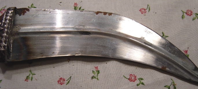

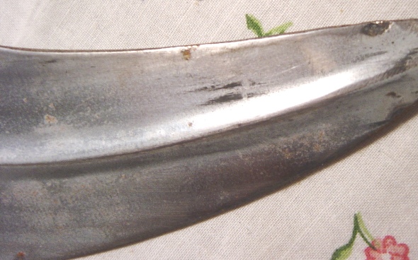

The blade.....is composed of two metal sheets The 'patination' of the blade surface really looks convincing, I think, that perhaps the steel has a quantity of re-cycled metal of differing grades which adds to the illusion.
The 'silver' banding on the hilt (just before the blade) has partially loosened and I can see printed wording on the reverse side, looks like a section of a tin can coated with some dull, silvery material on the 'facing side'.

Amber is resin, a hot pin will sink into it. Amber is affected by perfume or alcohol but do not think plastic is, well not to the same extent. By and large I feel these really are not worth going after unless you can handle them. I also speak from experience. I think in all the years collesting I have only seen three or four worth anything near the money asked.

Bakelite amber has been around since the 1800's. I have never heard of genuine amber (fossilized tree sap) in a jambiya handle anyway. A piece real amber that size would be worth a lot of money compared to the going rate for a jambiya.
Also, the majority of the blades are made with two layers of sheet metal, they are for looks, not use and this makes them lighter to wear all day. I used to watch them made in the souq. The maker would hammer out the two sides, braze the halves together and then burnish the welds.
