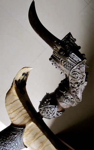

Another Tajong for your viewing pleasure. Hope this would help to release work tensions and clear up the mind. Feel free to comment. Hope some one could help to identify age of the hilt, motif and what kind of wood is it. Could it be Kenaong, Kemuning Hitam or something else. I really take note and enjoy all your comments.

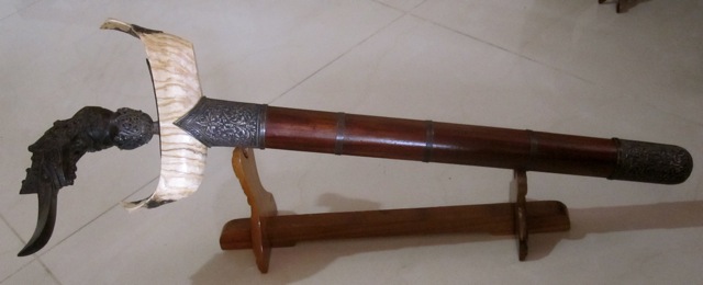

Default Additional Pics
Happy viewing

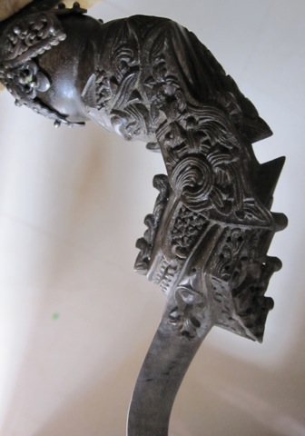

Default additional Pics
Rgrds, Mykeris.

Amazing hit with a beautiful sarong Hard wood seems to have a nice patina

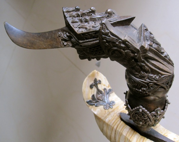

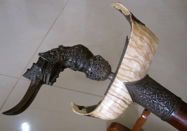

This is an interesting newer tajong Sampir made from graham is not found in the older tajong, as are the silver works on the batang and linking the daun-daun, which probably are separate pieces due to limitation of raw material. The hilt needs to have a broader head to look nicer, nose is a bit too long. The tajong spiral needs to be more centralized on the makara. For this style of hilt, the janggut should be more prominent, I feel. The carver needs to sharpen his carving knife more often while carving. Quite a number of spots where the line is not clean, prob due to the knife dulling. Overall, pleasing to the eyes though.

Another point - the carver should have spent more time polishing the hilt. It looks a bit rough like that. He definitely has potential to be much better, and I hope he does, to perpetuate the art of tajong!

Sorry for multiple posts - the batang needs to be longer. The traditional aesthetics of a tajong shd be taller and lankier, like the blade. Shd really lose the silver works... A nicely grained batang made from kayu sena would be much classier.

Interesting, points taken. But don't you think Tajong has inherited many style of carving methods and versions by different carvers? Would you agree that this is a 19th Century hand work hilt? Would you think that this hilt was carved prior to the birth of Nik Rashideen?

I agree there are many different styles of tajong, and individual carvers also add their style to it. However, I was not referring to an individual's style when discussing this hilt. I was touching on the 'archetype' style.

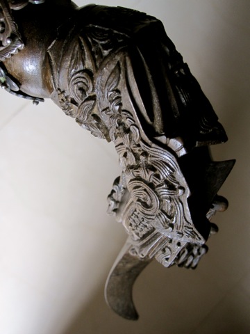

This hilt is apparently going for the "late stage" form of the tajong in which the body is big and full, head is broad, prominent crown and janggut, with body covered in vegetative motifs. And yet, this hilt is on the slim side. A good source of old tajong hilts is the Spirit of Wood. We can refer to pg 121 for a view on how the hilt evolved. Pgs 125-127 show more older hilts from various eras, which I generally agree with the age attribution, except for the one which has lost its swasa nose and eyes and being attributed to pre-18th century (I think that hilt is 19th century style, maybe earlier part, but just in bad condition).
As to why I thought this hilt was recent - the older hilts I have seen are carved with clean clear lines, and all parts are meticulously finished. There are hardly any unsure lines or rough edges, motifs are defined. In short, the carvers spent a lot of time carving and finishing the hilt. That was understandable, because a good tajong hilt could be worth a small piece of land, and were carried by people in higher society who could afford them. In recent years, there had been carvers of the tajong hilt, but they do not follow the same strict expectations of standards as the carvers of old. We see more and more tajong hilts these days like that, with carvers flouting basic rules like sharpening their knives constantly! When one is carving hard wood like kenaung or kemuning, sometimes, sharpening is required every few strokes. This was not observed, even at the so called tajong school in Southern Thailand, where students pump out substandard tajongs.
I'm not saying your tajong hilt is bad; in fact, the hilt is overall good and has the effect of impressing viewers. The carver is talented and has an understanding of the tajong form and motifs, but he could have been brilliant if he spent more time.
I'm quite frank on this subject, and you would have noted that I have posted favourable comments on some tajong you posted earlier. So, I am focused on the subject, not collectors or fellow forumnites. Hope you understand. Thank you.

I agree with Bluerf, the hilt is a later period of tajong. Also the silver mounts would be polished as well. I do like the fossil molar. Would you post pictures of the silver work?
