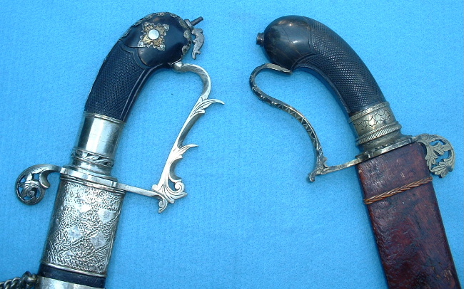

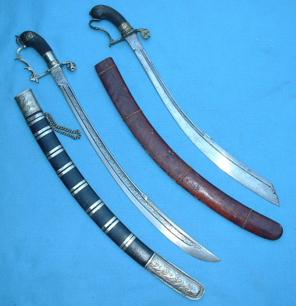

Old 13th July 2007, 03:34 PM   #8
I AGREE IT IS PROBABLY A PEDANG THE WORKMANSHIP AND THE WAY THE GAURD IS ATTACHED REMINDS ME OF PRANG NABURS. PERHAPS IT IS A PEDANG WITH SOME EUROPEAN INFLUNCE IN THE DESIGN OF THE GUARD.
UNFORTUNATELY THESE TWO NABURS PICTURED ARE NOT MINE AND I DON'T REMEMBER WHERE I GOT THE PICTURES FOR REFRENCE SO I HOPE NO ONE IS OFFENDED BY THEIR USE HERE.

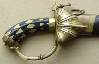

Thanks Ian. A revolution period may help explain a some what hurried look about the weapon. The very thickest part of the forte is 7mm. The handle may be horn. Here is a pic of the back. The more I handle it, think I did rather well .
I have been googling the revolution, very interesting. Happy Happy
