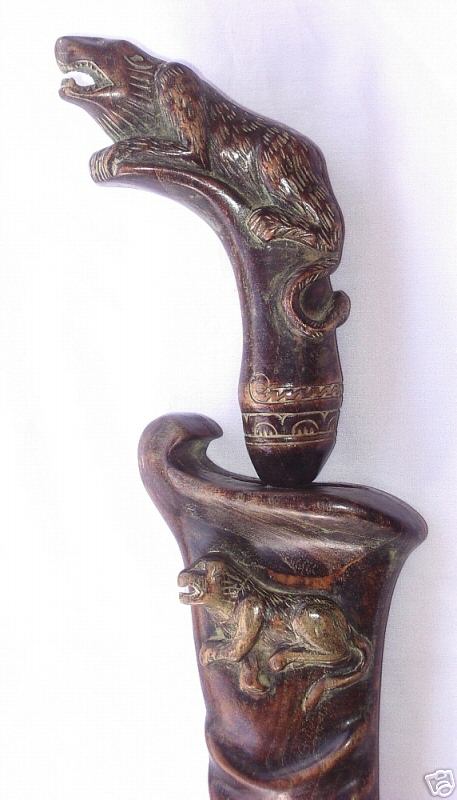

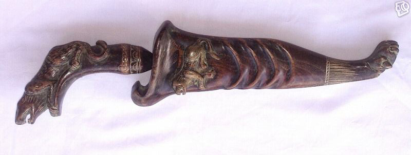

I got this kudi. The seller told :" the blade is not one of these lots of fakes..... it is antique". I like to have Your comments about the "antiquity" of the blade and on the whole item (I never saw a similar one), whose origin should be West Java (Java Barat).

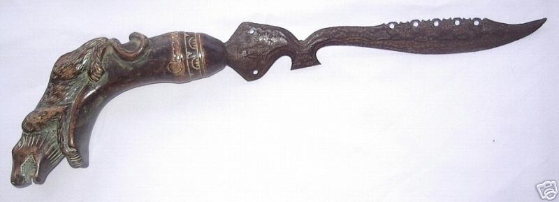

Do you think this is a recent manufacture?
Old 26th June 2007, 02:42 AM   #5
Alam Shah
Alam Shah's Avatar
Join Date: Jan 2005
Location: Singapore
Posts: 1,248
My first thoughts too. Reminds me of Valiant Co pieces... [ examples here ], [ more ].
However, the curvature of this piece is 'straighter' than the Valiant Co examples.

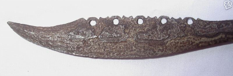

Surely my kudi looks similar to the Valiant Co, but IMO is of an higher quality. I know that with arsenic bathes is possible to have an older blade, but the pamor has a good patina, that doesn't seems dued to repeated washes. Also the wood looks old, but I guess newer than the blade.

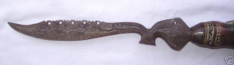

Sorry but this seems to be a nice reproduction.
The blade texture Or patine looks be etched into the blade.
The dapur is not like the old ones. (to perfect holes and outlinings)
Nice but Modern sarong.

I've posted before, these pictures of kudi and kudi-daun (leaf-kudi) in another thread. I hope it is still useful for comparison. The kudi's sheath, is 20th century Surakarta's style with "sunggingan" (wayang ornamenting).
