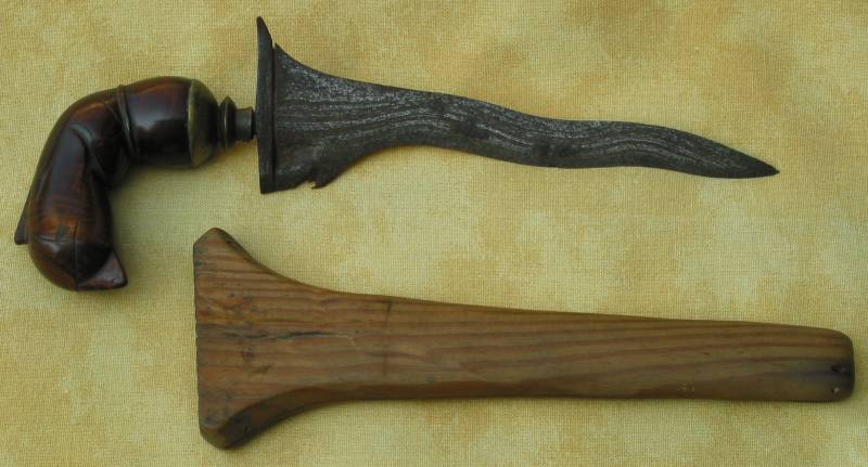

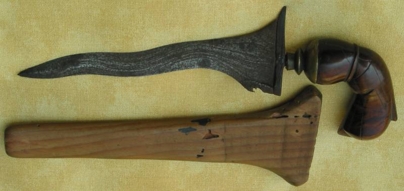

This is a really small dagger which I like a lot! I hope the other keris folks will enjoy it, too...
These are often referred to as boy's or women's keris although the nice kemuning hilt of this example is not undersized. I'd love to hear first-hand stories of their relevance in Bugis culture. BTW, is Dendiyar back from the mountains?
I'm a bit stumped regarding the scabbard which seems very "utilitarian" compared to other Bugis pieces. It's made from very light wood - maybe pine?!? Assuming that one day I may want to upgrade the scabbard (and pendoko) what would be the most appropriate style for this blade? Pics of actual examples (possibly for blades of this small size) would be greatly appreciated!
There are a few rust spots which I'm going to tackle by electrolytic rust removal. The dry wood of the scabbard could use some boiled linseed oil, I guess. Any veto or suggestions what else to fix/exchange while I'm at it? General comments very welcome, too!
This sele also came with a story: The former owner was invited to eat at the home of a chess acquaintance in Ujung Pandang. There he chanced over a small keris collection. Bold as longnoses sometimes are, he asked wether the host might be interested to part from a keris or two but was going to be turned down by him. However, his wife happened to vote for the money - the ultimate nightmare of married collectors (some of us can relate to that)... [I like the thought that the poor husband had his wits about him and sold off a blade from his wife's lineage! ]
(blade pics: hilt turned for photography...)

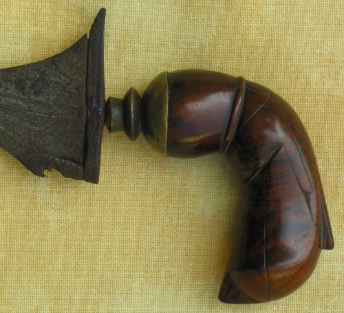

Old 1st September 2005, 10:17 PM   #2
Smile close-ups
(left side)

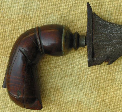

Old 1st September 2005, 10:19 PM   #3
Smile more close-ups
(right side)

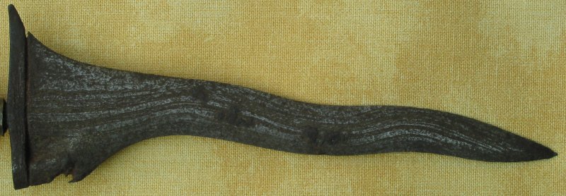

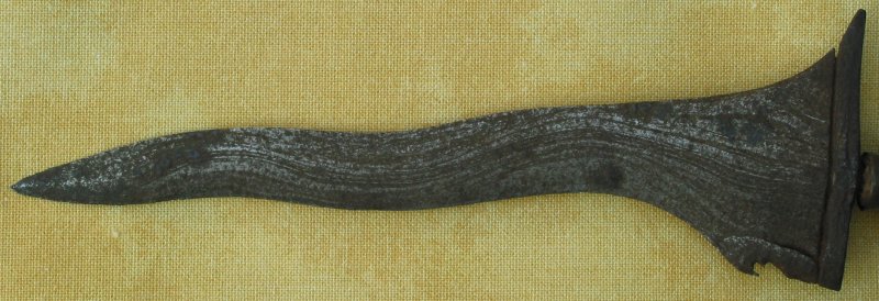

Hi Kai,
The blade looks like a javanese patrem with it's thin and longer ganja.
It looks as though it was reshaped from a longer piece. The pamor lines
does not flow with the luks.
(I have a javanese patrem, of a different form. See here).
The blade and the sandang walikat sheath form looks complementary to each other.
In your assembly, the hilt and pendokok (hilt cup) looks a little 'out of place'.
Without the longer 'neck' of the pendokok, the hilt would probably would not
fit the entire length of the peksi. The hulu and pendokok is of the Sulawesi (Celebes) form.
I have a short Sulawesi keris with a mini tebeng-styled sheath. See it here.
(The sheath is complementary to the form. But don't follow my pendokok . Wrong styled. Mine is a peninsular styled pendokok.)
Nevertheless, should you decide to change the sheath, I would recommend a tebeng-styled sheath or another Sulawesi form (see here).
Feel free to disagree.

Kai, Alam Shah is right. The blade is a javanese one. Javanese blades were highly apreciated so it is no surprise that you see javanese blades mounted as a buginese keris.
But i don't think yours is a bugis. The walikat sandang sheath is more javanese and the uikiran is too large for this blade. I guess that the previous owner replaced it. Maybe you can find a small ukiran for a patrem to complete its javanese origin.

A Jogya styled sheath, hulu and mendak would look nice and elegant for your piece. Just a suggestion. (See my example).

The blade looks like a javanese patrem with it's thin and longer ganja. It looks as though it was reshaped from a longer piece. The pamor lines does not flow with the luks.
Thanks, mas Alam! I've been wondering about the pamor flow, too. However, if the shortening would have been done in Jawa, why were the original shape modified, especially since this can't be hidden with a pamor miring blade?
In your assembly, the hilt and pendokok (hilt cup) looks a little 'out of place'. Without the longer 'neck' of the pendokok, the hilt would probably would not fit the entire length of the peksi.
Yup, the peksi is 53 mm (2.1") long. The blade is only 175 mm (6.9")!

What I meant though: Why would one want to narrow down the original luks and thereby messing with the pamor miring instead of just shortening the blade?
