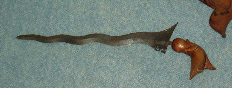

This is the first Keris in my collection (one kris though ). I may have paid a bit too much but I just really loved the aesthetics/form of the handle and blade and was very happy to find one like this. The keris is smaller than I expected (31cm ~ 12.5"overall), but that's ok. The piece needs a little TLC though (cleaning, scabbard restoration, and a mendak?). I don't know what the origin is (I'm still learning a lot); my best guess is that it's (mid?) 20th century Malaysian, but I would appreciate any input on region, age, etc.

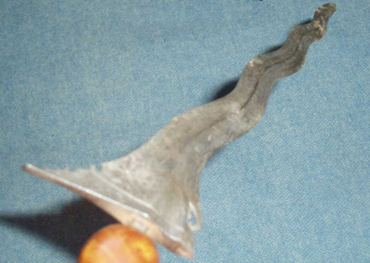

First: How would the blade surface be traditionally finished based on it's origin: a simple etch with citrus or a full "stain" with an arsenic compound? How widespread was the practice of treating blades with arsenic? The photos don't pick it up really well, but the blade seems to be well laminated.

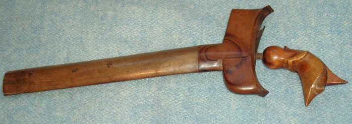

Second: I need to put an end cap on the scabbard, but traditionally would the end cap match the wood at the top or was it solely at the artist's discretion. I am thinking of using tagua nut (fake ivory) for the cap. I have seen this on some scabbards (not necessarily keris) using ivory and really like it.

Congratulation for your first keris. Yes !!! Beautiful indeed.
I think that is a Pattani keris typically originated from northern Malaysia (kelantan or Terengganu) or possibly southern Thailand. The dapur is Pandai Saras Luk 7.
Using some citrus acid from lime would do good to restore the blade (etch). Not much of rust observed there. No need for warangan (arsenic). I would not bother to make the end cap (or buntut) with fake ivory. If you can't find ivory, a good hardwood would also do good.
By the way the mendak is missing there. I leave the others to comment further. Overall, it is a nice piece.

Congrats on your 1st keris. A rather nice piece.
I tend to agree with Newsteel's opinion, the profile is Northern Peninsular Malaysia or Southern Thailand, but in this case, most likely Pattani.

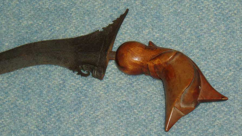

The hilt is in the Northern Pekaka/Perkaka form, with a high balung (back of the hilt) and protuding beak-like feature.
The sheath is nice, I especially like the pattern at the centre of the cross-piece.
As mentioned, the pendokok/pendongkok (hilt cup) is missing. A silver pendokok would complement the piece. Here are some examples, click [here], and [here] for an openwork-style.
As for the blade treatment, I suggest adopting Newsteel's suggestion.
The lamination lines should appear more prominent afterwards.
As for the end-piece, I stand by Newsteel's opinion.

I agree with the others about the buntut; Tagua or Ivory might be a bit over the top; stick with wood.
I might have a piece of dark Apple wood (about the shade of the wrongko) you can have gratis; it carves beautifully.

To add, having this good profile blade and that high balung pekaka hilt is a bonus. You may also want to buffer polish the scabbard and the stem (sampir and batang) to make it even better.
