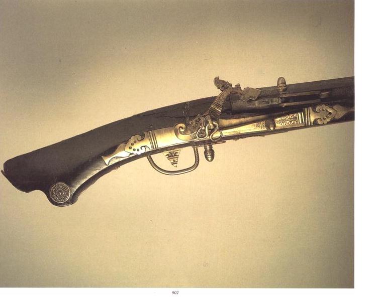

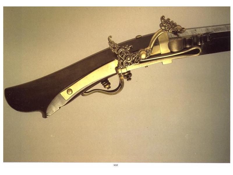

I thaught this is a theme that, besides Philip Tom, might be of interest to other members.
Given that these weapons examples are rarely pictured, i am showing here two of them, scanned from a thematic auction catalogue printed in 1989, on Portuguese discoveries and naval expansion stuff.
Both pieces were produced in Ceylon. The first one was made still in the XVI century. Its total length is 1,70 mts. The barrel, unfortunately not shown in the picture, is from an original Portuguese musket. This is considered a very rare and important specimen; it was exhibited in various places, including the 17th. European Council exhibition, and was pictured for a well known edition of Portugal History.
The second one, a long piece with 1,95 mts. was produced by XVII-XVIII century, after the Portuguese period in Ceylon, but follows entirely the model introduced in the Island by the the son of the first Portuguese Vice-Roy in India, in 1505. It has a decoration of high quality, with details similar to those in pia-faetas. Also considered a very rare piece. The text quotes that Colombo had at the time specialized in matchlocks, exporting them to the other Islands. Part of these arms, however, would not be for active use, but to be exposed in the Temples, as offers to the Divinities.

Thanks for posting these mouth-watering pics! I agree that the bottom specimen (the 1.95 meter one) has all the hallmarks of Ceylonese workmanship, and what a fine and rare example it is!
However, the one in the upper photo is, I believe, to be Malayan as opposed to Ceylonese in origin. I compared them against two published examples, both identified as from Malaya:
A. cat. no. 129, FIREARMS OF THE ISLAMIC WORLD IN THE TAREQ RAJAB MUSEUM, KUWAIT by Robert Elgood
B. Figs. 701-72 in GUNS AND RIFLES OF THE WORLD by Howard Blackmore
Mechanically, these two are identical to the one in the image which you provided. Note the long, straight, slender lockplate with the ornate decorations at each end, and the serpentine which terminates in a stylized zoomorphic head. The flattened triangular triggers, heavy trigger guards with a large ornamented bolt-head protruding from the anterior end, and the rather flattened priming-pans attached to the barrels are also common to all these pieces.
The example in Elgood has the lobed buttstock that is seen in your image (by the way, it is related to a similar profile seen on some styles of Japanese buttstocks as well). The specimen in Blackmore has a squared-off butt which is very similar to that on the matchlocks of neighboring Vietnam. The squared cross-section of the forestock ahead of the trigger, which transitions to half-round for the remainder of its length, is another feature that is carried over into the Vietnamese guns as well.
I would be most interested in seeing a detail of the muzzle of the Portuguese barrel on the top specimen, the one that I think is Malay. If it is of the 16th cent., one would expect to see the sizeable thickened mouldings at the mouth, as shown in the example (the replica made as a commemorative gift to the Japanese government) in Daehnhardt's ESPINGARDA FEITICEIRA. Of all the eastern nations which adopted the Indo-Lusitanian matchlock, Japan is the only one in which these oversized mouldings remained popular long after they disappeared in Europe.
In contrast, the three examples of Malay muskets which I have handled in recent years have plain muzzles (no expansion whatsoever), the two Vietnamese specimens in my collection have only a modest thickening or beading around the mouth, and the typical Chinese hunting gun or fowling piece has a slight conical muzzle reinforce similar to that seen on many Indian barrels.

Also in his work Espingarda Feiticeira ( Bewitched Gun ) of which Philip has a copy, he mentions in page 103-104, under what he calls Cingalese-Malayan locks section, the same example figured in the discussed catalogue, as being of Luso-Cingalese production. He also mentions that this pattern was originally produced in Ceylon, after being spread by the Cingalese smiths to Malaca and Java, reaching all Malasia, including Molucas and Philipines. He further mentions that Ceylon and Java wwere the main centers of such production. BTW, also the second picture i have posted is mentioned in same pages of Dahehnardts work. The specimen shown in Elgood's book as being Malayan is dated 1700. This doesn't avoid that this model was first produced in Ceylon, in the 16th century, and after reproduced in Malasia. Elgood also mentions in the same page that a firmly based Portuguese model was presented in an exhibition held in Lisbon in 1983. It happens that one of the events in which the specimen shown in the discussed catalogue appeared, the 17th European Council exhibition, was precisely in 1983. Also the quoted footnote "4" mentions, apart from "Barreto and others", the initials RD, which could well mean Rainer Dahehnardt, a name that appears in the final credits of his work.
And finally, Elgood's specimen appears with a locally made barrel, certainly of that period, whereas in the example shown in the catalogue, the piece shown is equipped with a Portuguese barrel which, still according to Dahehnardts in Espingarda Feiticeira, could have being made in Goa, in the famous Casa das Dez Mil Espingardas. This would have certainly been a much earlier specimen. Eventually such barrel does not appear in the picture, so i can not post it.

Thanks, Fernando, for your comments and the added details. My study of these guns has been somewhat limited by unfamiliarity with the material in Portuguese collections. What I have been able to look at in detail has typically been in US and British collections and dealers' inventories, and this material has typically been presented as Malay, Javanese, or Indonesian. Although I am fairly familiar with the Ceylonese guns with Portuguese-style flint mechanisms, my exposure to matchlocks from this area has been almost nil. This is perhaps reflected in my hasty conclusion that the gun in question had to be Malay, without giving due consideration to Ceylonese antecedents.
