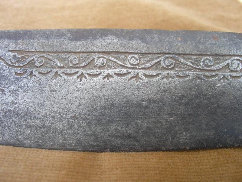

This flyssa ended on ebay: http://cgi.ebay.ca/ws/eBayISAPI.dll?...MEWA%3AIT&rd=1

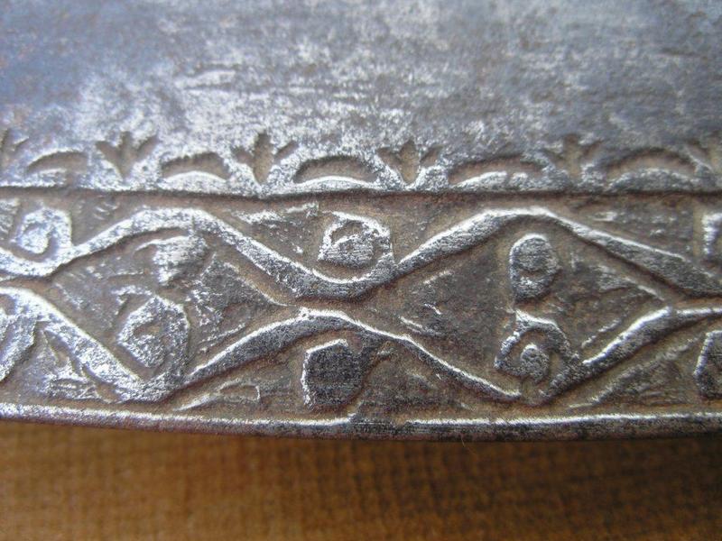

It seems basic enough, lacking the usual brass ornamentations. This is also what makes it interesting, it has intricate carving on the blade...quite deep and different from the brass inlay. Its heavy look renders it older to my eyes than the beautiful decorated examples. Could this be an earlier example than the 1820s - early 19th century - or just one made by tribes not as skilled as the Ifflissen?
Any thoughts on this?
Emanuel

Actually it is a yatagan. This form of blade is unusual but known, as is the integral bolster. As to dating, much more difficult to say. Yatagans remained in use in parts of the Ottoman Empire into the 20th century though this probably dates in the first half of the 19th. Eastern Anatolia judging from the decoration, grips look to have been replaced at some point. Nice example.

Thanks for the clarification. How interesting that this yataghan looks so much like a flyssa...for one thing the almost fully straight spine strongly recalls the flyssa...I've got to study these in more depth.

Looks like Flyssa to me. The blade is heavier than most, but the configuration ( widening blade with sharp point) is typically Flyssa-like. I am unaware of Yataghans with such sharp point. The incisions look quite deep, but this may be an illusion of a close pic, and the motives look N. African to me. Are you basing your conclusion on the pommel? It does look eared, but the handle is a replacement, as you noticed.

So this particul example would be a virtual "prototype" for the flyssa? It's nearly identical to the classic flyssa form...in that case, the whole weapon style would be attributed to Anatolia, not Algeria, would it not?
Are there more confirmed examples of this?
I still think it's a flyssa...and I'm still intrigued by the carving. And the grips are similar to those on this example http://www.vikingsword.com/vb/showth...ghlight=flyssa Replaced or original, they're still reminiscent of the brass camel head on finer flyssa like the one from Oriental-Arms.

Probably the earliest known examples of the Kabyle sword known as the 'flyssa' (for the Berber tribe associated with producing them, the Iflissen), are from c.1820's. The familiar examples often found today typically are of the form seen from c.1850's and usually have the brass stylized zoomorphic hilt and the blade inlaid with the characteristic geometric forms. The scroll type motif on this blade is notably atypical of Berber design, as has been noted.
